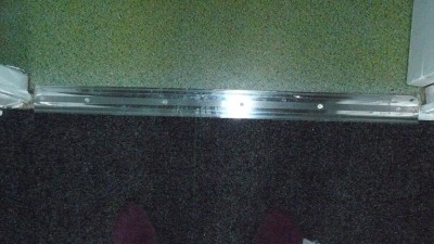

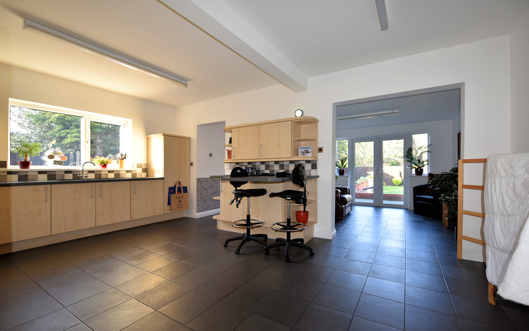

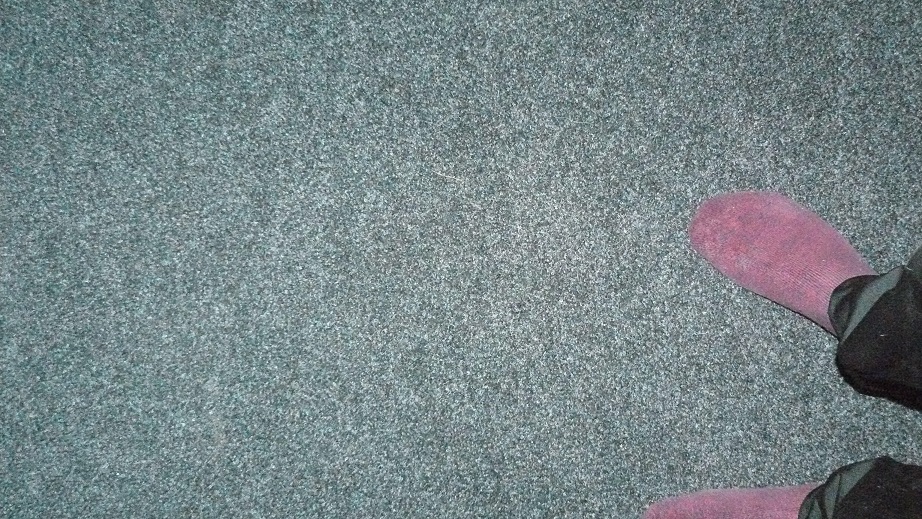

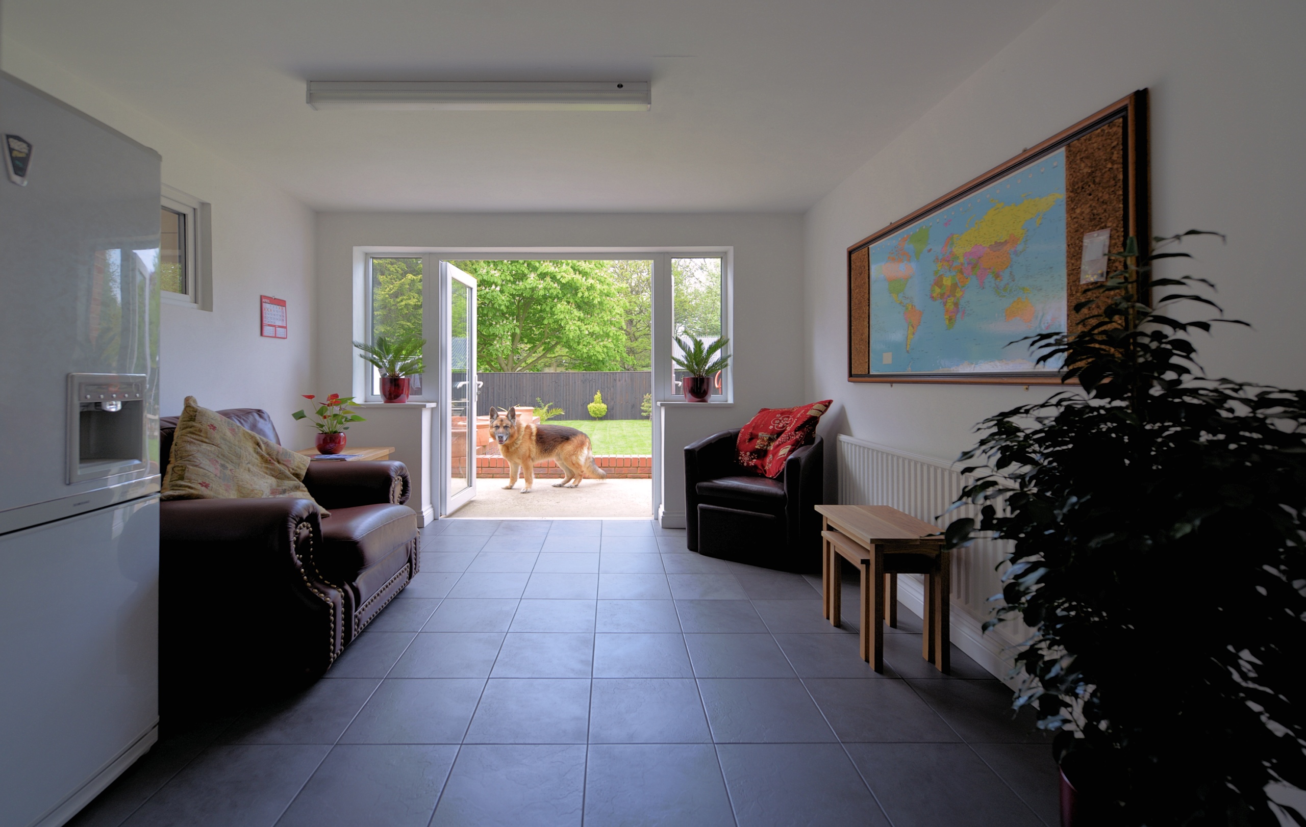

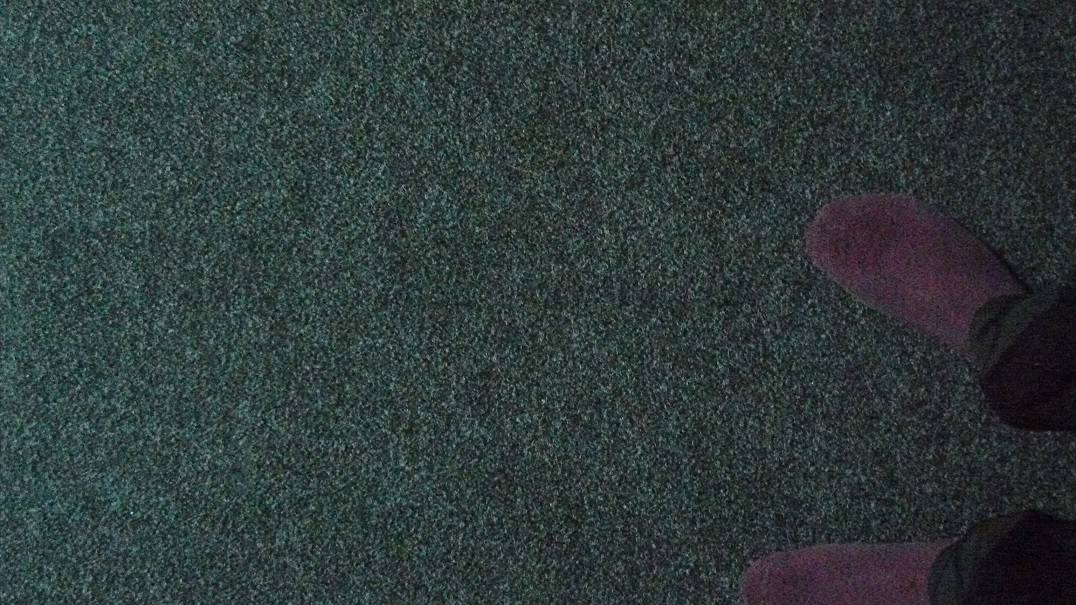

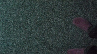

I do 2 things.
Half my ground floor is ceramic floor tiles, and these are on to concrete. Been down 20 years. Look exactly the same today as when installed.
The other half was industrial carpet tiles in dark grey. Almost impossible to damage. When one gets paint/shit/oil/whatever on that cannot be cleaned off, I just swap out a handful as required. All are exacty the same in every room inc my bedroom, hallway, living room, etc. So only need keep one type of spare! I have 6 boxes of extra tiles. These look just as good as when first put in around 6 years ago.
Uncleaned for 4 or 5 weeks.
https://www.wheelchairdriver.com/images ... 0_0159.JPG
They look like new again after a quick clean and polish a decade and a half on.
https://www.wheelchairdriver.com/images ... ting-1.jpg

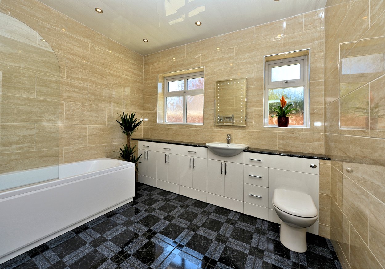

Ceramic tiles on concrete floor. bathroom. Also a decade old.
https://www.wheelchairdriver.com/images-house/1%20(24).jpg

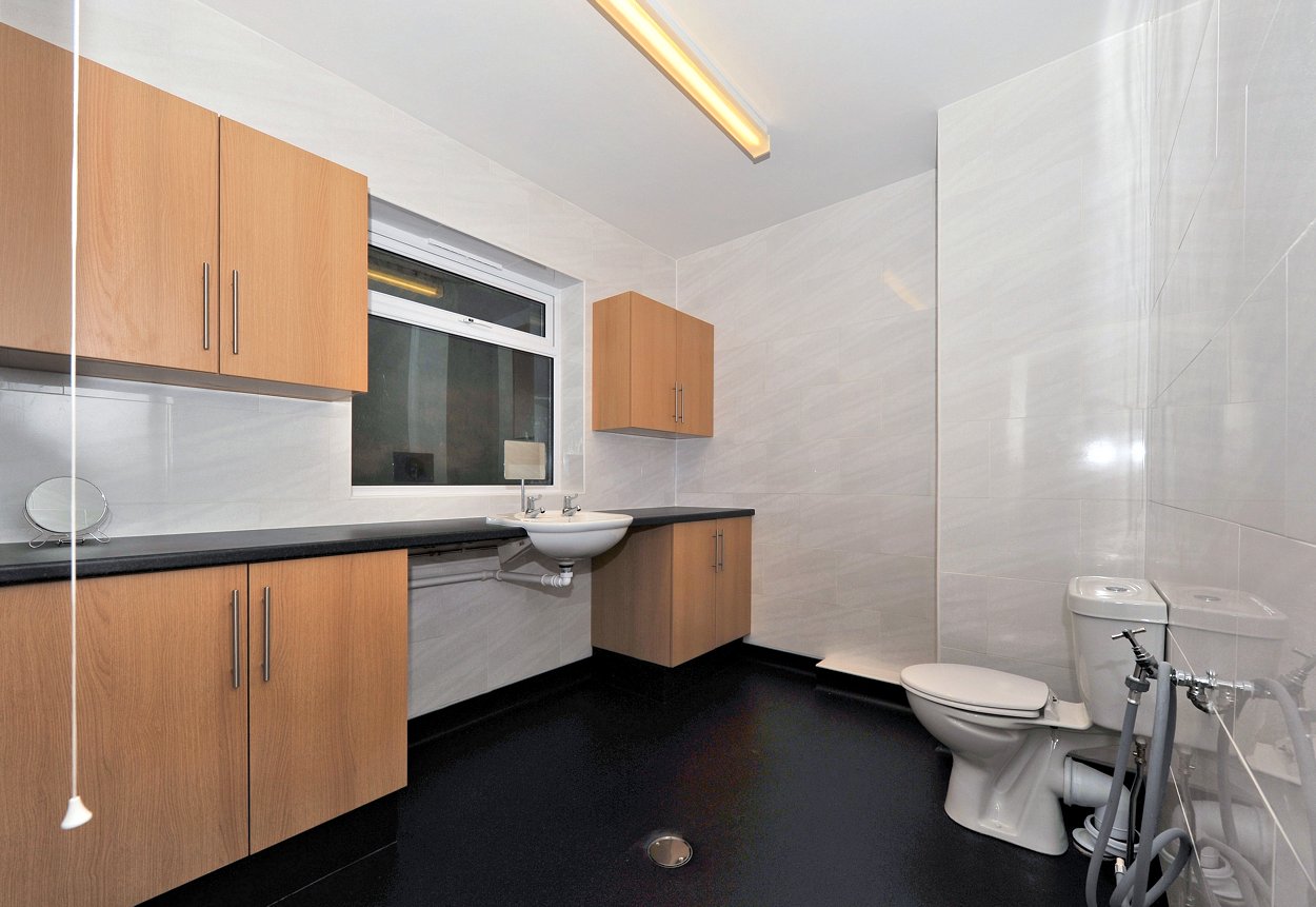

Wet room floor. Welded vynl and doesent wear as far as I can tell. Gets dirty, car "back to black" sorts that in 15 mis like new.

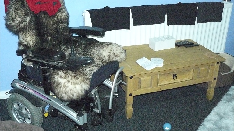

Bedroom-workshop carpet tiles.
https://www.wheelchairdriver.com/images ... 0_2462.JPG

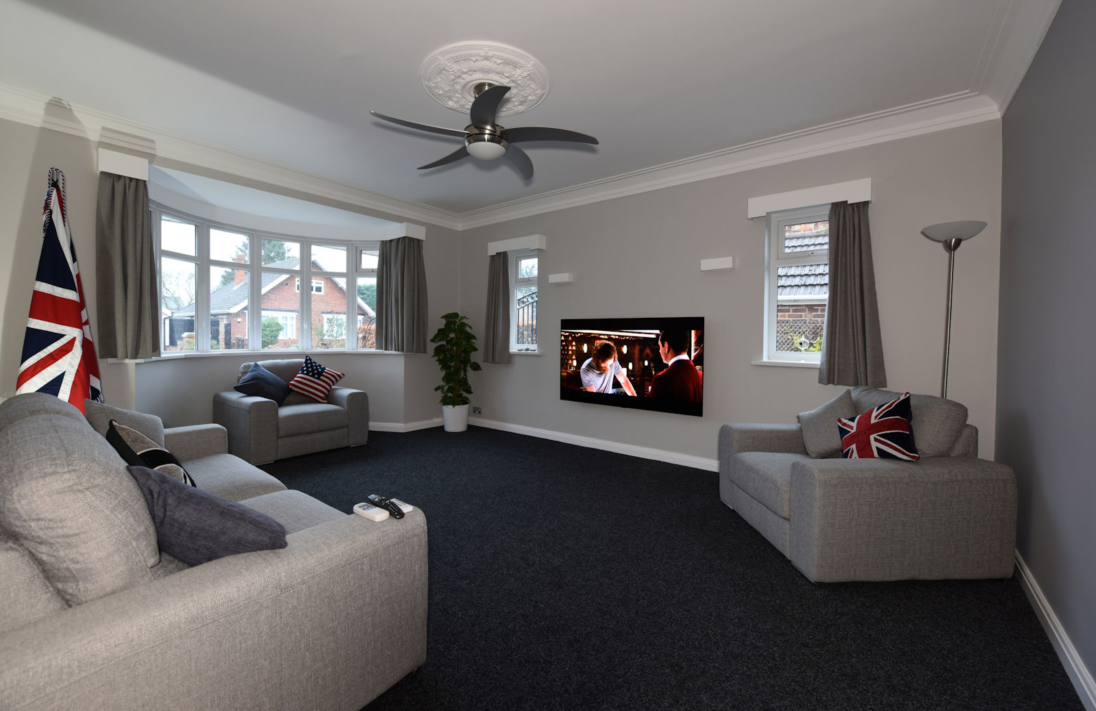

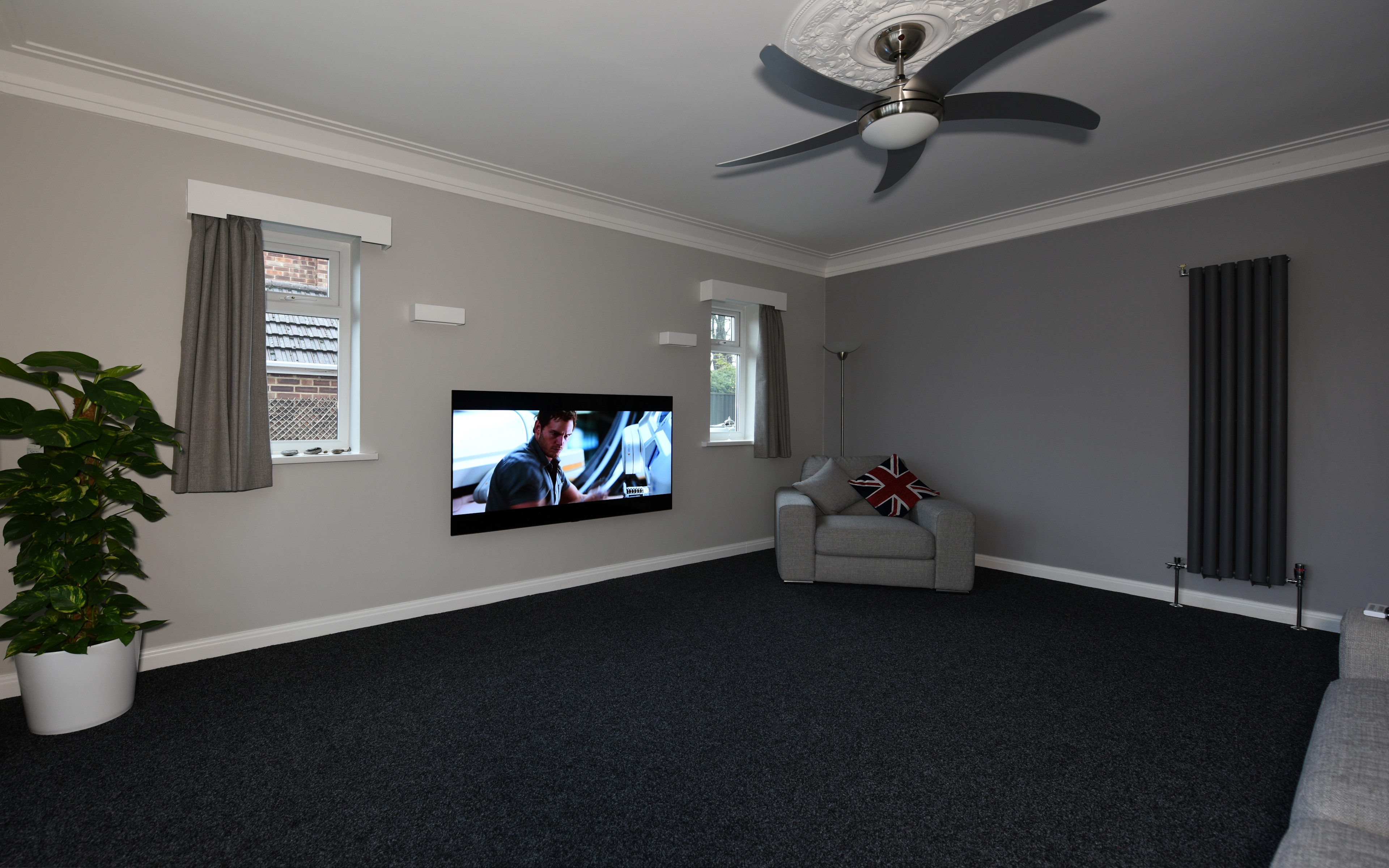

Same carpet tiles living room. Aso in hallway. All through house in one go.
https://www.wheelchairdriver.com/images ... 600JPG.jpg
https://www.wheelchairdriver.com/images ... 0_2469.JPG
These are the sort of carpet tiles used on shop dooways, airports etc. They cost more. They are very tough.

Non of those show any sign of use after many many years. If you look after them.
