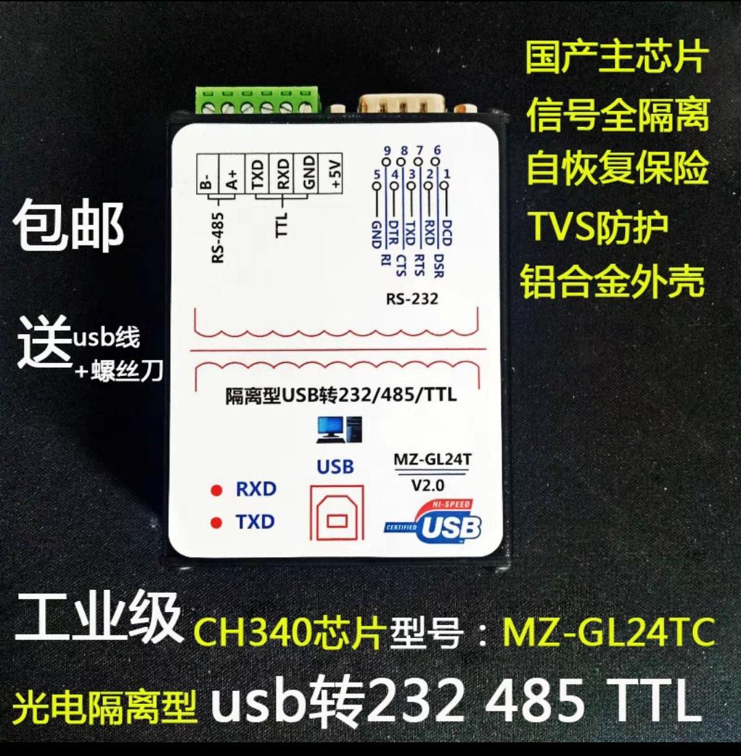

Postby shirley_hkg » 27 May 2023, 12:04
woodygb, do you mind telling me is this interlink suitable , and what is the wiring method .
I have a corrupted PL8 to try it out . Nothing to lose.
Postby shirley_hkg » 27 May 2023, 13:50
The 5V is taken from usb , rated 100mA for external load.
Postby woodygb » 27 May 2023, 16:03
Try joining RX and TX of the MZ-RS24T = White of existing PL8 plug
GND of MZ-RS24T = Black of existing PL8 plug
DO NOT CONNECT RED of PL8 OR 5V of the MZ-RS24T:
Postby woodygb » 27 May 2023, 16:16
Another possibility with the addition of a schottky diode.
