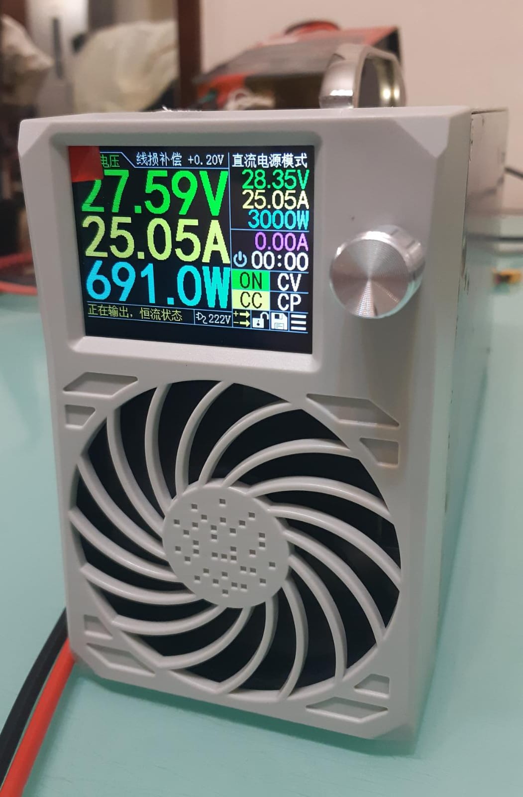

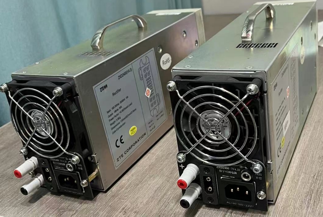

Stock case model has XT-90 connector now, not only an alternative to Anderson SB50 but also slimmer and lighter.
@$1,200 HKD
10 days shipping hkd $360

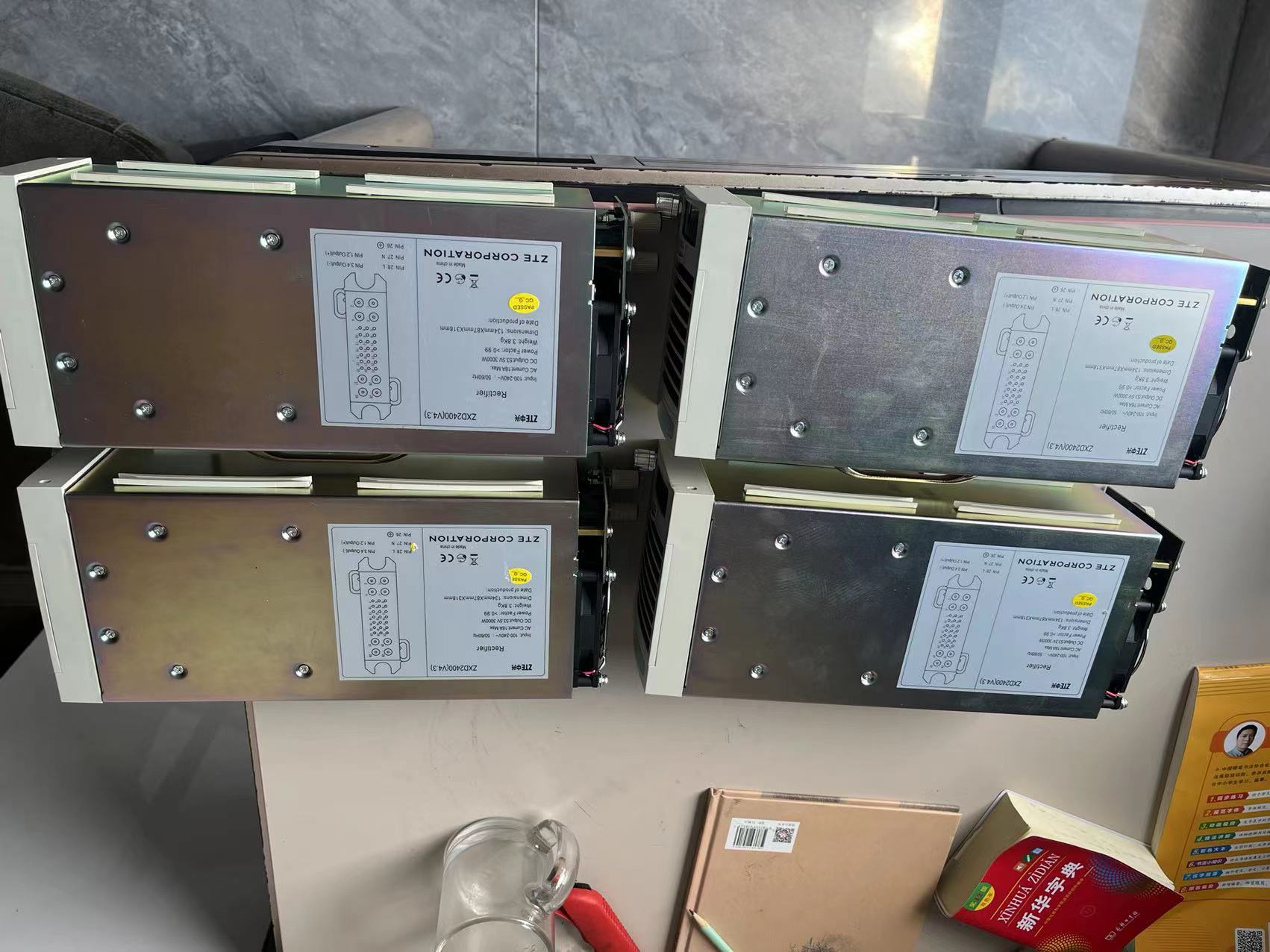

Spent quite some effort to find 4 brand new ZXD to feed members' appetite.
Now undergoing metamorphosis into 0-60V/0-50A adjustable.

The new generation with colour display is much quieter, but it don't have English menu till 2024.

No. These 4 are old version , the same as your's.
It has XT90, instead of Andersen SB50, and no fency aluminum outfit so it is more compact and 1.8 kg lighter.
New breed has large LCD display. Don't mix up.
