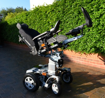

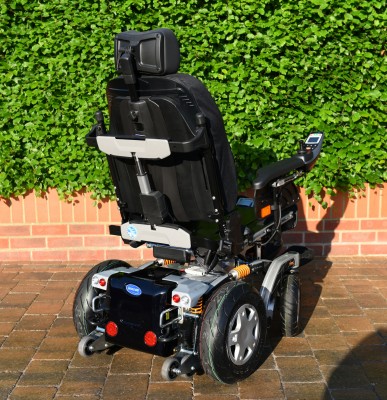

Postby Burgerman » 09 Oct 2023, 08:32
Theres also this. I think this has the best ride of any owerchair I ever had.
£5700 new. Also lift, tilt, recline, power centre footplate, and so on.
This is invacare. Its another rear drive you guys never saw in the US unfortunately. The Invacare true track Xplore.

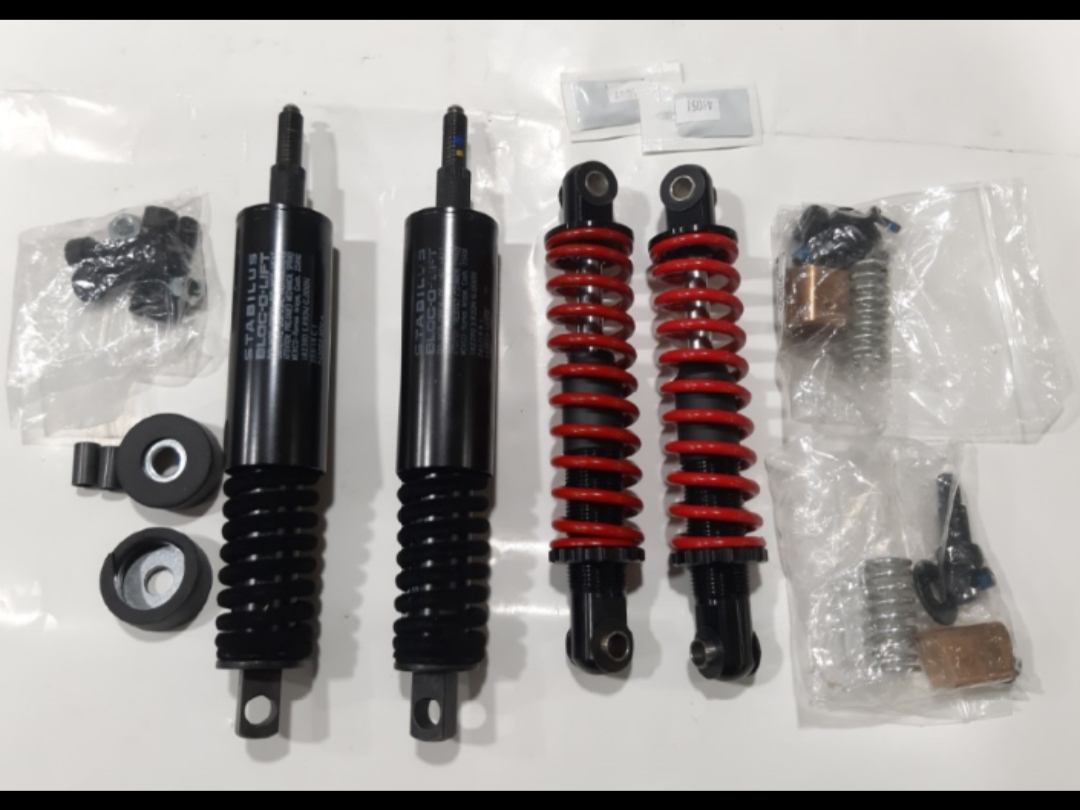

Postby Raro » 18 Feb 2024, 17:44
Hello, I stopped by just to give my experience, they gave me a Jive m chair from 2016, this chair came with the rear shock absorbers burst, causing the chair to rise on slopes like a horse, these first versions did not have shock absorbers in the front arms or springs in the rears. As you say, there have been update campaigns. I used one of them and the truth is that the chair now behaves perfectly. What I don't know how to tell you is the durability. The set cost me €250.
This note explains and there are videos for the installation of the kit.
https://www.sunrisemedical.co.uk/suppor ... e-m-update

Postby Raro » 18 Feb 2024, 18:18
An image of the kit I installed
