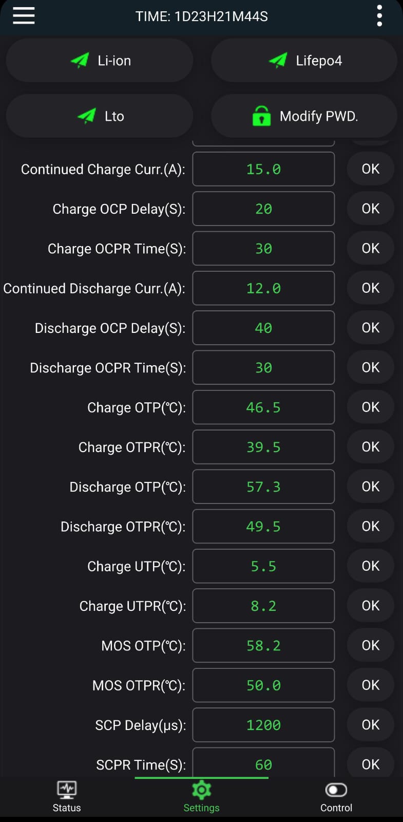

BTW , below is the basic settings of a JK bms.
Postby Burgerman » 05 May 2024, 12:04
BMS work OK on lithium ion cells. Unlike LiFePO4. As long as they dont fail and cause a firework explosion...
Voltages.
If you want maximum capacity then the usual 4.200V full. (up to 4.3v on some HV high capacity ones - read specs)
And 3.4 to 3.5V low end. GENERALLY.
On SOME high capacity types this can be as low as 2.7 volts, see spec sheet. Be sure you get this part right or you waste a lot of capacity and run the risk of killing your cells if its wrong in the opposite direction. They all vary by type of lithium ion. And cell manufacturer. Theres now many slightly different chemistries used. So no hard and fast accurate rule of thumb possible.
They live much longer (many times longer) if you only use say 70% of rated capacity. I generally charge to 4.100V per cell on hobby stuff like transmitters. And run them down to 3.7V if I have to. On flight stuff, where apacity matters I charge to 4.200v and discharge to around 3.4V if needed in an emergency. To get back on the ground gently.
Its all a compromise. If you use less capacity they last a lot longer. If you charge and discharge at a low rate they loe a lot longer. If you keep cool they live a lot longer. If you store below 85% charged by capacity as I do on my laptops then instead of getting a year and a half they last a decade or more.
Tesla charge to 85% in normal use. And read "empty" at 85% discharged. And that way their lithium ion last the life of the car with around 20% loss of capacity at a decade of normal use.
