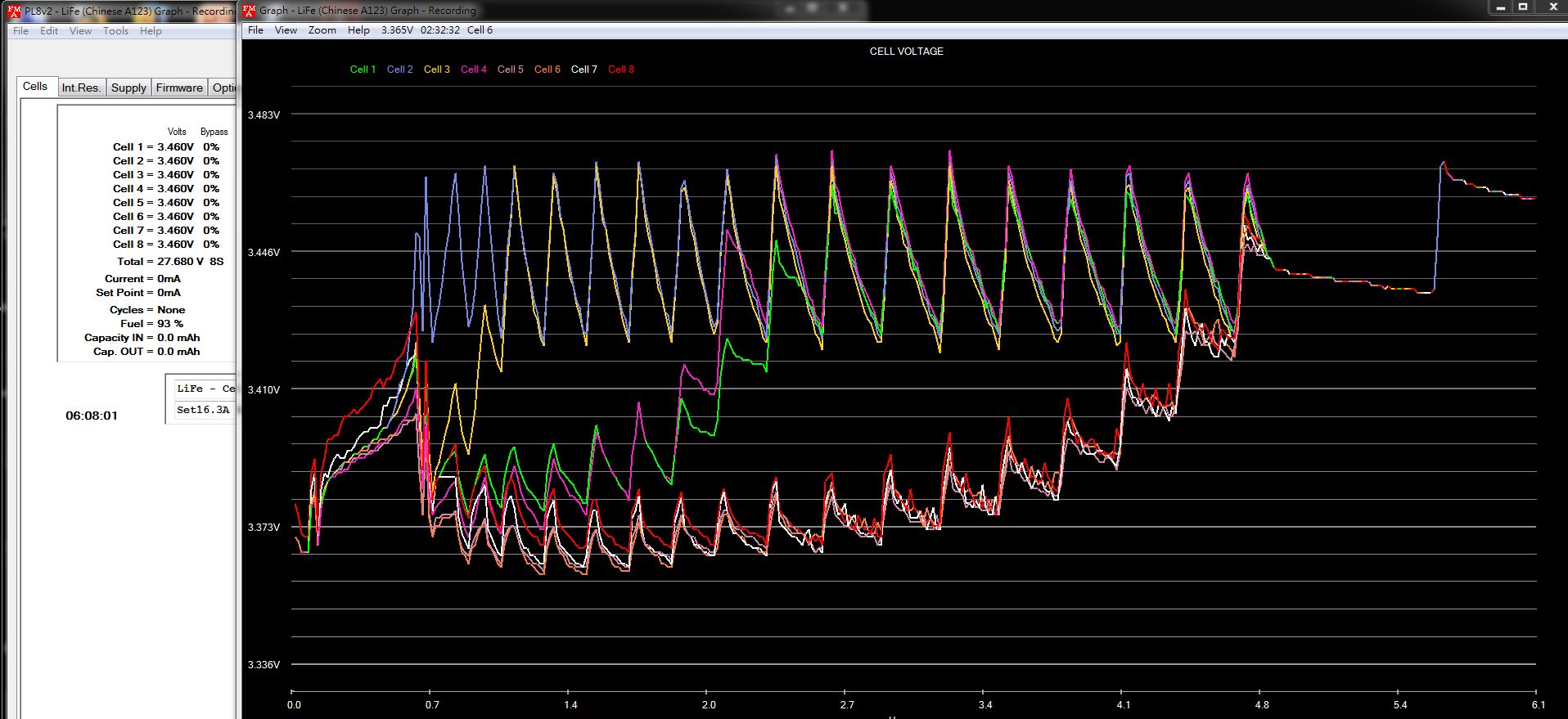

Postby Burgerman » 09 Aug 2024, 21:24
THIS however is what happens if you charge with a BMS and a power supply.
And MONITOR IT with the PL8 only... Not charge it. Just watch what the BMS is actually doing.
And the charger or power supply doesent know when it ends, when it SHOULD end, when its balanced, while the BMS keeps cycling the charge vcurrent on and off... Marvelous! Does it work? Sort of. Does it like it? No!

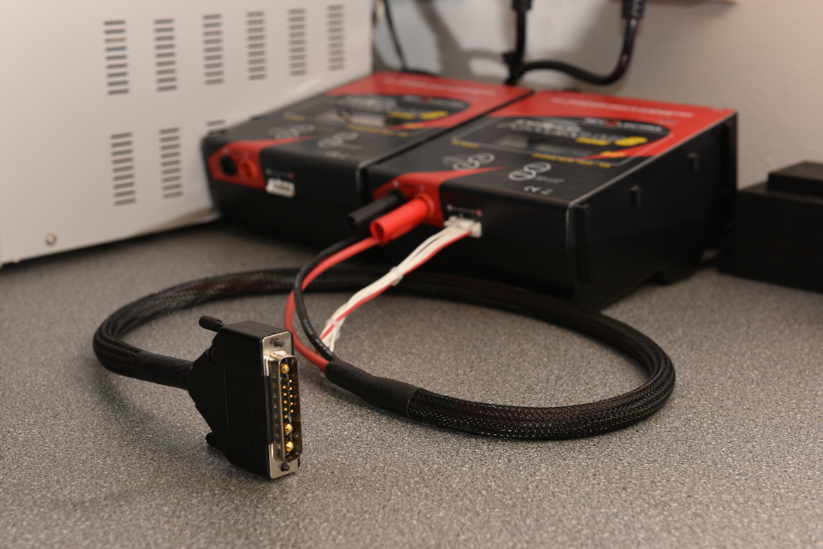

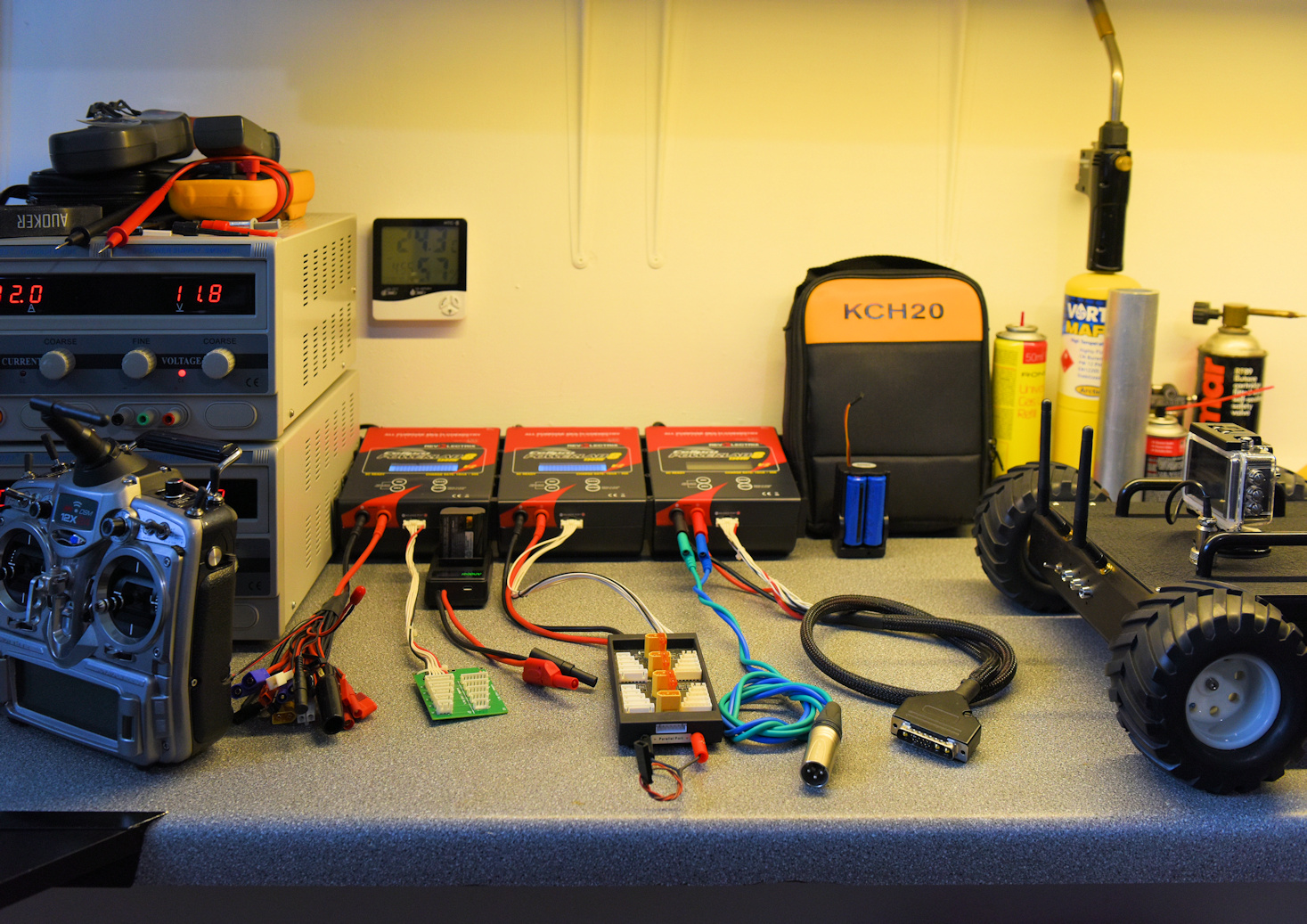

I use these PL8s, theres 3 on my bench, 1 in my van, one next to my bed, to charge my chairs, my hobby stuff, my tools, my nikon camea batteries, my transmitters, my quodcopters and helis, my van, my AA and AAA cells, and 101 other things like my mower, etc.
NON of these packs have anything at all other than the cells. And a balance connector added.
Allowing the PL8 to do a better job that all the BMS nonsense in the world. And you dont need to count Ah out on a chair or scooter uf the pack is big enough in the first place. Likewise you dont need any BMS protection either if its big enough for the job.
And so no BMS, no current measuring, devices = more space for cells... KISS.
