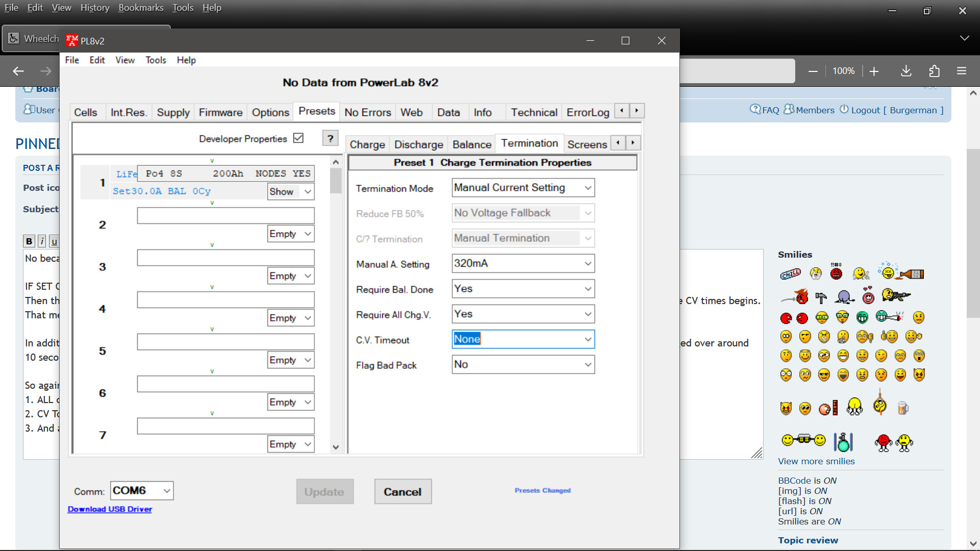

Postby Burgerman » 11 Aug 2024, 17:04
Thing Im confused about is your recommends on monitoring end of charge current with a termination value as per icharge and its %ge of charge current setting etc. JK bms doesnt have such a setting as you point out.
I thought that Lifepo didnt need an absorption phase? I may be confused with LAB
The hobby type LiPo cells, can be as high as 150C so a tiny pack the size of a pack of cigarettes can start a truck. Thats 150 x a 4Ah battery...
Those are so low impedance that charge voltage is practically the same thing as charge voltage EVEN AFTER YOU REMOVE the charge current. And the charge current on a tiny pack can be 40A. Only because thats the full power of my charger! Those dont need more than a few seconds at their 4.200V charge voltage to be 100% full. So the charger algo charges, balances at 4.200V as the charger current drops away to almost zero. That charger doesent stop charging until balance is complete, plus a couple of mins to be sure all cells equally low current.
A LiFePO4 1C pack is very different. The resistance allows your charge current to pull the vltage higher than the actual cell voltage while charging. So it needs to charge untill
a) the cells are all balanced. The charger current will drop to whatever then balancer needs to NEVER exceed the coosen voltage unlike an ON/OFF bms that watches it go too high then chops off the charger repeatedly. When the current on the last cell to catch up reaches the zero balance load point, then the charger still maintains a low current at CV quite naturally until the cell stops drawing high currents. When it reaches around 320th C depending on cell brand, c rate etc the charger ends.
You want the cells all 100% saturated. But not held high too long as they dont like it. So 15 to 30 mins after balance, which you make happen by adjusting the termination current. On the PL8 you set a mA figure. That doesent change if you change charge current. So 1A to 40A and it stays at what you set. With other chargers its a % of charge current. So you need to mess around with the maths and figure it all out.

Cant quite see how this second option works (preumably implemneted in the PL8?
Does the PL8 go into a CV mode after first balance start level is reach by at least one cell. Does it then limit the charge current to a low absorb level say .05C while the remaining cells gradually catch up but it does mean that the first OVP cell will begin over charge to next high level OVP. Whe this is reached it stop charge and goes into balance until all cells at < 1st OVP level. This repeats until all cells are within a preset gap of say 0.001mV and so fully charged near to 1st OVP level, still safely below 2nd OVP level but well below Full stop Level 3
The PL8 watches all cells. It starts to balance at the voltage you choose, preferably choose 3.5V or above. Trying to balance lower than this can actually unbalance the pack. Causing problems. So I set balance to begin at 3.500V. It draws down the highest cells at a proportianal 0 to 1000mA. If it reaches 1000mA, then the balancer cant stop the cell voltage rising above the maximum 3.550V I choose as charge voltage. So the charger can see this, and so it proportionally reuces its output to ensure that the highest cell never exceeds the 3.550V I choose. If one cell reaches this point because of a badly balanced cell, then it might end up charging at 1000mA from this point onwards to match the balance current to keep the full cell from exceeding the correct voltage. It does this accurate to 2mV across all 8 cells.
Once the balance current reaches a 0% (no current needed) it then starts its CV time limit, or the approx 350th of capacity as a tail current and it stops when it reaches this point. Charge then ends when all cells are totally balanced, plus some CV time, and at a low tail current to ensure all cells are equally and fully charged. All stuff a BMS cant do.
As soon as any cell reaches
This is a finer profile than the crude on/off one first mentioned ?
Of course its fully proportional and can throttle the charger output and control balance current level as you charge. From 0mA to 1000mA balance, and from 5mA to 40,000mA charge current. All set to the exact voltages you tell it, the tail current you decide, the charge current and balance start point and cell chemistry and cell count you choose.
Controlled, correct charge. Without bouncing it all on/off... And ending at the correct point. So you dont end up with cooced cells etc.

Postby Burgerman » 12 Aug 2024, 12:21
No because:
IF SET CORRECTLY
Then the timer only starts when the TOTAL charge voltage reaches the preset value. So for e.g 3.550V per cell x 8 = 28.400V which is where the CV times begins.
That means that any cell that is below 3.550 drags the total below 28.400V and so no end, no start of CV timer either.
In addition, theres a setting that says dont end unless all cells = balanced. And that means with a very low or zero drain bypass current - averaged over around 10 seconds.
So again charge cannot end until:
1. ALL cells are balanced.
2. CV Total voltage is at the CV voltage.
3. And after the termination current YOU CHOOSE is reached. Or the CV timer YOU CHOOSE has expired. But once you have determined a safe termination current, that actually gives a 15 to 30 minute balance + CV then this should be set to none as in the screenshot below. A 8 hour limit is great for lead, not needed on lithium. Other than for safety on a LiPo... Those things like to set fire to your house. But the termination current SHOULD be the thing that ends charge. If theres a cell "brake" of 1A on a charged cell, then the termination curent will never be reached anyway. So thats when a faulty cell may need a set CV time for safety.
If its a new unbalanced pack, I set this to off (none.) Because it may take a day to balance!
If its a sorted pack, in use, that ends correcty at around 30 mins after balance, and CV begins, then I would set that to say 4 hours just in case it has a faulty cell. It shouldnt ever reach that point.
Set to always balance fully etc as below in the termination tab.
REQUIRE ALL TO BE AT THE CV VOLTAGE.
REQUIRE ALL TO BE BALANCED.
SET TERMINATION CURRENT initially to around 320th C and correct to match your pack so that you get around a 20 to 30 minute CV after balance ends. This varies a lot so dont worry about adjusting the end tail current.
This require balance done prevents ending unless they are.
The require charge V means each one will be at your chooses 3.550V per cell before it can end.
So it will balance fully, to within 2mV, and all cells at exactly 3.550V per cell, while charge current drops to 320mA or less.
In the safety tab there is a 16 hour limit that will kick in if all else fails. Mostly because if its taken 16 hours to balance or charge then theres bigger problems!
It can discharge for 4 days. You may not see allof these settings. I have a registry hack that allows me beta testing and developer options.
