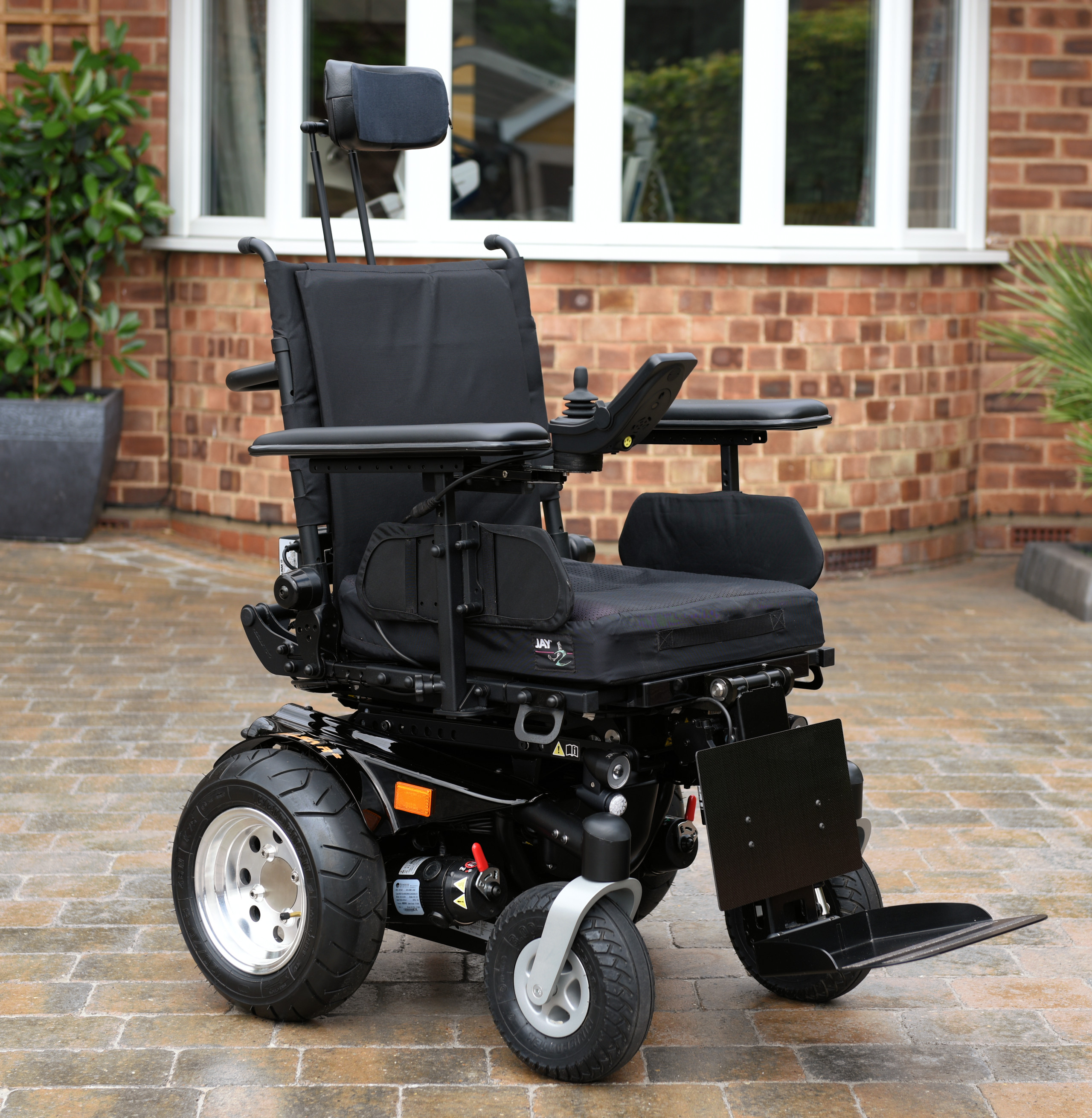

My last 4 chairs were these, ALL modified slightly to make them any good:
Dietz Sango Advanced with selected options NHS
Sunrise Medical Q700R
Q700R again...
Q700R
Invacare Xplore
Invacare Xplore
Sunrise Salsa
Sunrise Salsa
Sunrise Salsa
Sunrise Salsa
Salsa seat down
Postby Burgerman » 13 Aug 2024, 00:01
Thats 4 different full rehab chairs.
The lightest of these is 160KG
The heaviest is 190KG.
All basically the same bar a few details. All feel exactly the same, same seating position and options, same programming, same adjusted seating positions so that if blindfolded I would be hard pushed to tell the difference in use.
Theres more chairs... I have a BM1 that I still use to drive from, not shown, and a couple of older backup chairs. The ones in this post above are all in my bedroom or kitchen and charged, shiny, and ready to use.
I wouldnt take the one you linked to very seriously for my needs. Retail price of these four varies from around 9k to 14.5k.
All are modified a little. Or a lot. In order to make them all behave and feel the same! The Dietz is currently stock, bar a few adjustments needing simple tools. So far. Because that one is an NHS prescription chair I only intend using indoors or in the garden at home. So far untested.

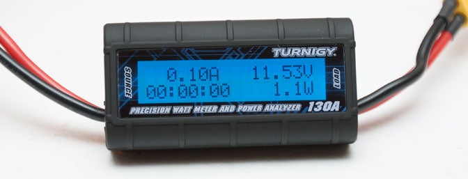

Want to know how far a lithium battery will take you before buying?
Get a cheap hobby grade watt meter. I have a turnigy 130A one, like below. I fitted an anderson grey connector on the input and on the output.
It connects between the battery on your chair and the controller. LITERALLY plug and play in the true sense. Zero your phones sat nav position and miles. Or zero te chairs trip meter.
Set off with it all zeroed. Drive with your chair along or around your area until you get to the point where its flashing red lights and about to run out of juice... Or has done.
Read the watt meter (in Ah used) and also look carefully at the battery volts. Write it down. Look a the distance covered on the joystick or sat nav on your phone that day. Write that down too.
You will find that the faster the chair, the more hills, the faster it runs out of power. And the less the range is.
You will also find that a typical healthy 75Ah battery runs out and dies after a real approx 40Ah is used. At least to the point where the chair will still work. Not close to the 75Ah it is supposed to do. This is because of something called peukert as well as temporary voltage depression when you discharge it fast. And about 12 miles in 2 hours will be about the best you can do. Approx.
So if you get say 36Ah used, and maybe 12 miles, then you can do the maths and find how many Ah per mile. So in this case thats 36Ah div by 12 or 3Ah per mile. You now know that you get around 12 miles range from lead.
Thats a crap figure by the way. Many get more. I get less. So your new 230Ah lithium battery, divided by 3Ah (per mile) CAN do 76.66 miles. Or 60 real miles and still have around 16.6 full miles in reserve. Some 5.6 miles more remaining than the fully charged lead battery was even capable of to begin with! So that is a super safe figure. All you need do is never go further than a 30 mile away destination and back. Use the chairs mile meter and zero it every charge. No need to have any BMS, battery fuel gauge, or anything else to monitor it.
As long as you dont exceed your distance to a safe charge level on the joystick, you are safe.
Your figures may be better or worse depending on your use, your chair, your programming and your surroundings.
