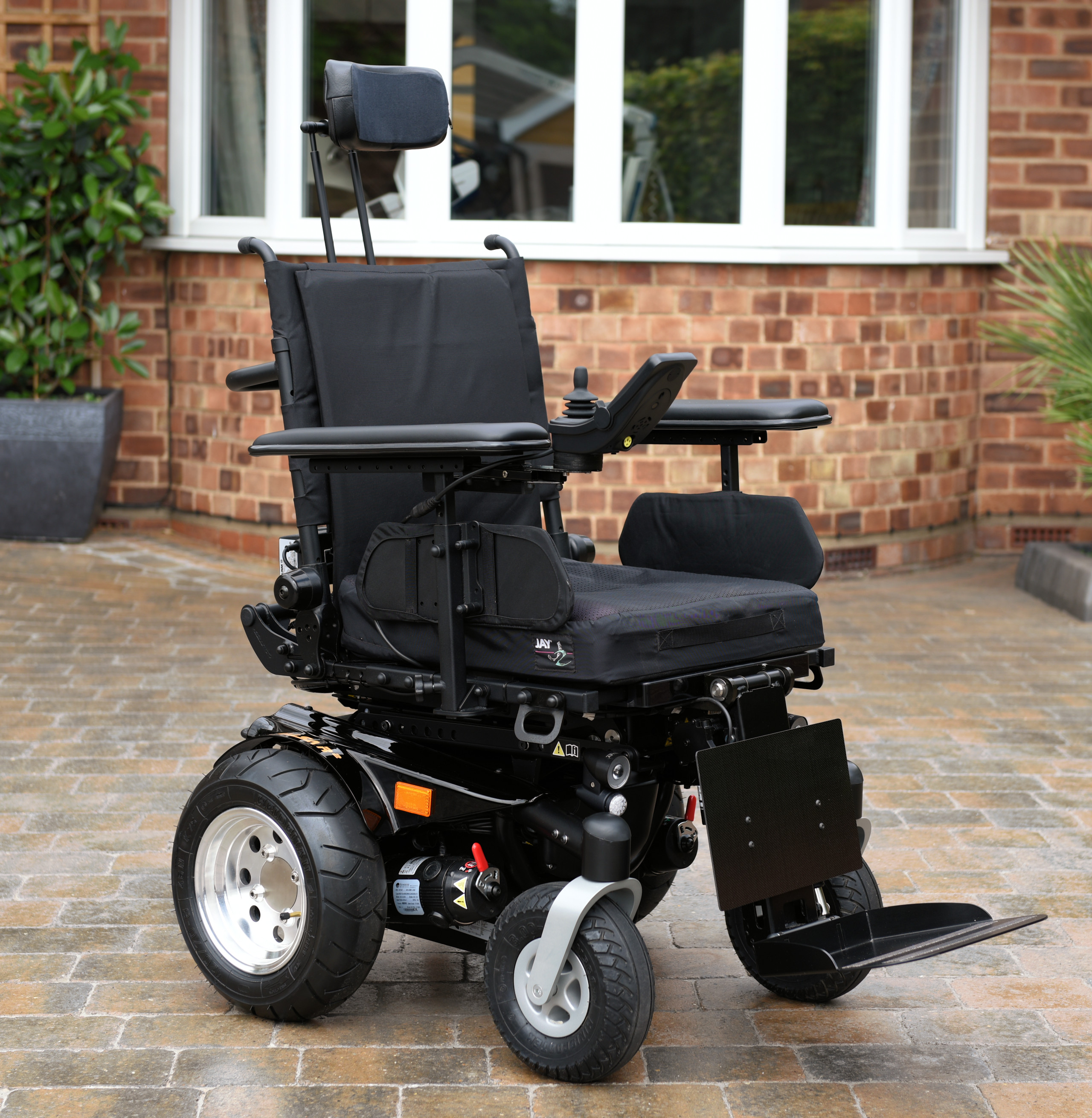

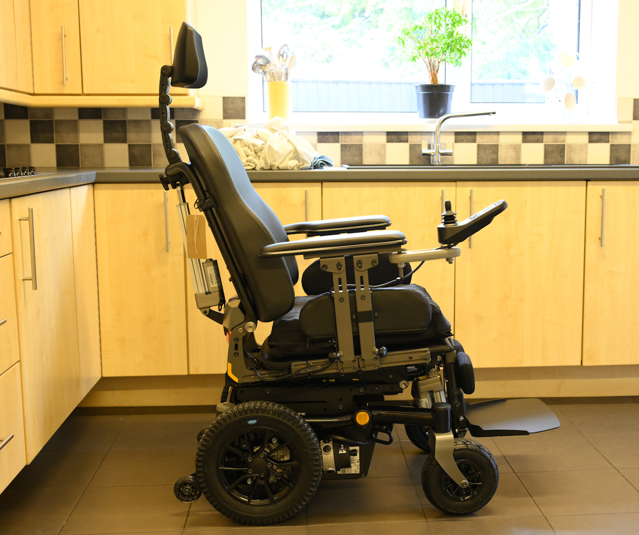

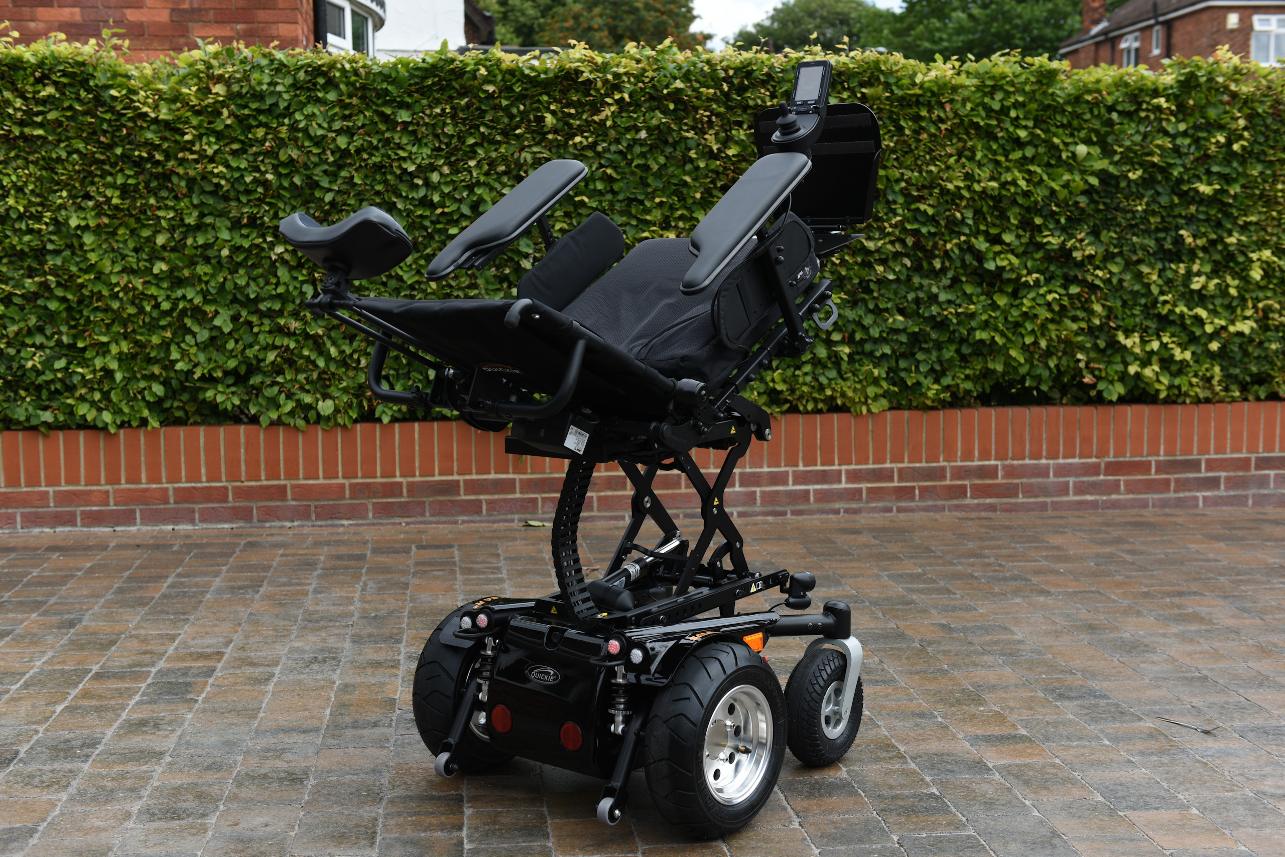

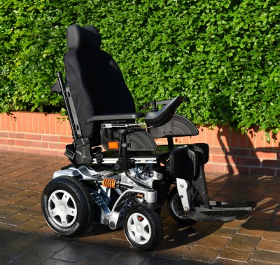

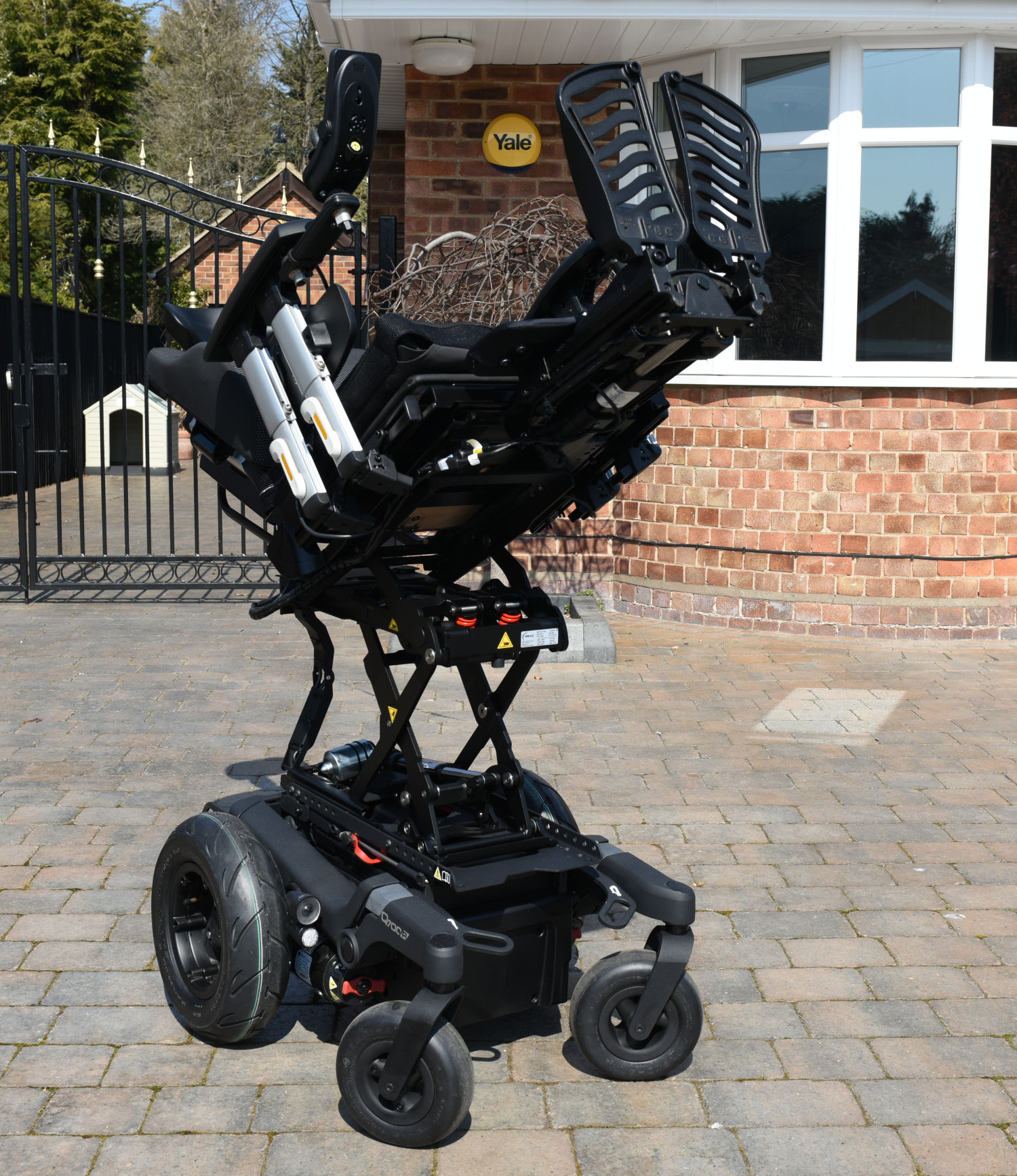

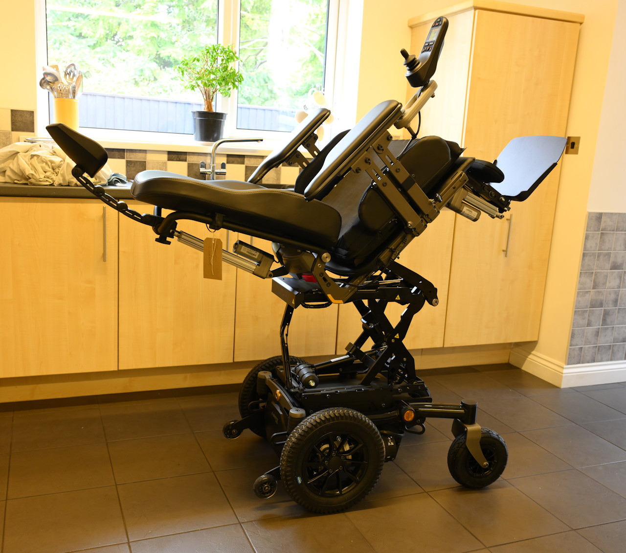

My last 4 chairs were these, ALL modified slightly to make them any good:
Dietz Sango Advanced with selected options NHS
Sunrise Medical Q700R
Q700R again...
Q700R
Invacare Xplore
Invacare Xplore
Sunrise Salsa
Sunrise Salsa
Sunrise Salsa
Sunrise Salsa
Salsa seat down
Posts: 71089
Postby Burgerman » 13 Aug 2024, 00:01
Thats 4 different full rehab chairs.
The lightest of these is 160KG
The heaviest is 190KG.
All basically the same bar a few details. All feel exactly the same, same seating position and options, same programming, same adjusted seating positions so that if blindfolded I would be hard pushed to tell the difference in use.
Theres more chairs... I have a BM1 that I still use to drive from, not shown, and a couple of older backup chairs. The ones in this post above are all in my bedroom or kitchen and charged, shiny, and ready to use.
I wouldnt take the one you linked to very seriously for my needs. Retail price of these four varies from around 9k to 14.5k.
All are modified a little. Or a lot. In order to make them all behave and feel the same! The Dietz is currently stock, bar a few adjustments needing simple tools. So far. Because that one is an NHS prescription chair I only intend using indoors or in the garden at home. So far untested.
Posts: 71089
