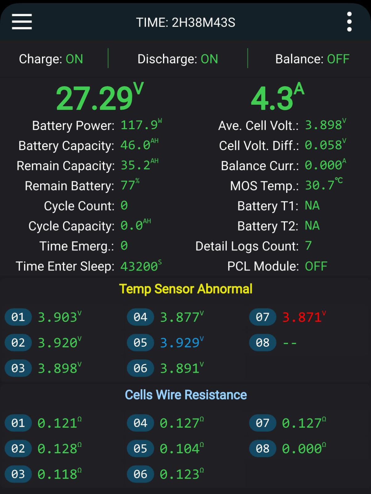

Postby shirley_hkg » 09 Nov 2024, 05:55
This is the smallest BMS with 0.4a balance current.
First picture is settings ,
charge volt @4.2v
Charge resumes @4.135v
Balance ≥ 3.95v

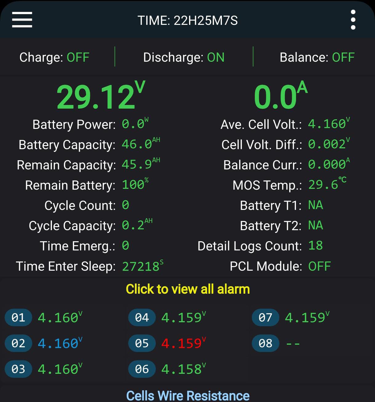

Second picture shows it hits 4.2v four and a half hours ago. Charger disconnected (would not resume as cell 2 is higher than 4.135v) , but balance continues.
Balance is pulling High cell down.

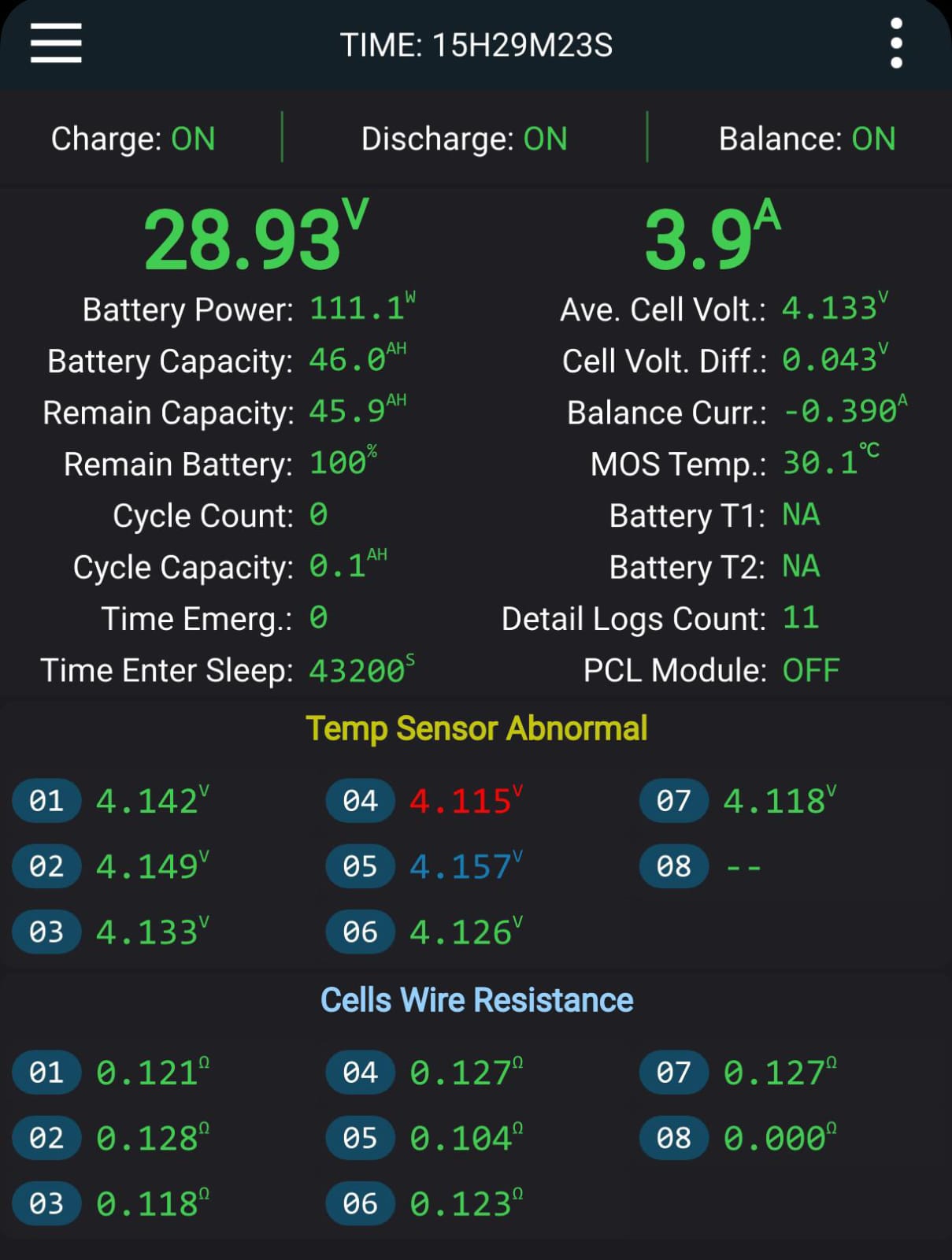

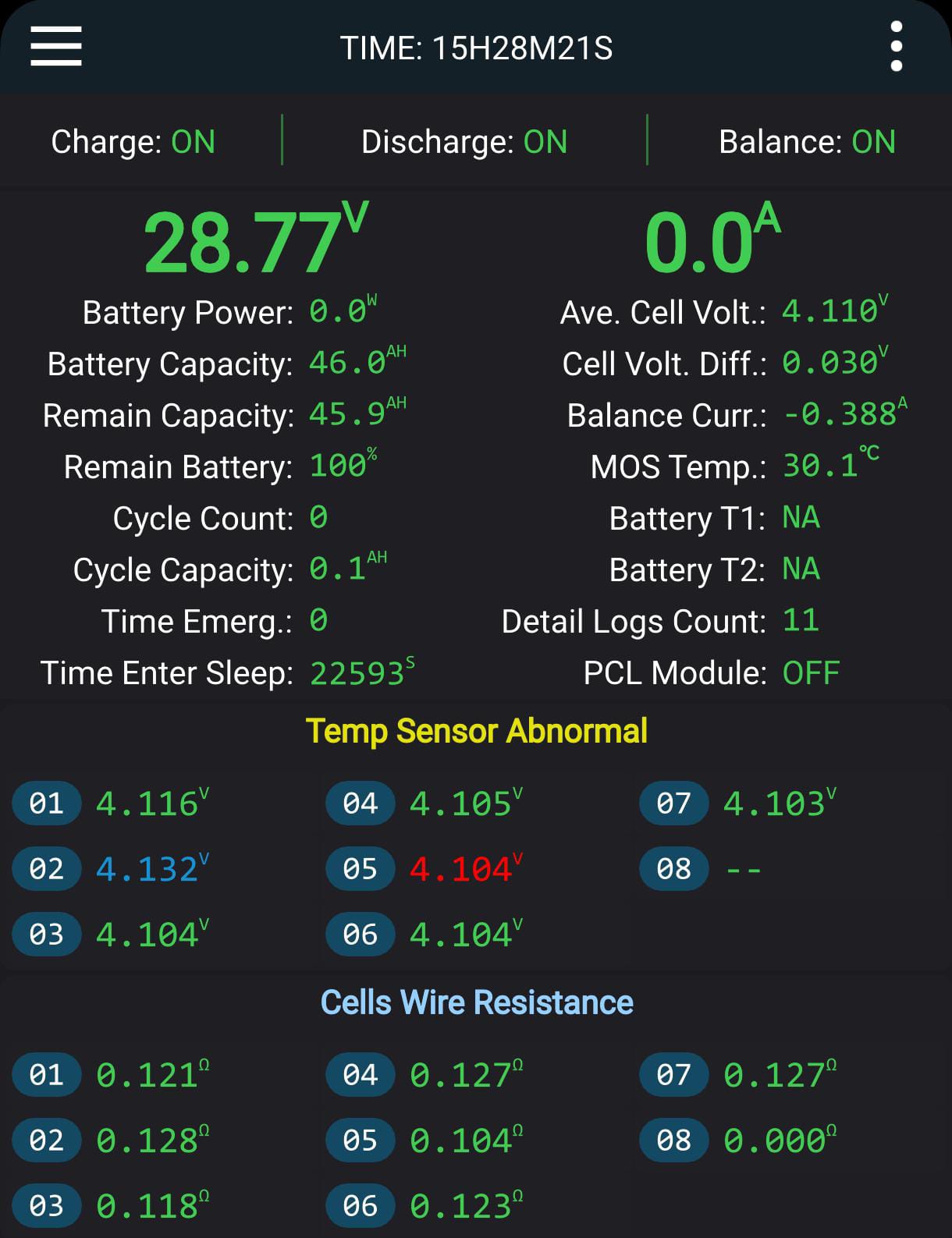

Postby shirley_hkg » 09 Nov 2024, 06:19
5.7 hours from last charge, it resumes charge when all cells are ≤ 4.135v.
A few more cycles to go, before a full balance.
It's slow, especially when SOC is obvious in an initial charge.
It will do in one go during daily use.

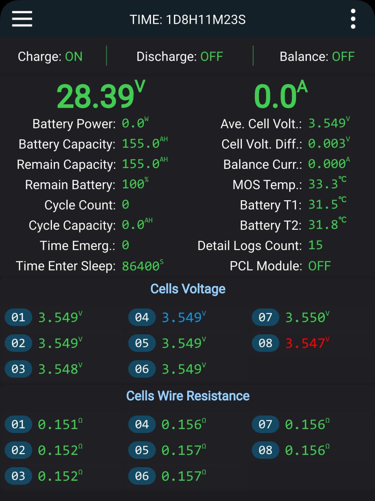

Tested with a 180Ah pack and results as follows.
