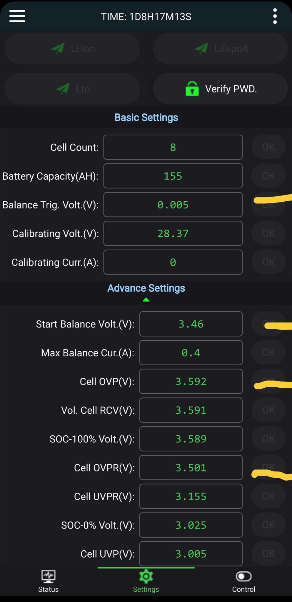

You set the "start balance volt", and the delta V.
It won't balance below these.

OVP will disconnect charger. Any cell.
Any cell is ≥ StartBalanceVolt, balance continues. (if delta V meets ). Charging or not charging.
Charge resumes if all cells below OverVoltprotectionRelease.
All volts are cell volt, not pack volt.

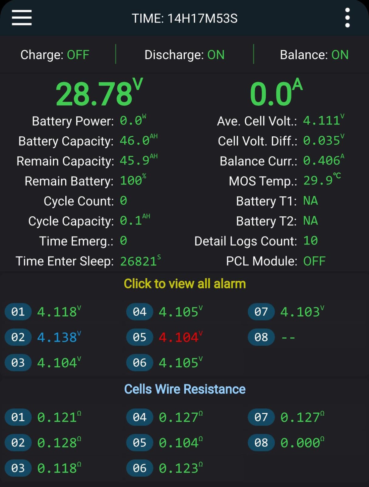

This is the smallest BMS with 0.4a balance current.
First picture is settings ,
charge volt @4.2v
Charge resumes @4.135v
Balance ≥ 3.95v
Second picture shows it hits 4.2v four and a half hours ago. Charger disconnected (would not resume as cell 2 is higher than 4.135v) , but balance continues.
Balance is pulling High cell down.
Postby shirley_hkg » 09 Nov 2024, 06:19
5.7 hours from last charge, it resumes charge when all cells are ≤ 4.135v.
A few more cycles to go, before a full balance.
It's slow, especially when SOC is obvious in an initial charge.
It will do in one go during daily use.

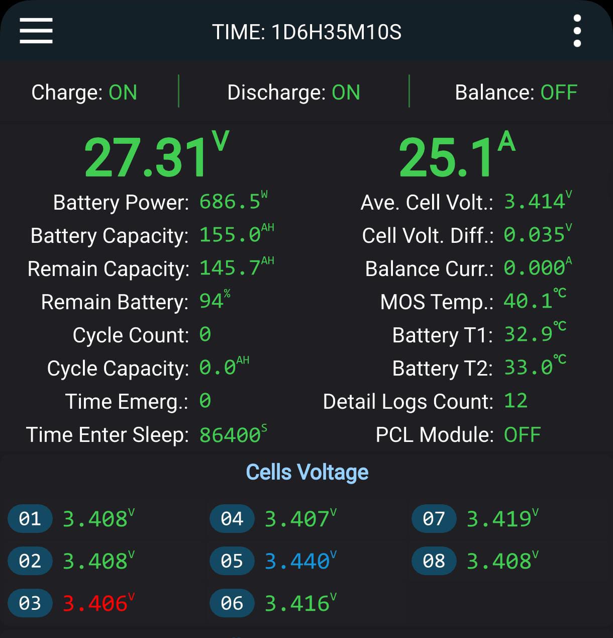

Tested with a 180Ah pack and results as follows.
