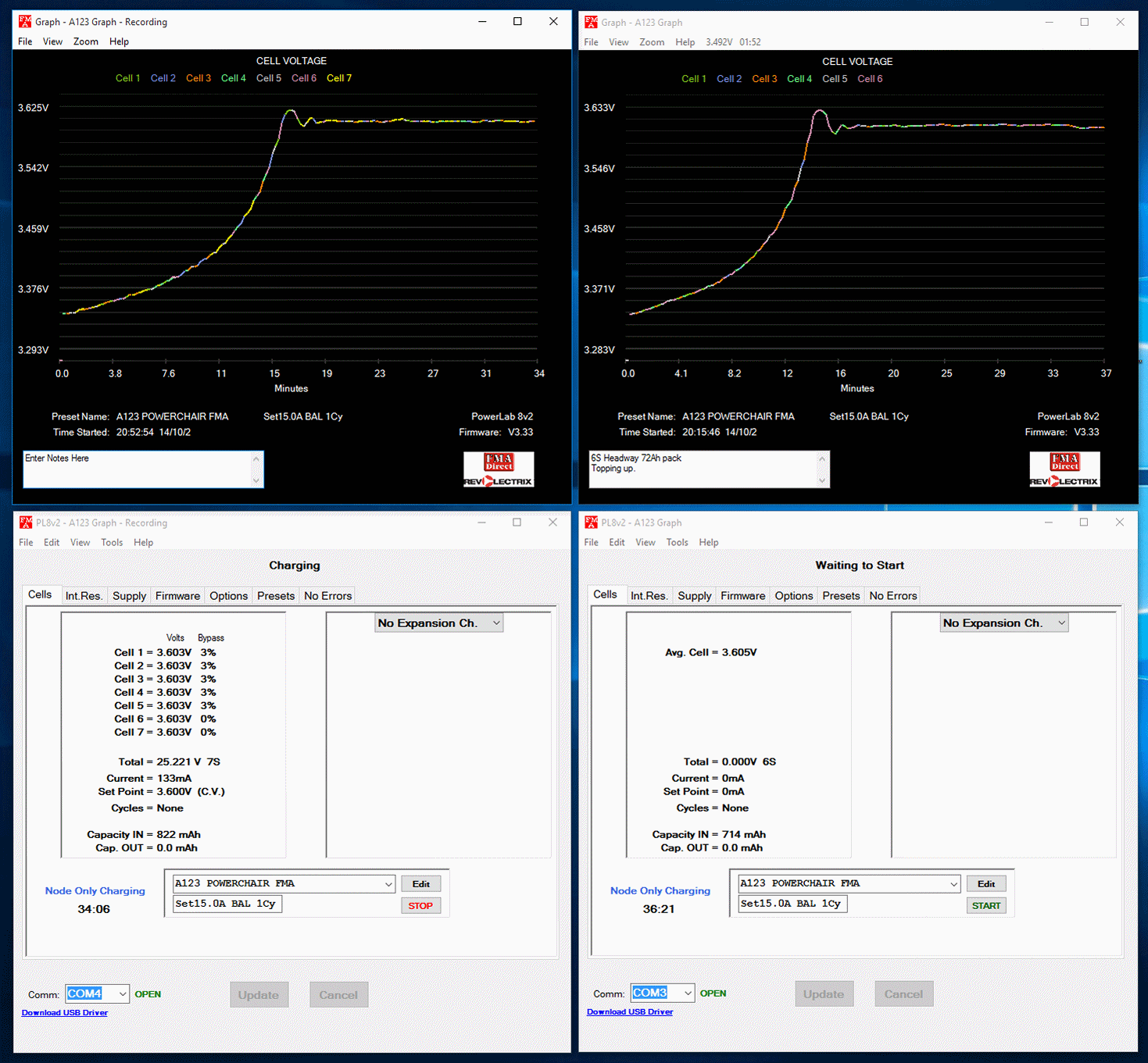

Postby Burgerman » 07 Nov 2024, 12:06
Outputs are floating regards AC inputs and case/ground. Everything.
So you can do whatever you wish with the outputs! Much like a couple of INDEPENDENT batteries.
How do I know? I use 2 of these to connect 2 of pl8 chargers (negs are connected in and out on a PL8), to charge a common 45V 13S battery all connected in series. As an 6S and a 7S. So these chargers negatives are roughly 25V (8S) different potentials to one another. So are the supplies...
And you end up with this, on ONE big BM3 battery.
(one series 13S battery, 2 supplys, 2 chargers.
Note, PL8s non floating, power supplies are 7S or 25 ish V apart. )
Posts: 71102

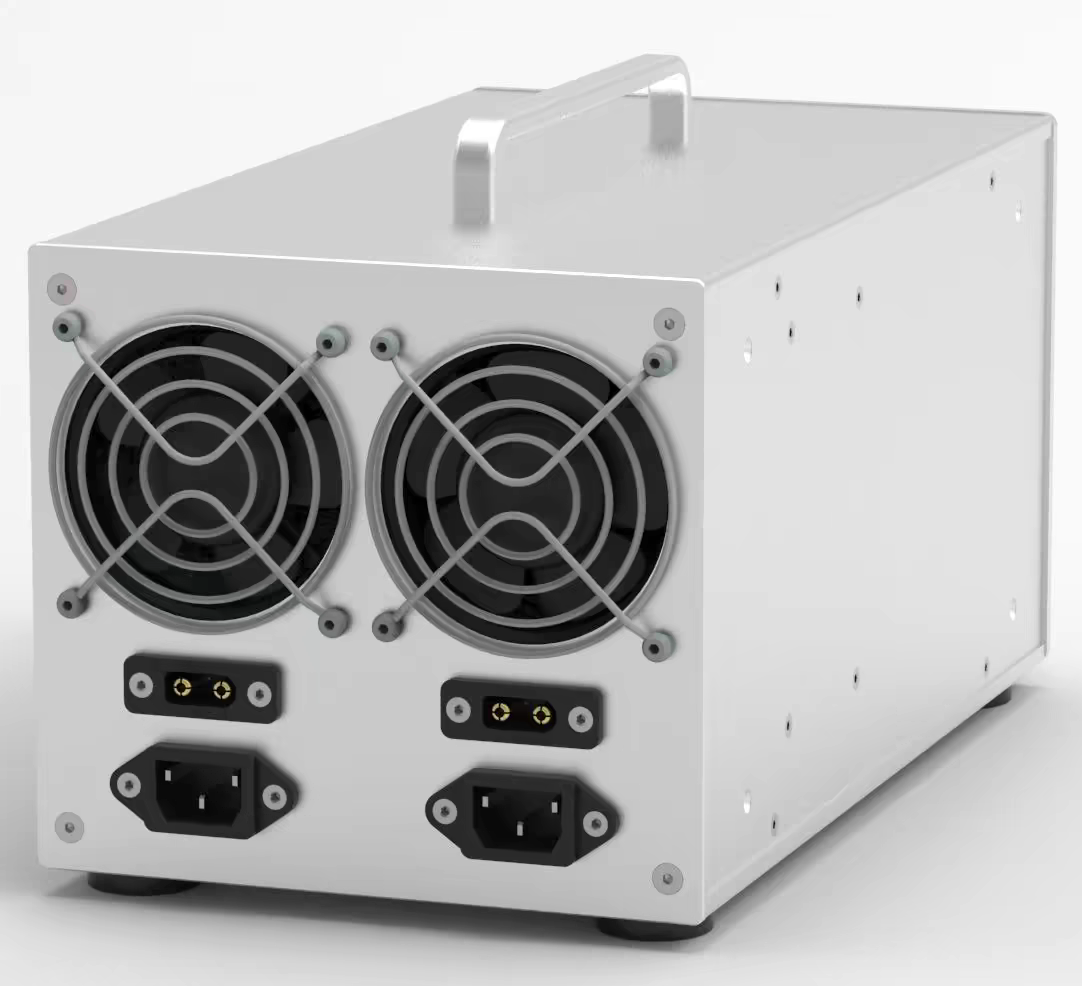

Postby shirley_hkg » 23 Nov 2024, 13:34
youtu.be/T8KwmK7jiho
BM, this is the same fency aluminum case as yours, except that it lacks Anderson SB 50.
I'm afraid that I might have to stick with the stock fan grill.
Posts: 4657
Postby Burgerman » 23 Nov 2024, 13:42
Grill?
Posts: 71102
Postby shirley_hkg » 23 Nov 2024, 13:57
Your's will have SB50
cheers
Posts: 4657
Postby Burgerman » 23 Nov 2024, 14:15
Those are restrictive. Means fan runs faster and so more noise?
Posts: 71102
Postby shirley_hkg » 23 Nov 2024, 15:02
Maybe not. Pore is bigger.
How about get rid of it ?
Posts: 4657
Postby Burgerman » 23 Nov 2024, 15:07
Dont know. Isnt there something like what they used in that picture? If not send as it is and I will swap later.
