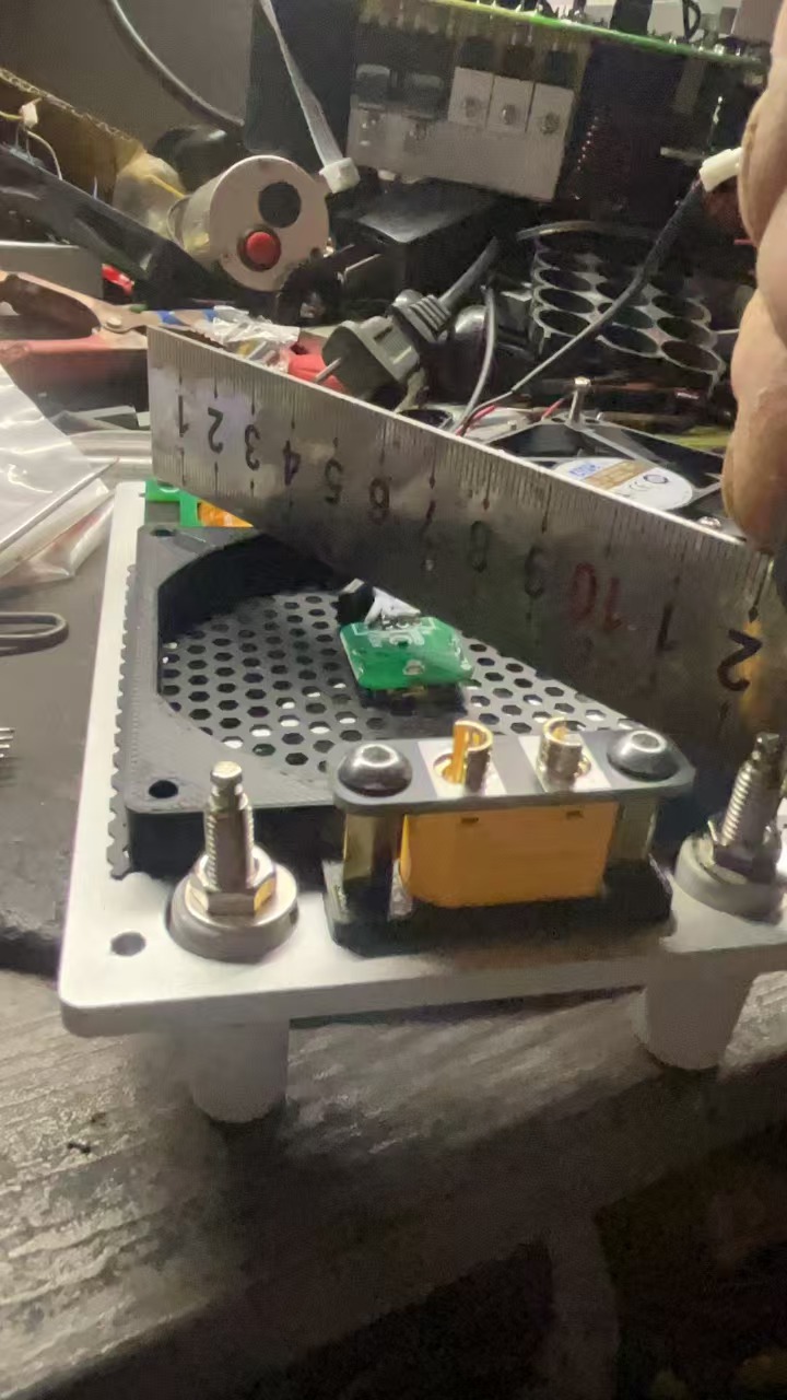

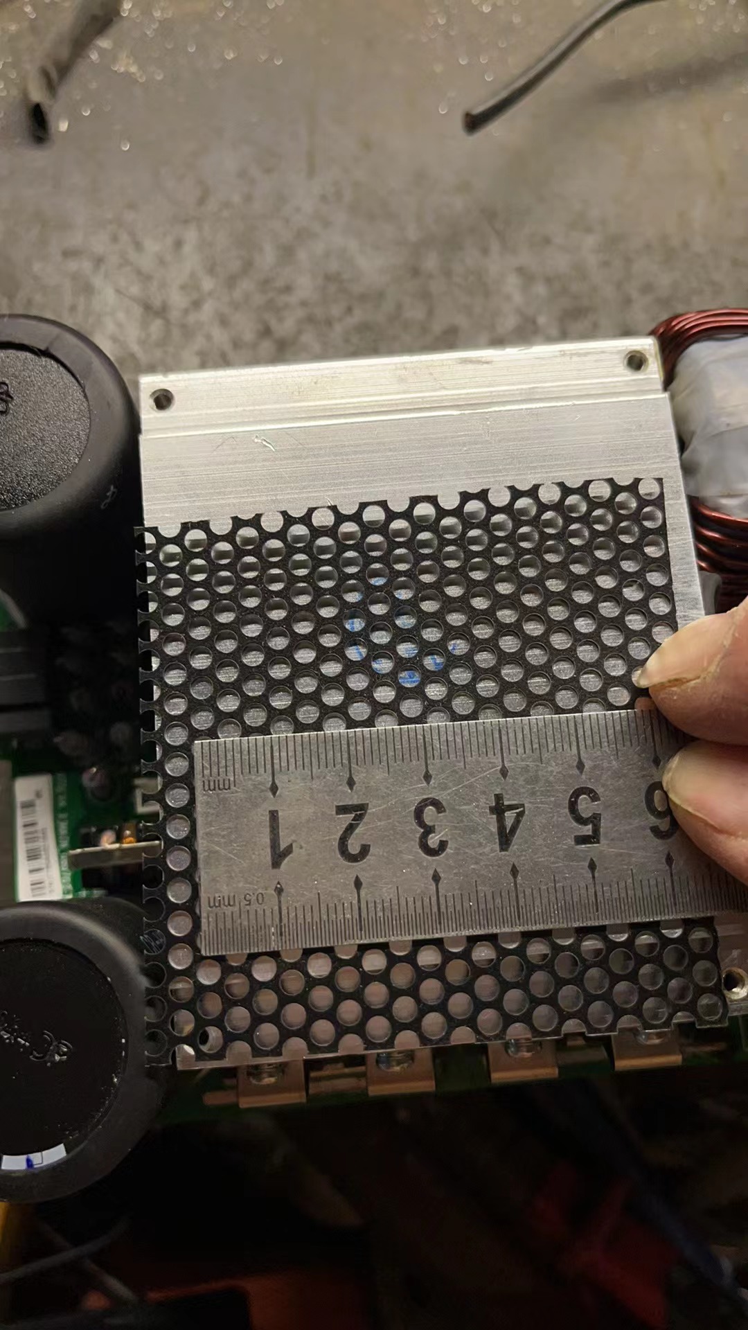

Postby shirley_hkg » 23 Nov 2024, 16:17
Picture shows exactly what they come with now.
Posts: 4656
Postby Burgerman » 23 Nov 2024, 17:41
That should work great.

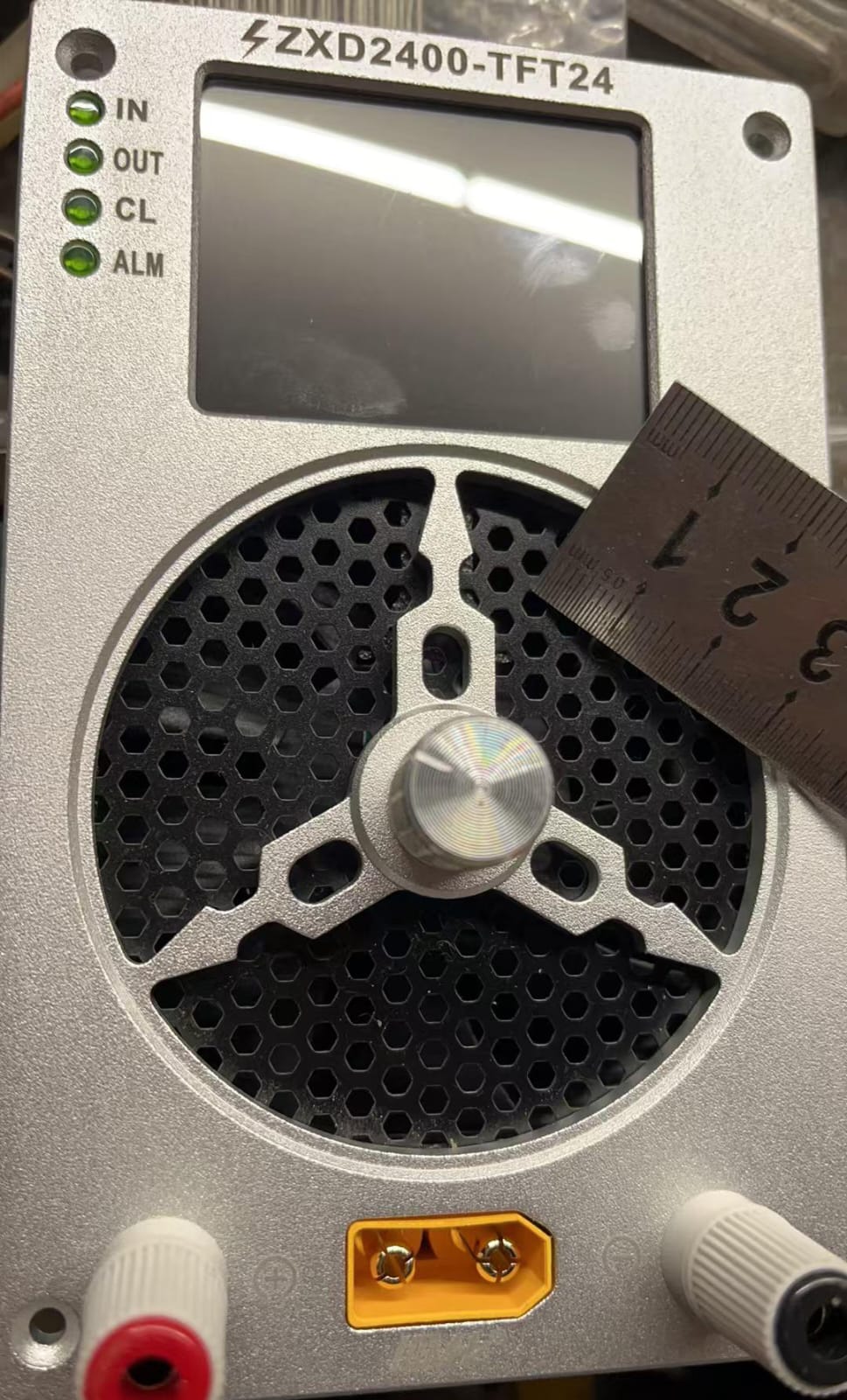

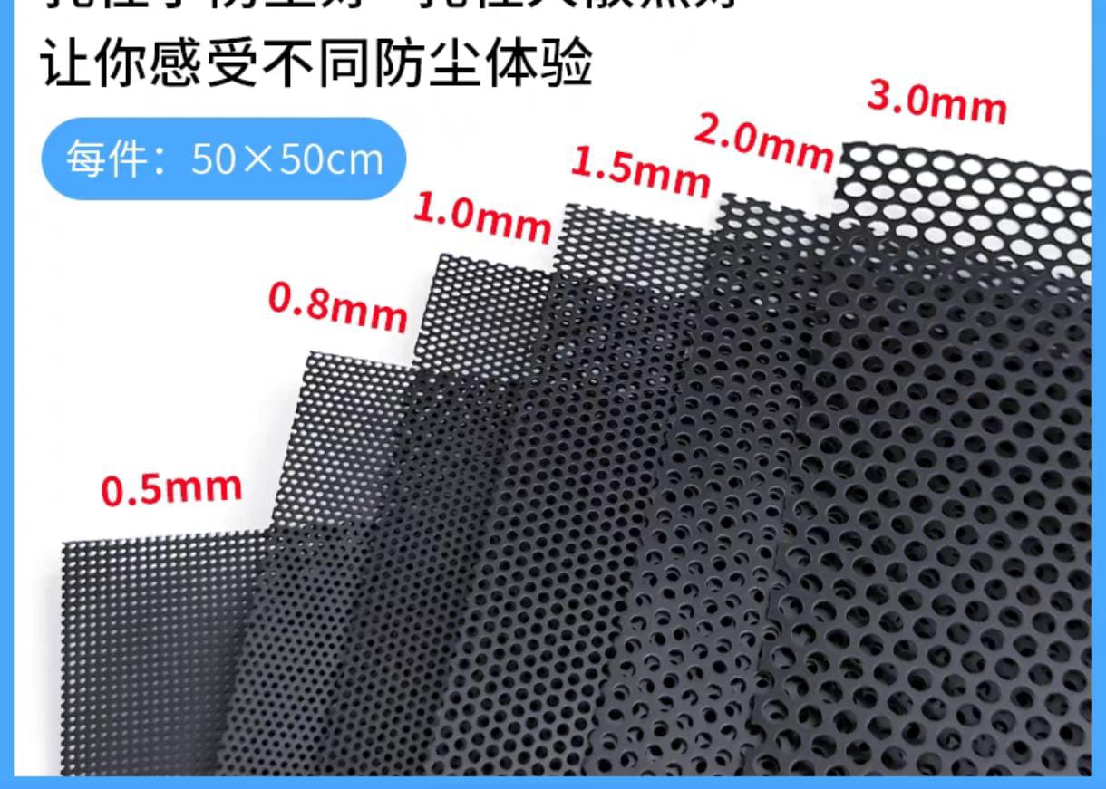

Postby shirley_hkg » 24 Nov 2024, 05:12
3mm pore size seems the biggest we can get.
Posts: 4656
Postby Burgerman » 24 Nov 2024, 05:23
Yes that should work.

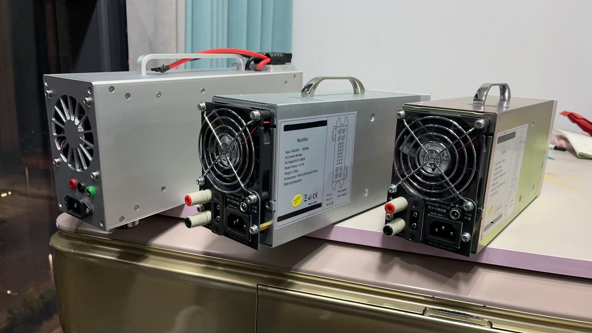

Postby Burgerman » 24 Nov 2024, 16:11
There are 2 different smaller ones.
One has bigger screen and smaller fan. That I am getting.
Other type has smaller screen slightly. And a bigger normal fan. And probably a bit quieter.
Posts: 71095
Postby shirley_hkg » 24 Nov 2024, 16:21
They both have the same 8cm fan, only different front plate layouts .
Posts: 4656
Postby Burgerman » 24 Nov 2024, 17:46
Oh. Just LED placement different then to make space for bigger screen. Both 20mm shorter height.
Posts: 71095

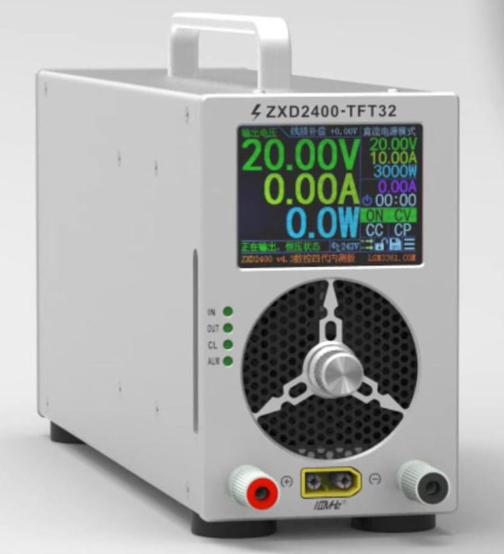

Postby Burgerman » 25 Nov 2024, 13:35
The one I am expecting in december.
Front has:
XT90 and that can do full power @ 0-50A and 0-60V.
4mm banana type posts, 20 to 25Amps safely. More if you risk it! Mostly for bench electronis use.
80mm fan, status LEDs lower below screen, side vents for cooling air added.
Rear has:
AC connector.
2x 4mm SENSOR bananas for temperature monitor and voltage compensation - not essential but nice to have.
Custom: Anderson 50A connector.
Will make up a bunch of XT90 leads with XLR, Anderson, XT60, Croc Clips, a long XT 90 extension. Y adapter leads for charging several things at once, multi leads with several different ends, etc.
Posts: 71095
Postby ex-Gooserider » 26 Nov 2024, 03:13
shirley_hkg wrote:Maybe not. Pore is bigger.
How about get rid of it ?
Bigger holes are good, but you don't want to get rid of the guard totally on the INPUT side of a fan as if you stick a finger in you are likely to get damaged - the leading edge of the blade hits first and is angled to pull you in.... I often get rid of grills on the OUTPUT side, as the flat of the blade is what would hit your finger, and it would push it out....
Postby shirley_hkg » 26 Nov 2024, 05:21
No. I wouldn't get rid of the mesh.
The encoder is in the centre, that allows no room for anything thicker than 2mm.
Just keep it this way.

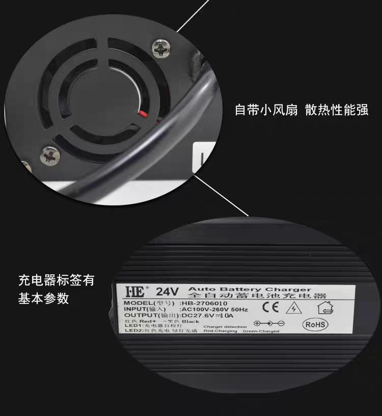

Postby shirley_hkg » 26 Nov 2024, 16:29

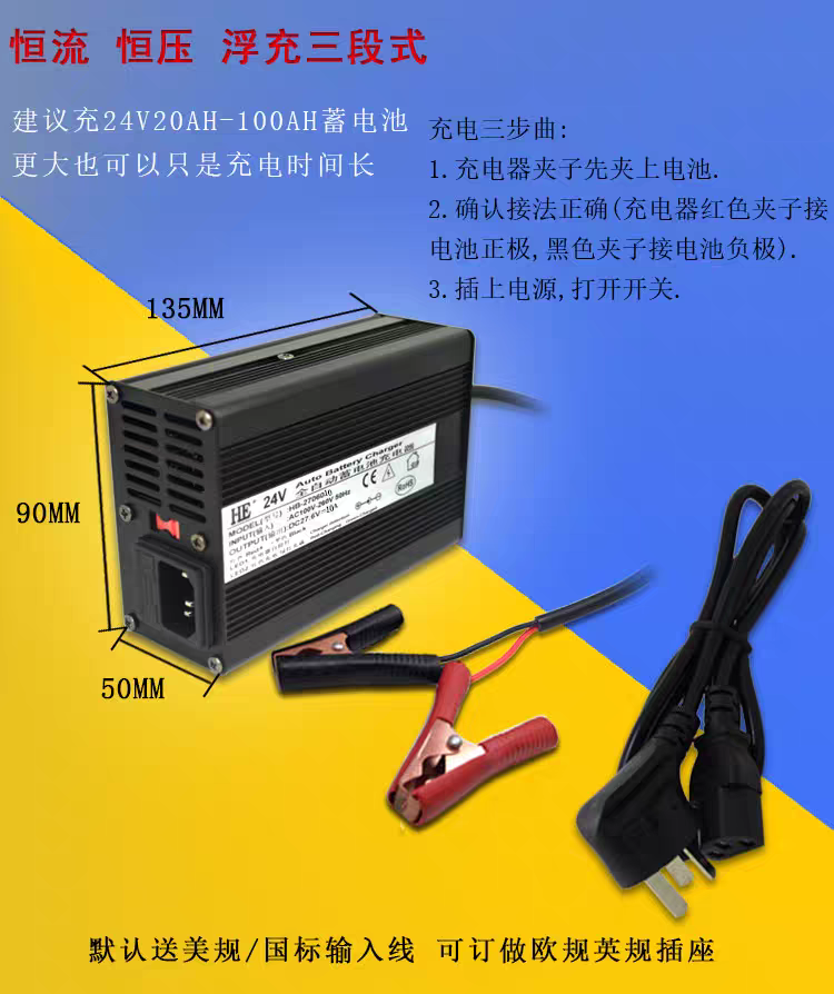

My power supplies are very lightweight, a couple of kilos. I'd choose one of them if travelling, I think.
Still too heavy for travelling.
Mine is <1kg / 24V~10A.
£23.
Posts: 4656
Postby Burgerman » 26 Nov 2024, 17:17
13.8 / 27.6V means OK for a couple of weeks. Will get a 90 to 95% charge in about 8 hours. 98% in about 16 hours. 100% in a day.
But ideally you want 14.1 / 28.2 V for overnight. 99% overnight, to 100 full in CC? x hours +/ 8 hours @ CV
But good enough for holls...

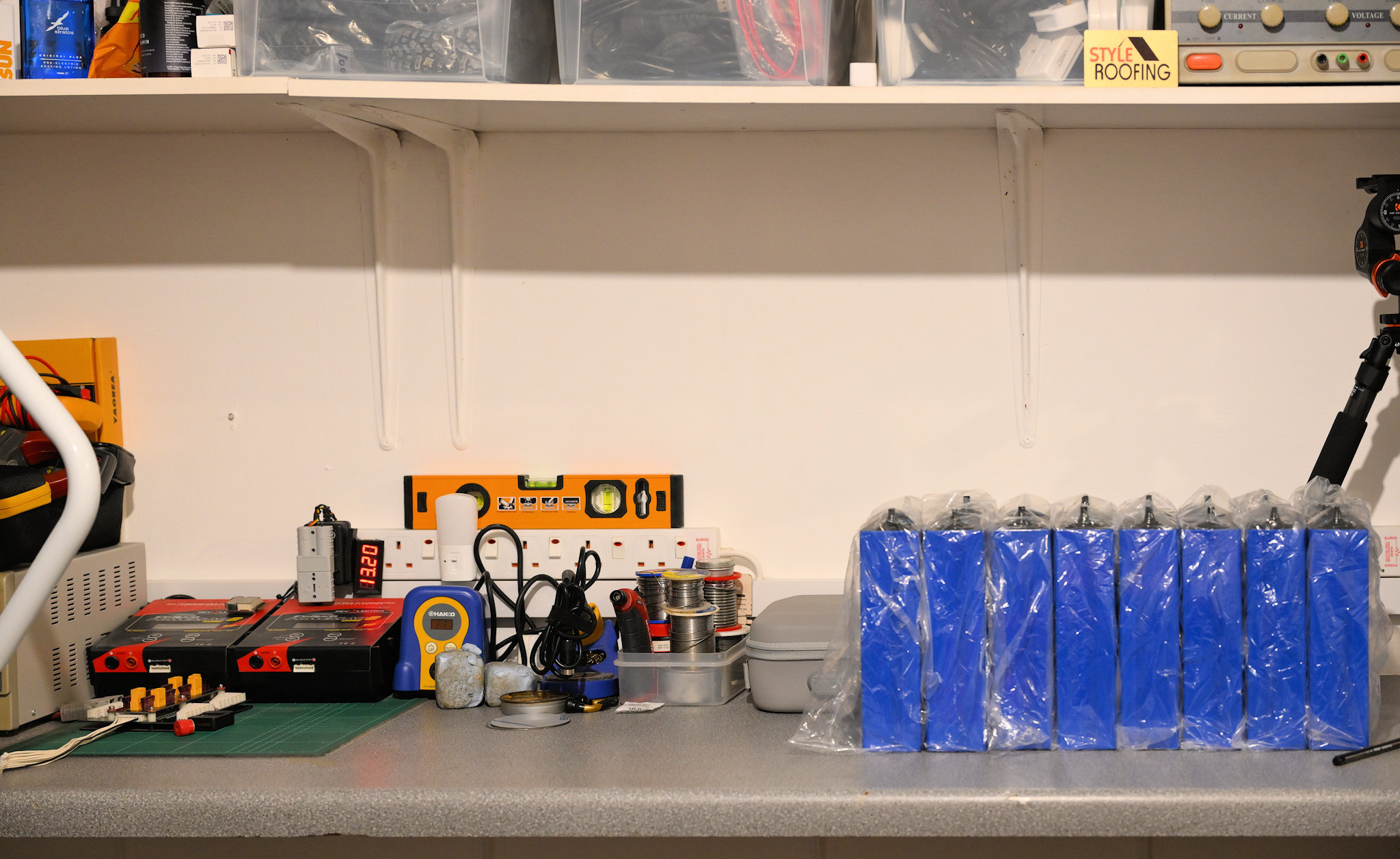

Postby Burgerman » 26 Nov 2024, 19:18
Ignore the 2 chargers, batteries, white crane handle, and the van charger sat at 13.2 on the wall... And spirit level etc.
Heres what you NEED to solder a lot of different things neatly and easily:
1. a table or bench... Grey thing!
2. a good thermostatic powerful compact iron that responds fast. So it doesent cool in contact with a lump of metal, and doesent overheat and turn black and burn the flux off... Blue/Yellow thing. On its right is the actual iron in its stand. That has some brass cleaning "wool" thats essential to keep it tinned and shiny.
3. 2 huge blocks of Blue-Tack, dirty and abused and covered in flux etc to hold wires, connectors.
4. In front of blue stuff, tin of flux, a rosin very mildly acidic flux paste. This stuff is the secret to soldering. Looks like earwax. But dont know if that would work. Dont try it.
5. plastic tupperware container has a "turbo" lighter. Thats essential for bigger connectors or things that the iron isnt man enough to do, e.g. XT90, Anderson....
6. plastic tupperware container again... ACID plumbers flux for tinning or soldering old stubborn oxydised stuff. Old wires. That stuff is horrid on your skin.
7. plastic tupperware thing again. Different types and THICKNESS solders. Always use lead/tin (60/40) cored on electronics stuff.
8. Small tin of iron tinning stuff. Make it easy. to fixand re-tin the tip.
You MUST have a clean fluxed joint in order to properly solder anything. Unless its a tiny bit of electronics the cored solder alone is not adequate.
You MUST have a shiny tinned clean iron. To keep it that way you have to keep cleaning the tip, dipping in the flux, and retinning with solder. And once the joint is soldered, turn the iron off after dipping in flux/solder ready for tomorrow!
Soldering is simple. CLEAN, unless fresh clean parts, cable. Flux, and heat JOINT quickly and not the solder. The solder can be used to help transfer the heat, and when joint is hot enough it will run and do the joint for you all smooth and shiny in a second. STOP.
A joint shouldnt take more than a couple of seconds or you are doing it wrong. If it does you will have to re clean it and start again as once too hot it oxydises and garantees no soldering...

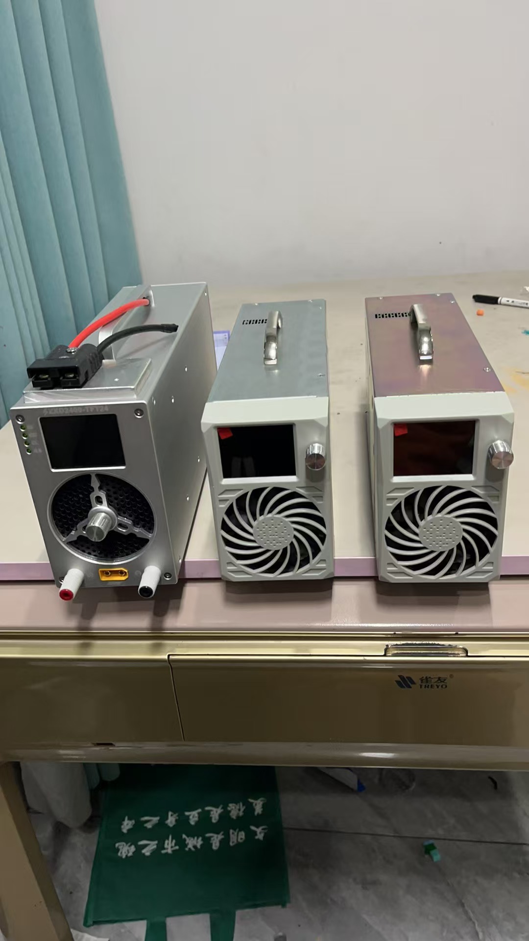

Postby shirley_hkg » 30 Nov 2024, 16:58
Sorry for the long wait.
Posts: 4656
Postby Burgerman » 30 Nov 2024, 20:26
No anderson on top. Ugly! Ruins the nice design. :shock:
So not needed.
Posts: 71095
Postby Raro » 30 Nov 2024, 22:24
Yes, it looks ugly with the exterior Anderson, I guess there won't be a zxd with Spanish language, right Shirley?

Postby shirley_hkg » 01 Dec 2024, 03:28
youtu.be/XvLakOQdbTI
cheers
It won't a zxd with Spanish language, right Shirley?
New ZXD is bluetooth upgradeable, and is still developing, though only English and Chinese are available for the time being.
Anderson SB50 on the outside is a bespoke set.
It's not everyone's cup of tea.
