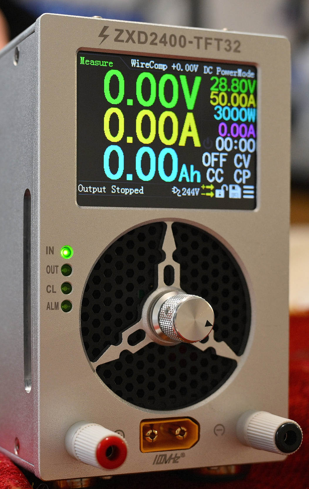

Postby Burgerman » 02 Jan 2025, 22:18
In FACTORY menu
AUTO DIAGNOSE
Try it. Finds any faults, doesent fix anything. DISCONNECT ANY BATTERY OR DEVICE.
AUTO DIAGNOSE & ADAPT
Same thing but configures and sets up everything as stock. And you lose all customisation and personal settings.
ADAPT IN ADVANCED MENU
Moves this stuff to the advanced menu
4 WIRE CABLE USABLE
On the rear is a black and red 4mm banana connection sockets. This enables/disables them. And makes the settings for this available in the ADVANCED menu. It allows you to run 2 extra (thinner) sense wires to get totally accurate Voltage at the actual battery terminals. It corrects for cable and connector resistance losses completely.
VOLTAGE LOWER LIMIT
Sets lowest voltage that a user can set.
VOLTAGE UPPER LIMIT
Sets the highest voltage its possible for a user to set. So if you only EVER charge powerwheelchairs and never need other settings you might set 26.60 and 29.40 Volts as your minimum and maximum. Makes it faster to set up and helps garantee no errors.
CURRENT LOWER LIMIT
As with Volts above. But lowest current a user can set in Amps.
CURRENT UPPER LIMIT
Sets the highest current a user can set. So to save time in settins up, and to be sure its impossible to fry your Joystick XLR input you could set a minimum of say 3A and a maximum of 12A.
POWER LOWER LIMIT
Sets the miniup power a user can set. In WATTS. No idea why you would need that!
POWER UPPER LIMIT
Sets the maximum allowable Watts. Maybe to protect an AC supply or generator? No idea. Remember this is output watts. Input watts will be 10% greater.
FAN SETTINGS. - MAKE IT SILENT!
If you watch at idle, or very low current, with a torch (flashlight) you can see the fans rotating.
I set FRONT FAN START to 0%, which stops the fan and then gradually increased the percentage to the point where the fan JUST began to rotate and then I added 1% extra. I ended up with the front fan turning and starting very reliably, but turning so slowly that you can count it. Totally silent.
Note this setting WILL be very slightly different for every unit, so best to check your own.
And in the case of mine (with smaller front fan, larger screen) this final figure is 28%.
I did exactly the same for the rear fan, and this figure ended up at 30%.
The fans will STILL ramp up as needed if you start hammering it at high Amps. But for charging at 12A next to your bed its as close to silent as doesent matter! Also means litle dust gets drawn in. Doesent even get warm.
VOLTAGE FACTORY TRIM
Use ACCURATE voltmeter to set voltage - dont bother its super close already.
CURRENT FACTORY TRIM
Use ACCURATE current meter to fine tune current. Again dont bother as its not critical.
VOLTAGE MANUAL (USER) TRIM
Use ACCURATE voltmeter to set voltage - dont bother its super close already. (I added +0.2)
CURRENT MANUAL (USER) TRIM
Use ACCURATE voltmeter to set current - dont bother its super close already.
START-UP SCREEN
2 options. Manufacturer logo/Progress. I set this to Progress as it shows a boot progress bar at start up.
DC POWER MODE USABLE
On settings at top, allows this to be visible or not.
LI-ION MODE USABLE
LEAD ACID MODE
On settings at top, allows this to be visible or not. You may disable the other two, if you only charge lead batteries. So no mistakes.
PFC WORKING STATE
No idea.
EEPROM EDIT
Dont!
I missed out all the obvious ones like setting menu passwords etc.

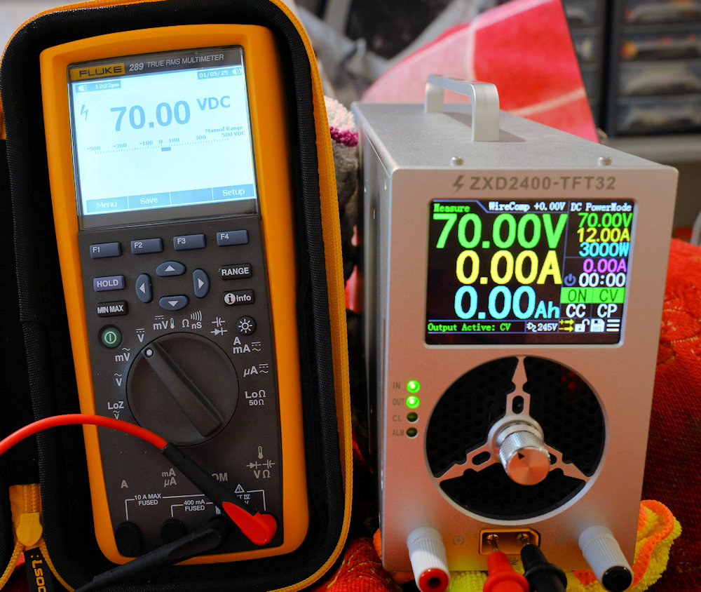

Re: ZXD2400 Old + New 3Kw 0-60V 0-50A Power Supply & Charger
Postby Burgerman » 05 Jan 2025, 13:19
Do you remember the voltage questions? 60V or 120V and different transformers and capacitors etc?
Well I needed to know. And to properly calibrate.
So then. These can output 73V and all works normally and tested under load. At 74V its a no go... It just kicks itself off every time you try to turn the power supply to ACTIVE.
So I decided that since it appears to have 100V capacitors, or higher, that setting a few volts less than that 73 was a good idea. So now the spec is:
0-70V 0-50A.
Now 70V !!!
