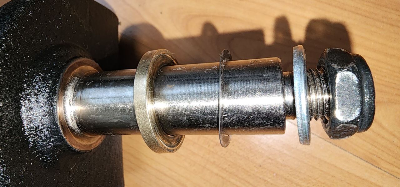

Postby Flagmax » 15 Feb 2025, 00:02
BM, this got me thinking, maybe I could install a Thrust bearings instead of bronze spacer washer on the Aviva.
Another good video to watch on the 4Front https://www.youtube.com/watch?v=hoxEr4k2h34 which I assume very similar to R Trak.
Flagmax
Posts: 142
Joined: 15 Jun 2022, 02:02
Re: Invacare Aviva Storm RX20
Postby Burgerman » 15 Feb 2025, 00:09
If it has 2 flat surfaces.
But the real solution since that only removes the friction from the vertical loading, is to replace the whole isolastic/polyurethane/rubber bush thing completely. Since a caster is off centre due to its trail angle it loads that thing up sideways too. And since its got WAY too much human sat on the front it wont ever steer properly due to all the added friction.
Then way better, remove that bush thing, just use normal bearings, a pair, instead. You will lose the marketing suspension but then you will have proper bearings. If you make sure that the one that takes the vertical load, is an angular contact one, or a taper roller bearing then all the better. Use stainless ones, gob everything with that red sticky grease and it will work as good as new in 2 decades.

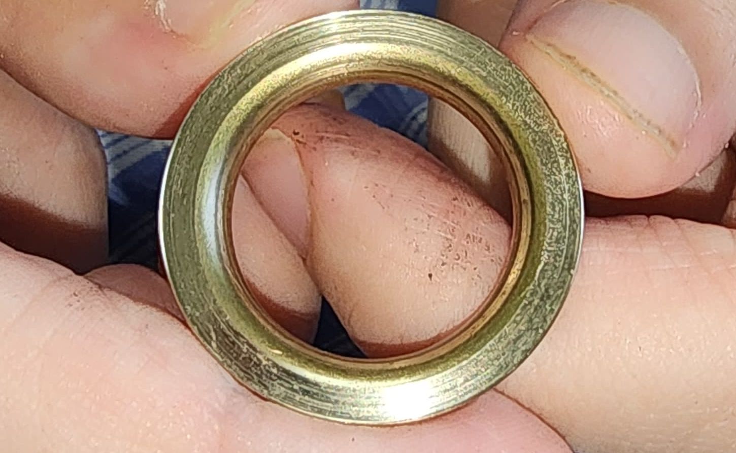

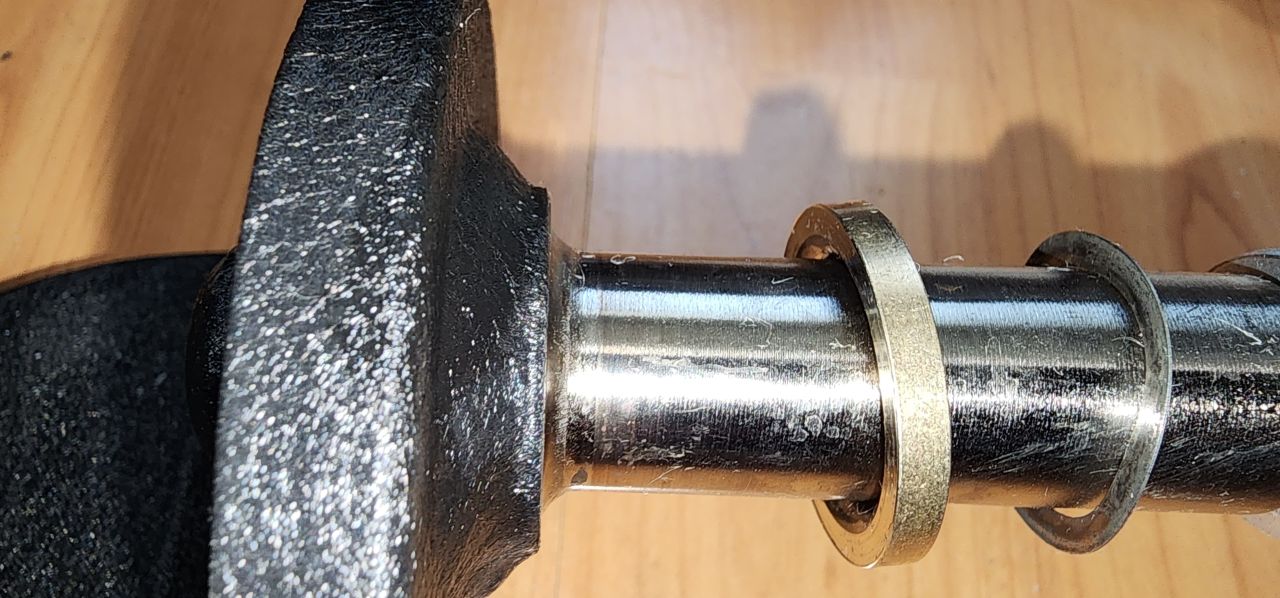

Postby Flagmax » 16 Feb 2025, 06:58

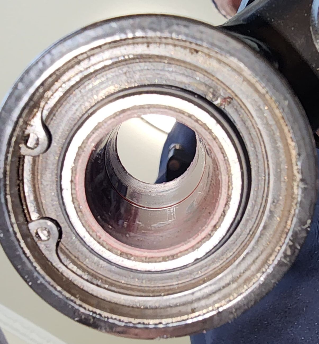

After cleaning the parts, this is what we see. The bottom of the bronze spacer/washer developed grooves and lost about 1 thou.
Flagmax
Posts: 142
Postby Flagmax » 16 Feb 2025, 07:02
Outer rubber, middle metal sleeve, inner plastic sleeve.
Flagmax
Posts: 142
Postby Burgerman » 16 Feb 2025, 07:03
Theres nothing wrong with any of that. It looks exactly the same as every caster fork I ever saw. The same as all the normal ones that sit in 2 bearings.
Its the other half on the chair we need to see. I still cant understand what is there.
Does any of that turn. Is there a bearing of any kind or is it meant to turn in that inner plastic sleeve?
If theres no bearings then its designed by an idiot. It should still turn however, ONLY IF it was lubricated properly, and wasnt overloaded by being too front heavy.
Or it will obviously just jam. And it will do it again if they replaced it exactly the same.
I there isnt anything in there that is a bearing, then what you are looking at is a pathetic attempt to claim its got suspension by expecting it to turn properly by sliding in that plasticc sleeve and wobbling a bit in the WRONG DIRECTION when it hits a bump. Suspension needs to move vertically not bt twisting backwards! That was done by the marketing department to sell chairs. OBVIOUSLY that wont work properly iven if it seems like it does at the moment. Too much load, too much friction. Are you SURE that steel bit doesent turn in a bearing? Makes zero sense otherwise.
Posts: 69905
Postby Flagmax » 16 Feb 2025, 07:18
Nothing turns inside the headtube. It only flexes. The fork shaft rotates in the red hard plastic sleeve. There were no grease.
Flagmax
Posts: 142
Postby Burgerman » 16 Feb 2025, 07:36
Then it will never work properly.
Remove circlip. Use circlip pliers. Then use a hammer and a spacer and knock the whole thing out from the opposite side. You will then see that it was really designed for normal bearings. And so go to eBay, buy stainless sealed bearings that fit the caster stem, and the barrel. You may need a spacer in between these or not depending on depth of barrel. Reassemble and its back to a normal seatup. Without the marketing wobble... :lol:
Because that setup is rediculous. You can even see that the steel bit has a gap where the off centre overloaded caster has bent it out of shape...
Posts: 69905

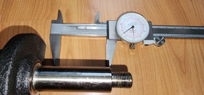

Postby Flagmax » 17 Feb 2025, 01:10

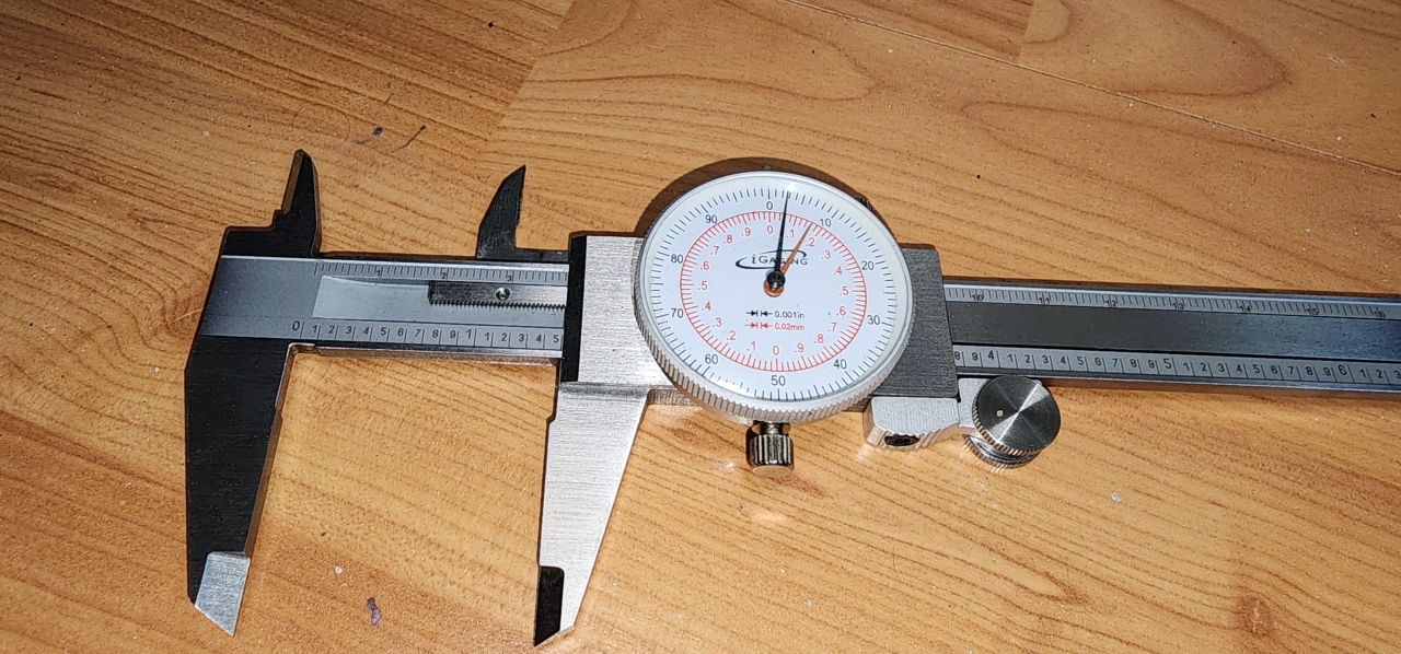

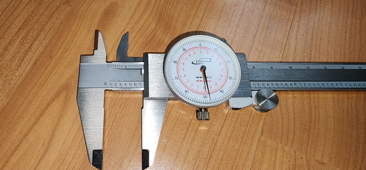

Here are some measurements I took. Looks like 0.75 ID x 1.5 OD bearings would fit but are they available? Maybe need a sleeve?
Forks shaft OD is 0.748in / 18.99mm
Forks shaft Length is 2.165in / 54.99mm
Headtube bottom ID is 1.502in / 38.15mm
Flagmax
Posts: 142
Postby Burgerman » 17 Feb 2025, 01:57
They should be.
Forks shaft OD is 0.748in / 18.99mm likely thats all metric. 19mm.
Forks shaft Length is 2.165in / 54.99mm. And 55mm.
If your 38.15 is correct then its either worn, or very odd... Even if true then bearing loctite would work. I suspect that removing the circlip and that sleeve will see a real 38mm.
