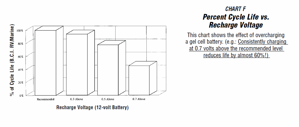

Unless I get the money to buy a ZXD and the time to learn how to use it, I'll have to keep using my mobility charger. The recommended cycle voltage for my batteries is 14.4 to 15V and for float it's 13.5 to 13.8. There's no design temperature or coefficients specified.
Thats not the tech data the manfacturer has thats a maximum wide limits that they dare to let people use. Why wide? Because they are selling batteries to thousands of ignorant batery users that already have generic chargers. So...
They sell more batteries if they say 14.4 to 15 volt. But they dont tell you when to stop, which is AT LEAST as onportant, or how long to leave it on float at that very high wide float voltage either. People dont want to know! That data is a sell sheet. Not a tech data sheet.
Let me show you what MK say about charging their battery.
They say in cyclic use to use 13.8V to 14.1V (MAX!) and so they really mean 13.95V in their tech data sheet. They say that anything above 14.1 voids warranty. Yet their own "sell sheet" says 14.1 to 14.6V.
So, they tell you you can charge 0.65V too high on the sell sheet.
And they are correct. You CAN. And it charges just fine... But they dont tell you that it COSTS you 60% of the cycle life.
But remember that they really meant 13.95V @ 20C in the tech data.
Then in the tech sheets they tell the truth about what that 14.6 less 13.95V = 0.65V too high actually does!
From MKs own tech data sheet.
