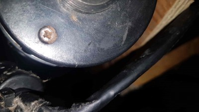

About the black dust. Opening the can would be better but the pozi 1 2 3 dont really fit deep in the front cap screws of the motor. There is probably rust layer preventing to go deep in the bottom. It feels like i would strip them if I try them like that. Also the motor probably has a seal or glue (maybe dried) that would probably not be as water proof after if I open it. The motor works so Im not sure it is a good idea to open it .

here are pict of the front screws
