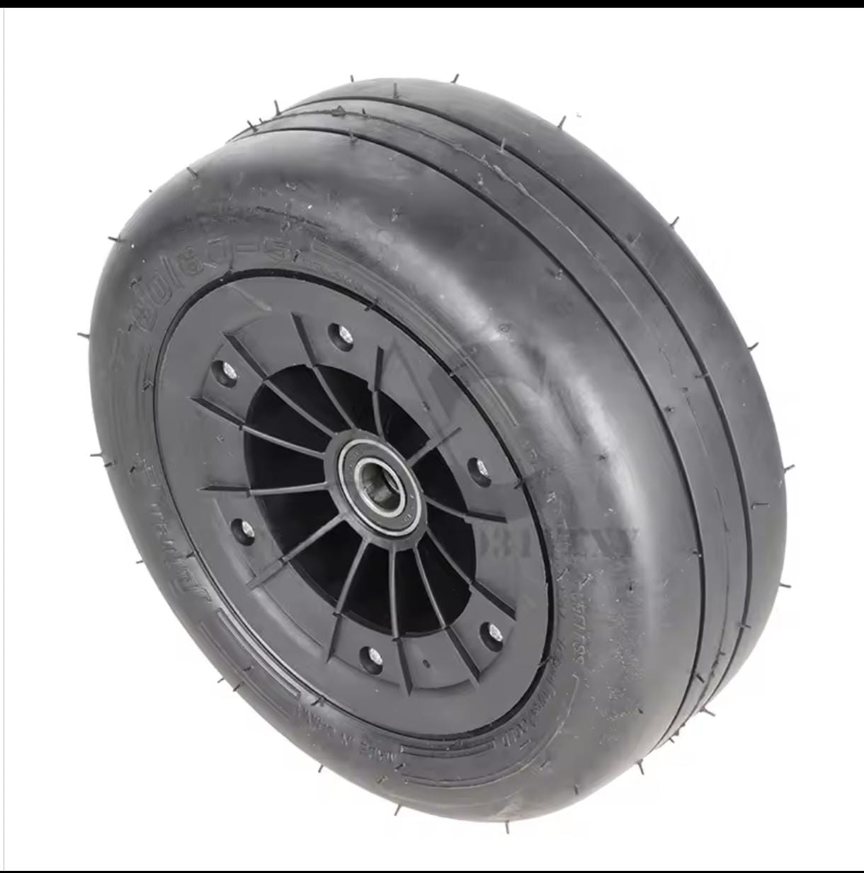

Postby Burgerman » 27 Jan 2026, 09:16
Thanks.
Was looking at the plastic ones a week ago. Same tyre size. Same type. But cheap and no corosion. Should be plenty strong enough. What do you think?
https://www.aliexpress.com/item/1005007156512831.html
All these chinese wheels use 15 x 32 x 10 bearings and need a 15mm shaft.
If you just replace that 6002 cheap ZZ bearing with a 6201RS or 2RS in stainless steel (eBay) then you can use a typical stock powerchairs existing 12mm axle shaft. And a couple of 12mm bore spacers. These are 12 x 32 x 10 sized.
How do I know? I have some on the shelf!

Postby shirley_hkg » 27 Jan 2026, 11:56
Are you sure it is tubeless ?
My aluminum rims costs 25% more, but it looks much better, exceptionally good with monkey bike rear wheels.
Posts: 4653
Re: Punctures!!! Grrrrrrrr
Postby Burgerman » 27 Jan 2026, 12:17
Theres 2 different plastic rims A and B. One is a split rim. With bolts.
That a picture of one. The other looks different and shows no screws. I was thinking it was tubeless. Maybe not?
No bolts...
I do wish they would give more information. We always have to guess.
