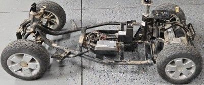

So after reading all this, I am currently at a crossroads and looking for some advice. I built my 3-year-old a go-kart using a "Pride Victory 10". It utilizes the DR90-A01 controller, the wig-wag throttle pot, the speed limiting pot, and the rear trans axle with 400w 24v 4 pole motor. This thing is a tank and runs and drives perfectly...however, he is starting to get used to the speed. I want to upgrade the motor to a slightly faster 2-pole, and maybe upgrade batteries while I'm at it. I know that the DR90 will power everything I need, but not without programming due to certain settings causing havoc with start, stop, battery thresholds, and such.
So I'm trying to decide if I go down the road of paying for a over priced adatper, make my own and hope it all works out, or upgrade to a different controller. It seems that the USB-adapter everyone kept linking to is no longer available to be delivered in the United States.
Any recommendations would be greatly appreciated.

Pride dont make controllers. Scooters are not my thing but the brand is Dynamic. I dont know what programmer that will need.
If you change motors you will want to set motor compensation mOhms for it to work right at very least. And brake voltage.
