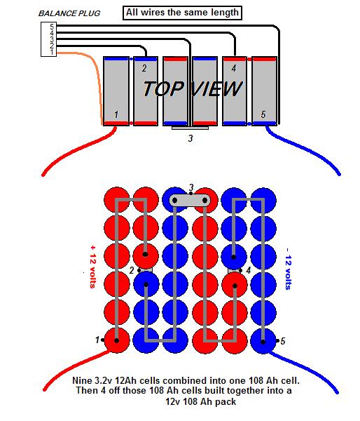

For those that want to do this today, heres how they connect... They just plug together in blocks, like LEGO.
You want two batteries, laid out as shown: 6 cells x 6 cells like this. It will give you a group 24 shaped plock that is 30mm shorter in length. And half the weight:

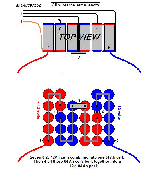

Postby woodygb » 05 Feb 2012, 15:28
B.M.
I've taken the liberty of converting your sketch to a pic and adding in the balance connector.
I hope it's correct and that you don't mind.
lith bats.JPG (56.57 KiB) Viewed 110652 times
Postby Burgerman » 05 Feb 2012, 17:59
Not as good as mine... :lol: :oops:
I am going to steal your drawing! And use it on site.
Posts: 69890
Postby woodygb » 05 Feb 2012, 17:59
Feel free... :)
Postby Burgerman » 05 Feb 2012, 18:03
You could do a group 34 one? (so 6 long and 5 high. So cant be divided by four. Top row not complete...)
Posts: 69890
Postby woodygb » 05 Feb 2012, 18:10
4 off 7 cell packs combined = 28 cells
A pair missing in the top row?
lith bats84a.JPG (50.98 KiB) Viewed 94548 times

Excellent. So nothing now stops anyone from ordering some 12Ah Headway cells/blocks/connectors.
Batt 1 is 240mm high, and 174 wide, and 480 long. And 12v 108 Ah. Equal to 180 Ah of lead...
Batt 2 is 200mm high, and 174 wide, and 480 long. And 12 v 84 Ah. Equal to 140 Ah of lead...
Batt 1 is group 24 approx 75Ah lead sized replacement and will be a straight fit.
Batt 2 is group 34 approx 62Ah lead sized replacement and ditto...

Postby woodygb » 05 Feb 2012, 18:48
Just a note ...and pic ... to say that balance wires can go anywhere on the on the single packs + or - rails ..likewise the main battery leads would be better like this on a 84 Ah pack ..thus the Anderson etc could be folded into the gap left by the "missing" cells.
lith bats84a.JPG (47.48 KiB) Viewed 94540 times
Postby Burgerman » 05 Feb 2012, 19:04
And another note to say that balance wires need to be kept as short as practical. And fairly thick. If not charge time, or the balance at the end of chargeing will take a very long time...

Postby ex-Gooserider » 06 Feb 2012, 13:12
Can you clarify what you mean by "fairly thick?" - Obviously AWG 30 wire wrap is out, and judging by your BM3 pack pictures, you aren't down in the AWG 10 range either... I notice that your pack appears to be using a DB-? style computer plug, and those usually use AWG 24-26 wire in data cable applications, and the cups on the connectors get difficult to solder if putting more than about AWG 22 into them... The balance connectors I got with my Hyperion are very short, but look like they are only about AWG 26...
So what would you consider adequate / appropriate? I'm assuming that the charge and balance cables are likely to end up being 3-6' in length just so that the place where I'm parking the chair and where I'll be putting the charger setup can be easily tied together...
Posts: 6197
Postby Burgerman » 06 Feb 2012, 14:23
There is no correct thickness. But the longer they are, and the thinner they are, the slower the balance works, due to resistance. I use the size that the hyperion balance board come with for the first few inches, and step up to "the next size up" on the way to a 16 pin connector. Mine are a bit small, because I needed to get 14 wires in a loom and it adds up! This is 18 inches long. On the battery side I use the same wire, found on my bench, and all kept as short as poss, maybe 14 inches?
If balance leads are longer than about 3 feet then they need to be bigger. Double the length needs double the x section. Same with charge leads. Its best to have the charger sat on or sat right next to the chair.
Posts: 69890

This is excellent information.
I know this thread is about directly swapping 'normal' 2x12v battery setup to lithium but it could be so much more...
I've been playing around with Woodygb's sketches and these cells allow for so many layouts, provided you keep the 8 (2 x 4) cell-groups to get 24v.
Using 6, 7, 8 or 9-cell groups gives you 72, 84, 96 or 108 (lithium) ah packs.
Imagine 'someone', say 'a manufacturer' just for a laugh, came up with a modular design that lets you add the motors & wheels, casters, seat and armrests to the battery box that suits your needs best, with that battery box being the structural base frame.
You'd transplant the parts to a new battery box with more cells as you grow (kids could even start with less ah I assume) or as your budget or mobility needs change...
It's basically the BM design without the tubular frame but with the casters and seat to be attached to the battery box as well.
You can choose a layout based on your budget, your size, your activity... anything really.
Place them in 1 18cm row with fat tires for grip or small tires for kids' size chairs... more rows in a wider, more 'classic' layout, ... anything goes really.
Parents would be able to get their kids the exact fitting chair without having to worry about coughing up another 15.000£ in 2 years, a bigger base battery box & some screwing/unscrewing will do.
Anyone else can change to bigger motors, a different seat, whatever, whenever you want without having to buy a new chair...
The batteries will probably outlive the parts too, right?
Manufacturers, call people here! fire the committee. :)
