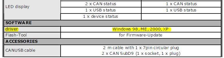

Twinpanther, your Pride/Quantum USB cable should work with 1314 PCPS.
Try 32 bit system.

Postby Twinpanther » 11 Apr 2012, 20:43
Yup, been playing with CANexplorer 4 but only allowed DEMO mode and it is a bit over my head as having never played with anything like this before.
I tried running it as XP but it was a no go and since I have to fix my mother-in-laws laptop I'll install it on that after I get a fresh XP 32bit installed on it to see if it helps/works.

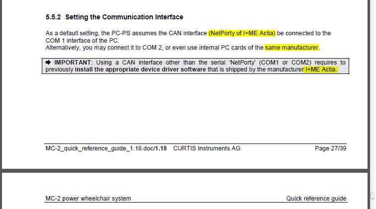

Postby gologen » 12 Apr 2012, 18:58
Thank you woodygb for link.
And just info from manual "Curtis MC-2 power wheelchair system" from 1314 PCPS Help-System documentation.

Postby gologen » 12 Apr 2012, 19:30
Ukrainian.
woodygb wrote:Any suggestions on a "universal" dll?
1314 PCPS has own output parameters. NetPorty dll has same input parameters.
Other devices have own dll's. Every dll has different input parameters from 1314 PCPS.
In my situation i wrote middle dll between 1314-output and "my_device".ddl-input

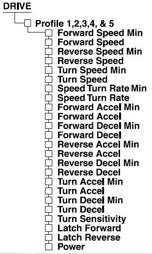

Postby woodygb » 12 Apr 2012, 22:31
Probable missing parameter...
Derived from this ...Q-logic parameters.
