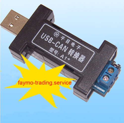

Postby Seajays » 24 Apr 2012, 20:10
This one or the one that Woody posted.
http://www.ebay.com/itm/USB-CAN-USB-CAN ... 062wt_1141
Seajays
Posts: 1201
Joined: 13 Apr 2010, 18:25
Postby gologen » 24 Apr 2012, 20:15
This is same i have
gologen
Posts: 112
Joined: 11 Apr 2012, 12:46
Location: Toronto Canada
Postby Seajays » 24 Apr 2012, 20:23
Gologen, I will buy the same device. Please send me your Dll, much appreciated.

Postby gologen » 25 Apr 2012, 01:23
Today I tested my USB-CAN device in Windows 7(64). When i connected USB-CAN to USB port Windows found and installed usb-serial driver automaticaly. I run program 1314 PCPS with no problem.
So: 1314 PCPS + my dll + USB-CAN can work in Windows 7(64).
I want to post my dll file on this forum. May be it can help somebody.
So if you have or planning to buy this device
You can use this file to get connection 1314 PCPS to curtis controllers with CAN-bus.
Name of this file is LXN4py2s.dll. You should unzip and copy this file to program's folder (C:\Program Files\1314-4401 PC PROGRAMMING STATION\) and change original LXN4py2s.dll (NetPorty driver).
Next. You should copy file QM_USB.dll (USB-CAN driver) to same folder. You get this file from seller when you purchase USB-CAN device.
Other steps to get connection to controller you can find here:
http://www.wheelchairdriver.com/board/viewtopic.php?f=2&t=1965&st=0&sk=t&sd=a&start=216
Before you start download please read:
1. My dll doesn't use all functions of original NetPorty. Just only functions used by 1314 PCPS. So. It is not full analog of NetPorty and cann't be used in other applications.
2.File was tested in Vista (32) and Windows 7(64) only. I guess, it should work in other Windows, but i didn't test. Who will test please post results.
3. I wrote this file for my own needs and i didn't use the protection from misuse (with other devices and without devices it can give crash of program). I got needed results and i stop work on this project.
4. And last one: You use this file AT YOUR OWN RISK
If you read and agree, please download and use it free:
LXN4py2s.zip
(48.47 KiB) Downloaded 1488 times
If somebody will be interested in my dll for improving or for make his own dll i can send original code of my dll file (It was written in Delphi 7).
