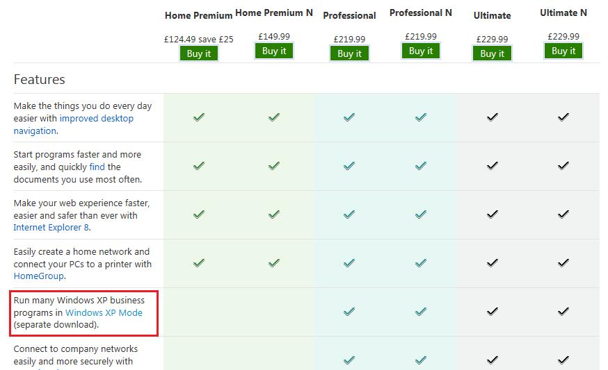

NO idea if it will help ..but I have seen this fix/solution referenced for Curtis 1314 connection problems using Win 7.
http://windows.microsoft.com/en-GB/wind ... ws-xp-mode
Postby gologen » 16 Jun 2012, 15:44
It's applied to Professional, Ultimate or Enterprise editions. But most of computers in retail have Windows 7 Home Premium edition.

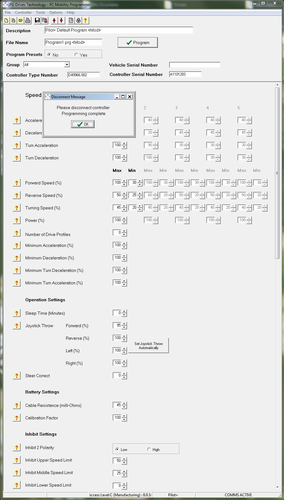

Postby Burgerman » 16 Jun 2012, 16:24
Note Active comms bottom right...
And serial etc. And access level C (OEM) all good and for the price of a USB cable thanks to woody...

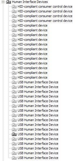

Only COM 8 has to be a Win 7 config prob.... perhaps some other previously installed prog has somehow marked the other COMS ports.
I "unhid" all my devices in device manager ... due to all my new installs insisting on picking a HIGH COM port number.
device manager / view / show hidden devices
This showed that I'd filled all the previous numbers with various installs ...many of which were no longer required.
I then deleted the COMS assigned to the greyed out ones ..( they'll re assign when you plug them in again )

Here's a pic of my unhidden Human Interface Devices .... Seems to be everything I've ever plugged in!
But only one is actually in use...the optical mouse.

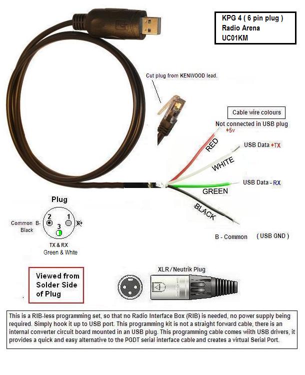

i was looking for that cable here in the states - this is what i have found - is this the correct cable if i wanted to try to make one later on down the line ?
http://shopwiscomm.com/Kenwood-AFTERMAR ... 11484.aspx
i would need the XLR connector and then solder the wires as in the picture posted ?
green and white wire soldered together - black is ground on pin 2 -- and pin one would be nothing ? the red wire is left alone or has to be connected also ?
Yes ...follow the pic ..you have the colours correct and ignore the red.
