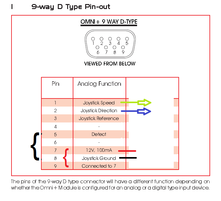

Some questions about the Omni.
Can you remember if the Omni 9 pin plug wants a Joystick reference voltage of V/2 = 2.5v on pin 2 ...OR ...is it supplying a voltage of 2.5v ?
Also the 12v supply pins 7 & 9..is it 12v EXACTLY? ...and would you... or others want/need the ON/OFF that is available via the 3.5mm Jack plug ?
Re: Plug & Play PGDT R/C
Postby Burgerman » 15 Jan 2014, 20:55
This is from 2009 memory...
I didn't measure the 12v as I just used a voltage reg chip and a tiny cap to stop any ringing. To give me 5v. for rx and for tiny speed controllers. These were used for a low current signal. No smoothing. They work anyway.
I don't think I used the ref pin at all, and just used 2x forwards only 2amp speed controllers. These give a 5v swing so 2.5 in the centre. Swing reduced with resistor network, and tiny 20 turn trim pots to get accurate end points and an exact centre. Which turns out to be a few tenths of a volt higher than 2.5v...
The on off is used. I can drive the chair into the van, or garage and flick a switch to turn it off. For good. As this removes the rx power too. Add a separate rx battery, or supply, and you could turn it on again too.

Postby woodygb » 15 Jan 2014, 21:37
Cheers that means I don't have to worry about producing a voltage reference for the Omni.
I was considering using the 12v as a power supply ..but it maybe marginal @ 100mA... fine for just the Arduino board ( it has a small on board regulator that takes 12v MAX )... and a couple of led's but I'd like to power the R.C. receiver from the same source....so I'll keep with these that I bought from Ebay ...rather than tempt fate.

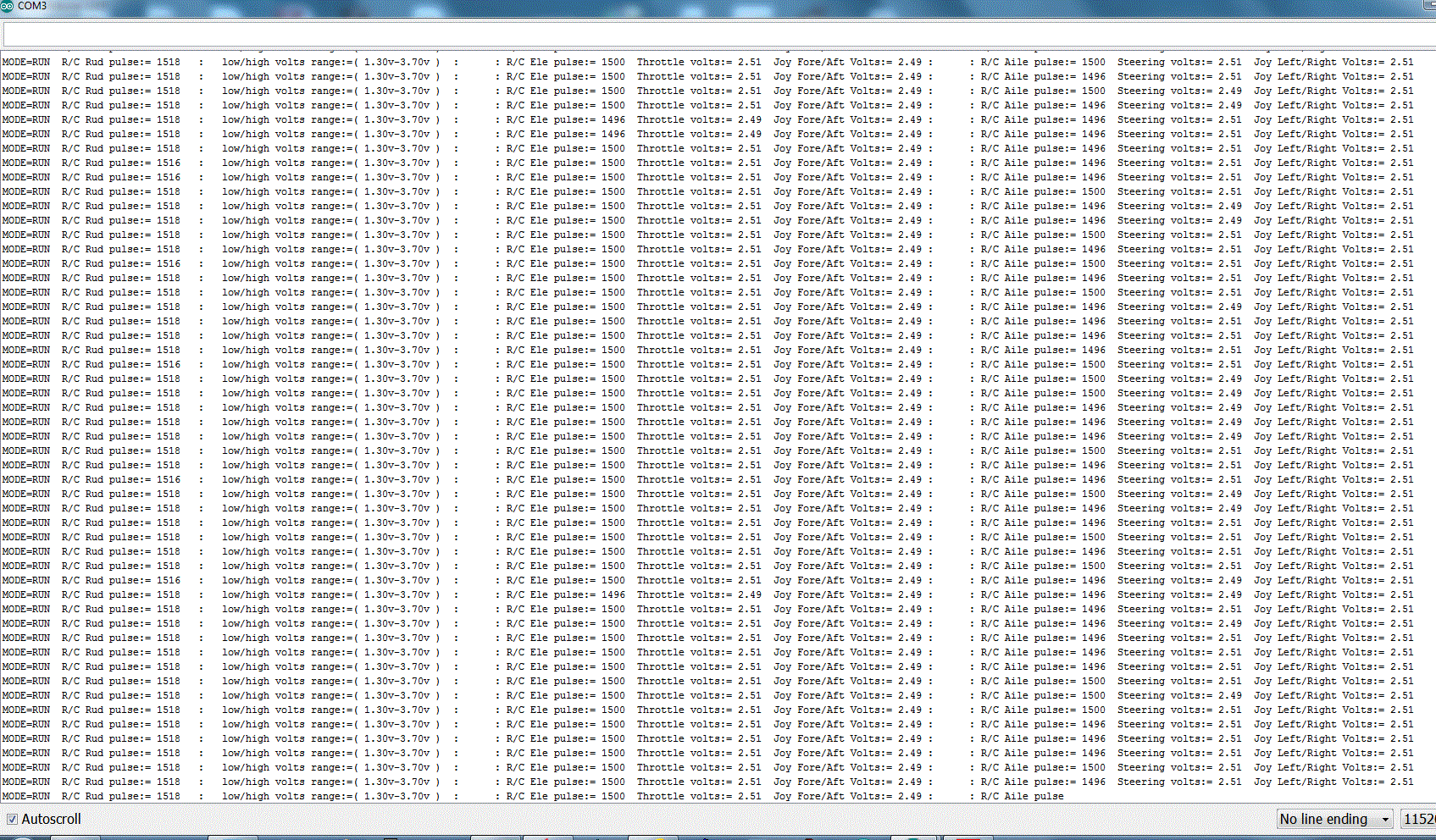

HOPEFULLY ...It should be a case of plugging in the Aile and Ele of the RX and probably another channel for ON/OFF...currently it's Rudder.
If necessary set the transmitter to 100% throw with NO offsets or trims etc ...
Then turn on the Transmitter / Receiver/Arduino ...
Press a button on the Arduino board ...move the transmitter Joystick to it's extremes in vertical and horizontal ...this reads and writes the neutral and end point values to memory ... ( you have 10 seconds to do this and you can repeat the procedure at anytime if needed ).... then plug the 9 pin Din into the Omni and with a bit of luck the Gismo should control the chair.
Here's a pic showing the Serial output from the Arduino .
Programmed end points .... 2.5v centre with a 1.2v swing.. so 1.3v and 3.7v as the end points...
I currently have BOTH a R/C Transmitter and an old PGDT Analog Joystick inputting to the Arduino.

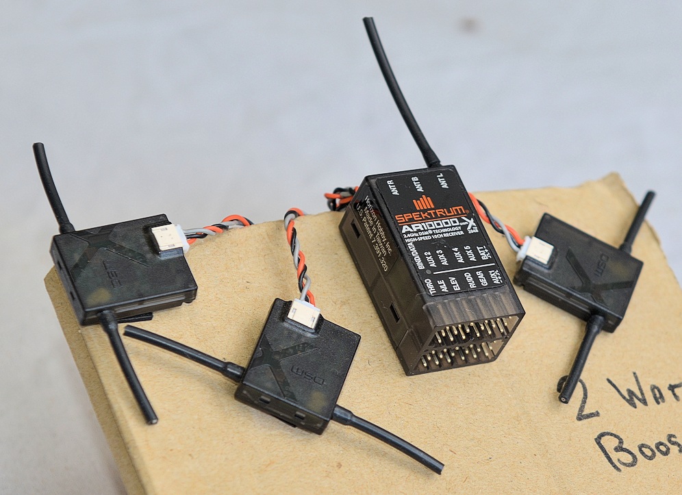

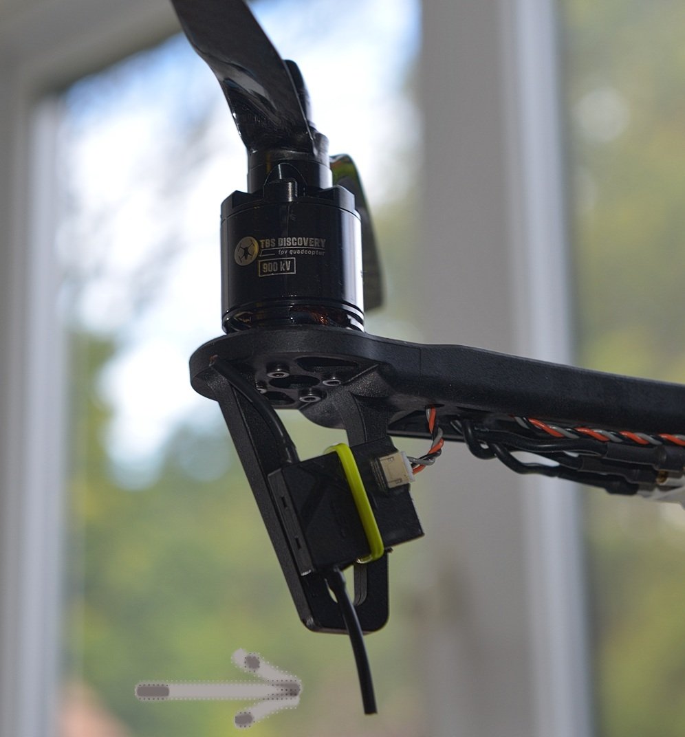

I use these.
Main receiver has an antenna.
3 additional equally sensitive recievers, allow you to put them in different planes (polarizations) and away from the structure or metal in a wheelchair.
I put the MAIN receiver at the front under the wheelchairs seat pan. This one gives the worst results. If used alone I get signal losses at various angles even in the next room 20 feet away.
I put the other 3 on long cables.
1 in the rear light (plastic and above the frame) or high up in the seat back fabric pocket where it sees the best signal.
And the remaining 2 go either side of the seat under the seat tray near the edge.
In this way I can rotate the chair 360 degrees and always see a receiver one way or another.
The chairs metal works as a very affective faraday cage at 2.4ghz. So using 1x rx unless you are very close to it you will see signal dropouts and failsafe often at various positions. Even putting a rx close to a metal chair reduces performance markedly.
Also it pays to know which is the ACTIVE antenna, and which is the ground(plane). See picture of quad with arrow. The antenna pointing down is the active one. This gives at least DOUBLE the range than fitting this RX the other way up. There are 3x remote RX's on this quad. I get reliable safe operation with zero complete signal losses at 3 to 4 miles away with this same setup on my power glider. (http://www.wheelchairdriver.com/12x.htm boosted transmitter)

I can just configure the voltage output in software rather than adding resistors... I can also add in led indicators ..I currently have a pair of 5mm Tri colour led's ... one for each channel...on my desktop test rig to indicate Neutral ( RED ) ..Forward and Left ( BLUE ) Reverse and Right ( GREEN ) .... plus one 3mm to indicate when the configuration button has been pressed.
The BLUE and GREEN come on when the preset deadband is exceeded...this is currently 1560 and 1440 with the R/C signal spread being from 1100 <-1500 ->1900...
They led's could easily be left out ...but I find it convenient to have a visual cue as to what should be being output.
The pod interface setup that I'm trying to perfect is much the same.... the Arduino becomes an Omni type interface ..in that it accepts signals from the R/C and the Pods joystick ..in that case I have the pods joystick deadband set slightly lower than the R/C signal deadband thus input from the pods joystick will ..via software ..always have preference over the R/C transmitter.
