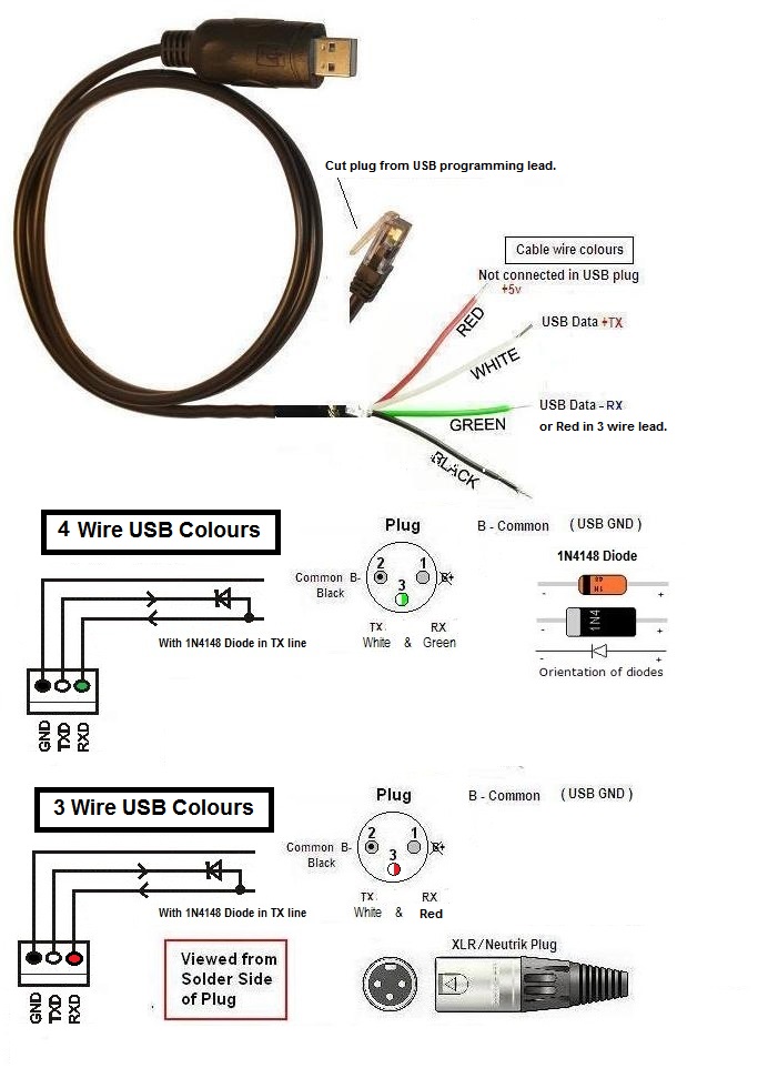

Postby segreen » 08 Feb 2014, 11:48
Just bought a new Kenwood KPG-4 Replacement USB RIB-Less Programming cable http://www.radioarena.co.uk/index.php?_a=viewProd&productId=628 and after cutting the plug off it I find it has only three wires, Red, white and black - no green wire. Is this right and if so which wires then connect to the pins of the neutrix?
Thanks Steve
segreen
Posts: 530
Joined: 07 Feb 2010, 20:31
Location: Bolton, Lancs. UK
Re: PGDT interface update
Postby woodygb » 08 Feb 2014, 12:46
The wire colours vary depending on the whim of the Chinese / Korean supplier.
It's probably as shown in this pic.
GND = Black
White = TX ..put the diode in this line.
Red = RX
The alternative is to pop the case and put the diode inside across the TX and RX pads .... see this thread.
Then you only have two wires GND and a combined TX & RX.
viewtopic.php?f=2&t=3848&p=50080#p50080

Maybe I soldered the XLR plug wrong?
The picture says it is viewed from the solder side of the plug, so I soldered the TX and RX to the left pin on the solder side. This is the right pin if you look at it like a normal plug.
correct?
