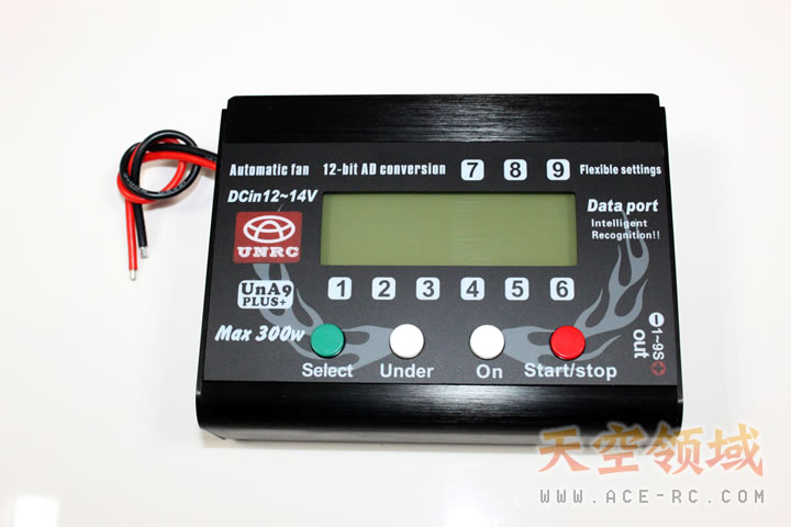

Postby shirley_hkg » 25 Jan 2014, 14:09
Have been looking for charger with at lease 8 individule charging channels , and finally get one.
UN-A9+ is capable of 9 cells at 8A max.
Now battery is charged to 28.2V through a BMS, which has over-charge cutout at 3.65V , during normal routine charging. Then use UN-A9 to balance the cells once every 4-6 weeks.

Postby Burgerman » 25 Jan 2014, 17:31
Why not scrap the BMS before it does damage, and use the 20 Amp Hyperion 14 cell 1420i, or the 30 Amp 8 cell 730i? Or the 8 cell celpro 1300 watt charger?
And charge with these full time?

Postby shirley_hkg » 26 Jan 2014, 06:28
:) UN-A9 charges with individule channels ; that is balancing current is the charging amp --ie 8A max. 8-)
Posts: 4481
Postby Burgerman » 26 Jan 2014, 10:16
Really? But that would melt the tiny balance wires and connectors on every hobby pack?
Posts: 69895
Postby shirley_hkg » 26 Jan 2014, 14:10
:) I tried 5 amp for 7 hours and feel just a slight warmth on the wires . :D
Posts: 4481
Postby Burgerman » 26 Jan 2014, 16:13
Not sure how safe that is...
But that would be OK for charging my transmitters etc.
How much? In UK pounds? And is there any specs anywhere in English?
Posts: 69895

Postby Burgerman » 26 Jan 2014, 21:35
Do you think charging or balancing at 8 amps down less than pin sized wires and equally tiny connectors is a good idea?
If I charge via a balance connector as I do on my RC transmitter, they get quite warm enough at 2 amps!
If I charge at 30 to 40 amps, from my power supply to my chair, the 10sqmm cables and big Anderson connectors get very warm. That's massive in comparison. At least 20x the cross section.
I would have thought that 3 to 4 amps was pushing your luck.

Postby shirley_hkg » 27 Jan 2014, 12:03
Burgerman wrote:Not sure how safe that is...
This seller speaks English , and it sells at US$ 66.00

Postby Burgerman » 27 Jan 2014, 13:35
http://img01.taobaocdn.com/imgextra/i1/ ... 447737.jpg
There are 3 items plus a small connecting board.
What are they.
Power supply (OK), Charger (OK), and the 3rd thing covered in connectors?
And does the price include 1, 2 or all 3 things?
And...
Are all the grounds connected? So could it be used as a pair to charge up to 18 cells without smoke? And is the firmware / software any good? As in is it flexible?

This is a nanny which extends the charging flexibility and adds discharge feature to UN-A9.
Price is for charger only; nanny and power supply are sold seperately. Complete set cost US $120.
Posts: 4481
Postby Burgerman » 28 Jan 2014, 15:45
Shame no 14S version - be useful for balancing new or stored packs.

Postby shirley_hkg » 29 Jan 2014, 12:54
Good tools for 24V user. ;)
Posts: 4481
Postby Burgerman » 29 Jan 2014, 14:00
Yes for either balancing or small hobby packs.
If it really balances at 8 amps.
I am tempted to try one for my hobby stuff. So I can plug in many assorted 2, 3, 4 and 6 cell packs at once.

Postby Burgerman » 29 Jan 2014, 14:01
I am tempted to try one for my hobby stuff. So I can plug in many assorted 2, 3, 4 and 6 cell packs at once to save time.
I do this now with the Hyperion and the thing has a nervous breakdown. It gets there in the end but it takes time.
Posts: 69895
Postby shirley_hkg » 29 Jan 2014, 14:19
8 AMP should be used for short time. I tried 5 amp for over 10 hrs and it does not get hot. Seller recommends 6.5 amp max for prolong charging. ;)
Burgerman wrote:Shame no 14S version - be useful for balancing new or stored packs.
GET 2 ! :twisted:
Posts: 4481
Postby Burgerman » 29 Jan 2014, 14:50
Common grounds mean it wont work on 10S helis, or 13S powerchair without smoke.
Posts: 69895
Postby Irving » 29 Jan 2014, 21:42
Burgerman wrote:Common grounds mean it wont work on 10S helis, or 13S powerchair without smoke.
Nope, you have to split stacks into packs of 2 - 6 cells.
Postby Burgerman » 29 Jan 2014, 22:02
My chair is 13s doesn't split. Heli packs 10s doesn't split. Many ebike and scooter packs are 12s and don't split. So it wont work for me or them.

Postby ex-Gooserider » 29 Jan 2014, 23:49
If you got two, it might be possible to figure out how to "float" the grounds on the second unit so that you could put them in series... Sort of along the same idea as how some folks will float the grounds in PC power supplies so that you can connect them in series for more than the usual output voltages...
Posts: 6197
Postby Irving » 30 Jan 2014, 12:40
ex-Gooserider wrote:If you got two, it might be possible to figure out how to "float" the grounds on the second unit so that you could put them in series... Sort of along the same idea as how some folks will float the grounds in PC power supplies so that you can connect them in series for more than the usual output voltages...
could probably work if the common ground is wired back to the -ve supply input and your power supplies were floating outputs and you only did one stack... so second unit 'ground' would float at voltage of first part of stack. then again it could be a recipe for letting magic smoke out.... :roll:
