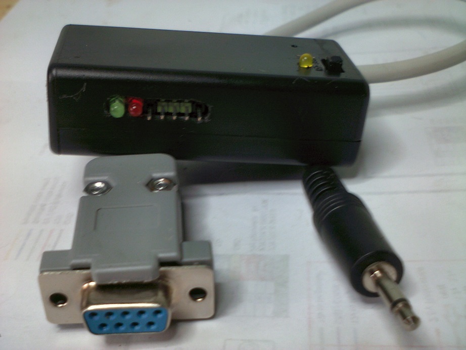

Pic of finished interface.... just some R/C servo cables to purchase and perhaps a cheap label making machine.
@ mous3 ... Your programming cable is "fixed" the diode was placed in the correct WHITE coloured wire according to my pic ...BUT ...the Chinese manufacturers do not follow any specific rules :x ..so they had decided to have them the other way around.... thus the diode needed to be in the RED wire not the WHITE.
I've also had your VR2 apart ...much easier to work on than the VSI....and there shouldn't be any major problems with building an interface for it.
