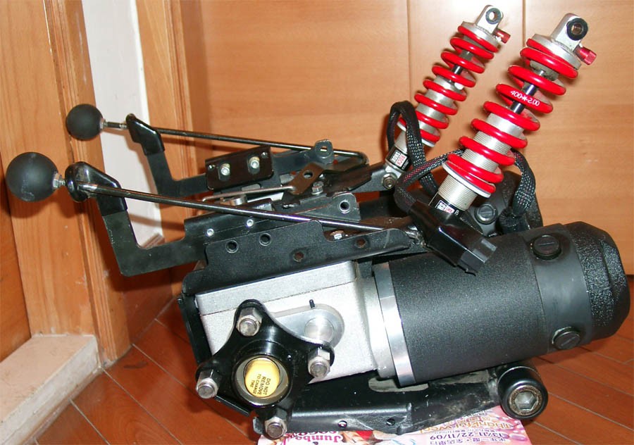

You could cut it, and turn 2 round blocks, and drill and tap 3 M8 bolts to hold it in position. With a third tapped hole in the end to hold your new centre section.
No welding needed.
Like this, but with 3 holes drilled and tapped into the sides through the tube of your frame.

Now I see the most difficult part is that no motor will be short enough to fit behind the V shape structure, not the motor bracket .
The other candidate is Permobil Street , which inspires the WillChair .
