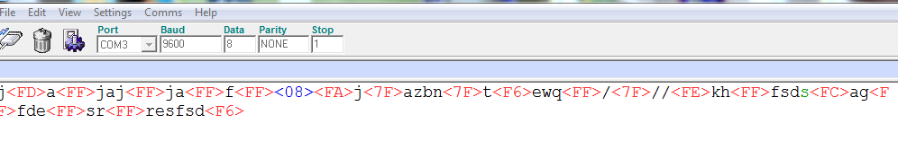

FT232RL .
I put a resistor 47k and 10k. An error no com port
vinsen
Posts: 79
Joined: 28 Dec 2013, 09:41
Location: Russia
Postby vinsen » 11 Jan 2015, 01:39
vinsen wrote:FT232RL .
If you make a connection - are the terminal data. When the cable is connected to the controller - The figures do not go.
