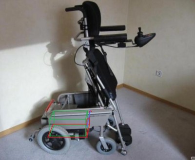

Postby nealnlx » 23 Nov 2015, 22:39
shirley_hkg wrote: Better post pics of your chair here, pics on all sides and in various positions of seat.
Preliminary, a small add-on will double your existing range already. Is it enough ?
Hi
I dont have pics of mine but after some search found some online the are the same. Well, the footrests and the armrests are not the same but e are not working on those parts so it doesnt matter. The rest of the wheelchair it pretty much the same.
Ill show some pics...

Postby nealnlx » 23 Nov 2015, 22:59
and finally the last pic...
The joystick is the same, the battery charger is the same, everything is equal the same.
You can see how it is when standin. I dont kno if that one is fully up but if it is mine goes even straighter.
Also found some pdf's showing the battery case and compartment from where i toke a few screenshots.
As you can see the black box sits on the metal frame which sits on the wheelchair frame.
The batteries can be mounted on boths ways, straight or sideways and it still lefts a bit more space.
I dont know the exact measurementes of the inner part of the wheelchair. Like from side to side, from motor to motor, but if i can gain a couple inchs there i can modify that metal frame to make it wider and possibly longer to fit a bigger configuration.
That the easier part for me...

Postby nealnlx » 24 Nov 2015, 22:31
You are verry right on what you are saying. I agreen with that.
In a lack of the presence of my chair so i could show you better ill post a couple of pics so you can maybe understand what im trying to say and do.
So as you can see the pictures its pretty simple...
All that is prety straigh foard to get out by hand. I think only the battery support frame has a fe screws but nothing major. Its just to make it not shaking and kep it on place when going on litle bumpy roads.
Nothing of that interferes with any available function and overall chair size.
For making it more scape capable and therefor more battery capable as well, the only thing i would do would be making the battey support frame as wide as possible untill it closely but not touching motor, and make it longer. So in the end insted of, lets say, a 16 by 12inches i would have maybe 20 by 14 or 15 inches if possible. That way i could pack in a lot more battery and would have the same everything since i never touch the chair's frame and structure it self.

Just an bit of a pics for you to see. My chair needs a back rest that is around 140euros, the two crapy lead 12v 26a batteries he sells around 500 euros both (i see them fifty bucks at ebay and amazon all day long), new original battery charger from the chair arround 270euros, and to reprogamm my conttroller unit a PGDT VSi is arround 600euros. Now watch the magic thing, total of the cost rapair is 2000euros.
On this on you can see it from the back prespective.
Blue bar is the chair's frame that goes from side to side, red metal battery frame siting on the chairs frame by two round hooks as shown on the profile view. And finally the green bettery it self sits on top of that red frame.
Here on profile side you can see represented by green colour the battery box, in red that metal frame shown on above pics and thats where the battery box sits. And that litle blue line is a bar of the chair's frame where the baterry support metal frame sits.

Do you have 4x 12V 26Ah batteries at the moment?
Its trivially easy to fit a large lithium pack where a group 24 70Ah battery is removed. With smaller batteries it becomes more difficult to effectively use the spaces.
What are the EXACT dimensions of the 4x battery areas that you have?

For as much as i want to tell you the exact dimensions i cant because i dont have the chair with me. Is the that on store and i asked the guy monday to tell me those dimensions and still no response.
As seen on some pics above i have just 2x 12v 26ah batteries. Yes, just that short range.
But as i also said before, the black box that stores the batteries still have some room.
I think in total it maybe arround 40cm l x 30cm w x (nearly) 20cm h.
Again, this i can change and make it longes and wider as much as it can untill it goes from side to side close to the motors.

If my battery box have like 40x30x18cm , i could get in there as muchs headway cell as i could.
I seen you kind of recomending the 12a ones more than once, and if i could i would even go for the 15a ones. But due to my dimensions and if i dont change the black box case i may probably fit in the 10a ones in a bigger quantity.
When they measure around 12 to 14cm i could fit two rows (in a sideways possition) lengthwise. And maybe would be like 10cell long by 4tall. Making it two times would be 80 cells total like 40 side by side.
