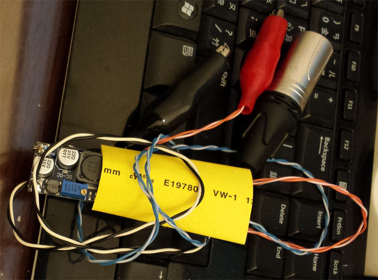

Regarding your initial balancing, I'll include a DC-DC power module to bring up lagging behind cells to 3.6V.
One by one , though a bit slow. ;)
Your money has paid for it. :lol:

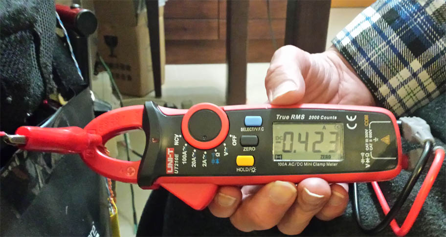

Tested on my 80% full battery STILL capable of 423mA . :D
Powered from your own chair.
Posts: 4568

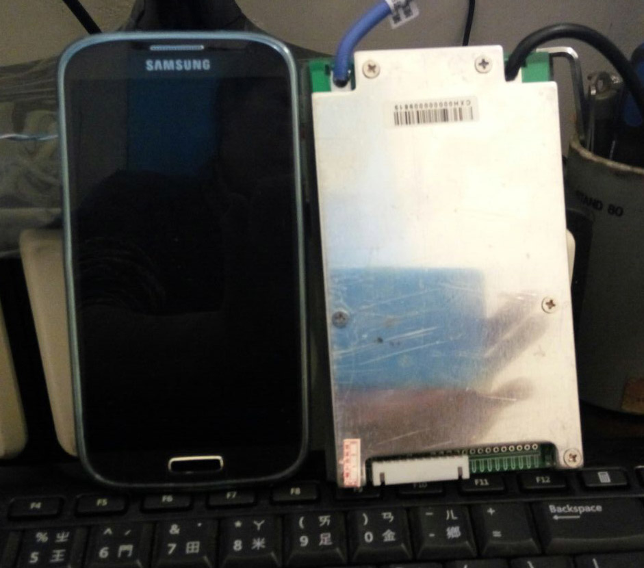

Shirley - i never asked you before - i wasnt thinking - is this BMS you are making for me - how big is it ? etc, - would i be able to tape it to the side ? which then makes it wider -
about 5 inches wide when all done ? i know its about 12 inches long by 8 high approx. -
It is the size of my S4 . :D
Posts: 4568
