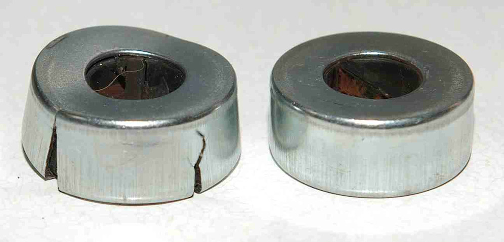

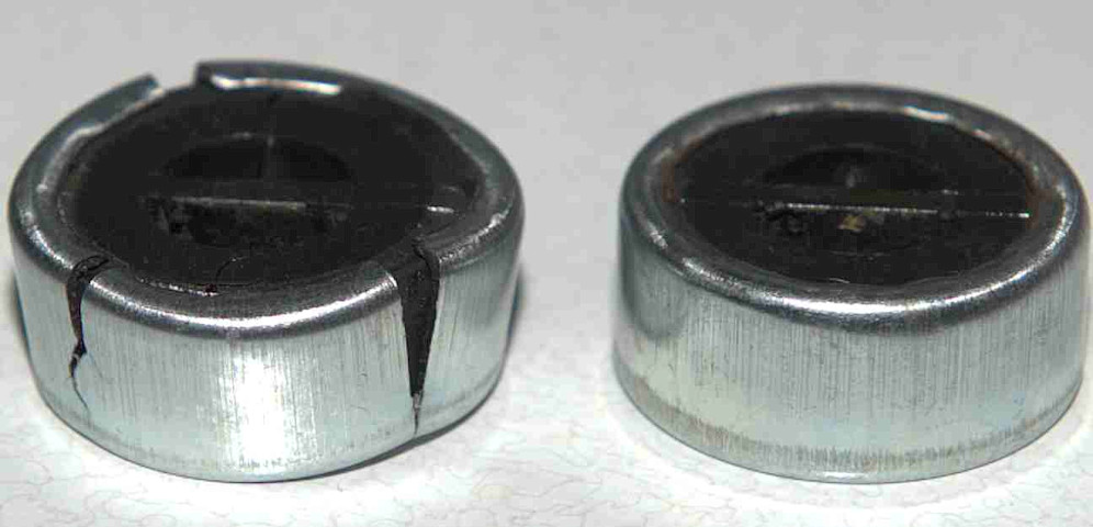

Stock powerchair motor couplings, on most powerchair motors, or rubber cush drives if you prefer, fail with monotonous regularity. As soon as you fit decent low resistance batteries (throw away those gels), fit decent wiring, and program the chair to turn, stop, and go.
I have a draw full of these failed ones. From 3 different motor manufacturers. It feels like a gearbox failure, but in reality its a £2 part... Most are similar. What happens is that suddenly you put some real torque through them. And the outside case splits, jams under load as it expands.
I fix these now BEFORE they can fail.
The problem: (Good one on the right...)

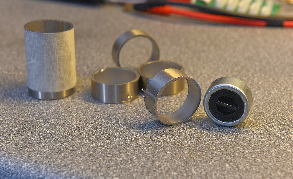

The fix.
EBay for a short bit of stainless steel or steel tube. The CORRECT size so it is a push fit (with a hammer) over the weak cush drive. And cut a few 11mm long slices. That virgin cush drive is from my brand new motors.
Posts: 70424
Re: Rebuild BM2 green...
Postby Burgerman » 21 Nov 2015, 20:25
Put cut tube over the cush drive, after coating in 5 min epoxy, and tap on with a hammer...
Posts: 70424
Postby Burgerman » 21 Nov 2015, 20:26
Once set, file the sharp edges off, and refit!
I have not done either of those here! Yet.
Now it cannot fail. I win.

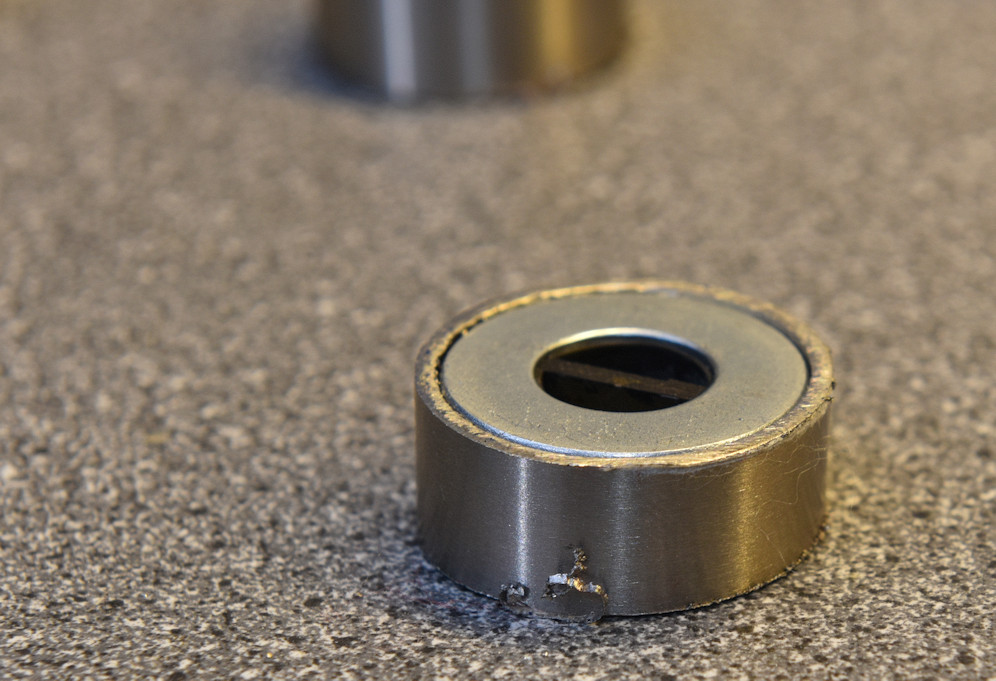

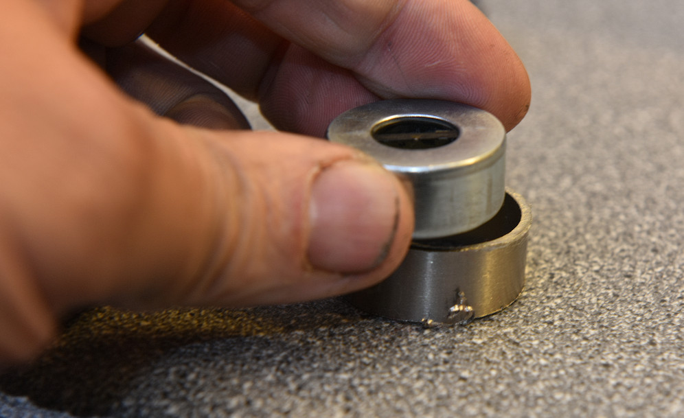

Postby Burgerman » 25 Nov 2015, 15:56
And another!
This is a destroyed cush drive and some friends from my draw from years ago.
When did you last check yours :D :roll:
Pushed together in the vice. Before filing.

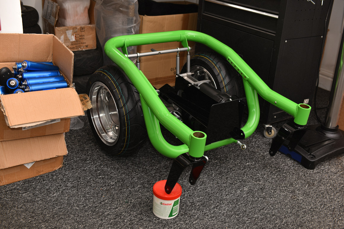

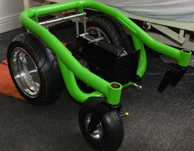

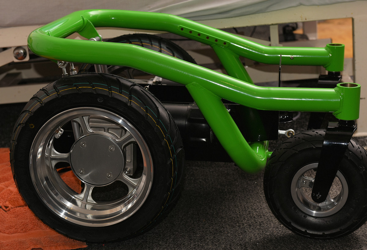

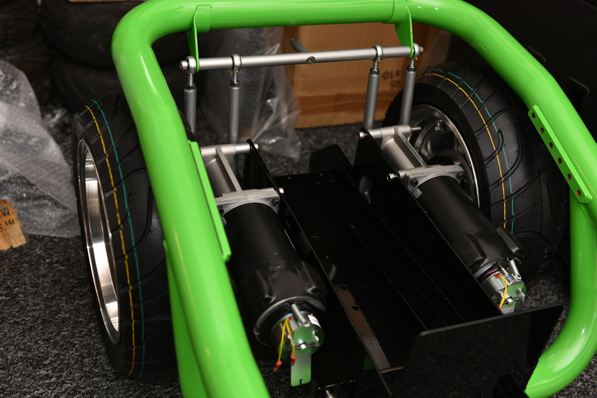

Postby Burgerman » 19 Dec 2015, 14:32
Cush drives installed.
And now motors fitted...
The snot green chair is growing on me... And yes tyres are backwards. Temporarily fitted. The wheels need swapping left/right. After they are polished.

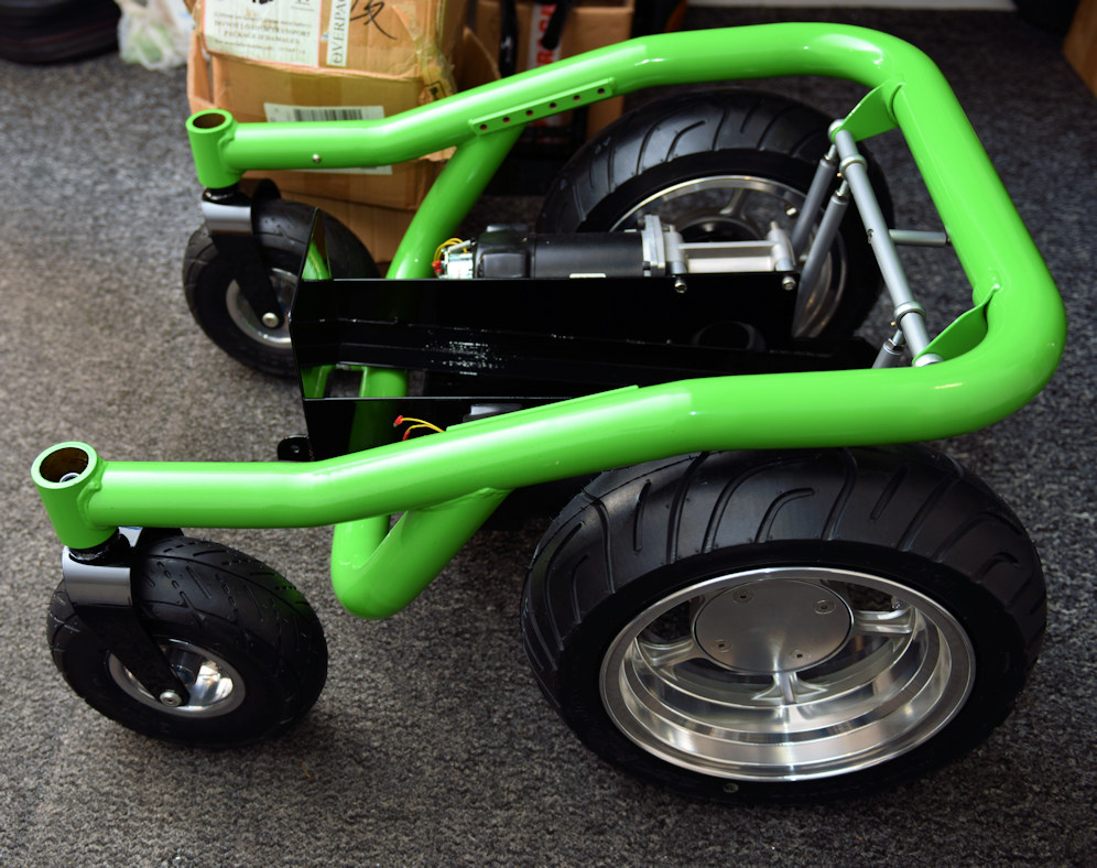

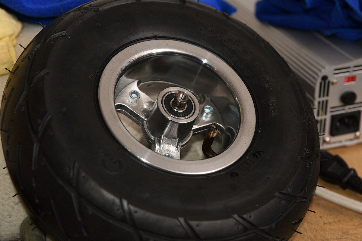

Postby Burgerman » 20 Dec 2015, 17:18
Front wheel now polished alloy to match the rear wheels. Sat in approx. correct place with a long thin screwdriver as axle...
I spent this morning polishing the metal caster wheels. :shock:
They were old, powder coated, and corroded and dull. All I can say is my fingers now hurt!
And I will regret it in the long run as they will corrode and go dull again so will need repolishing periodically. That's why I normally powder coat everything. But this chair is supposed to look pretty too.
Note the night bags dumped on the floor! :oops:
Distorted and shortened because of camera being too close and high up. and because I made a mistake resizing it I think! This makes it look short and wheels not round...
The other wheel, also polished. Needs stainless round head Allen bolts (if I don't countersink the bolts), and a black or alloy valve cap. And rebalancing - not that it matters much on a slow chair, but I feel better having it right. A 14 year old wheel "rejuvenated"!
Posts: 70424

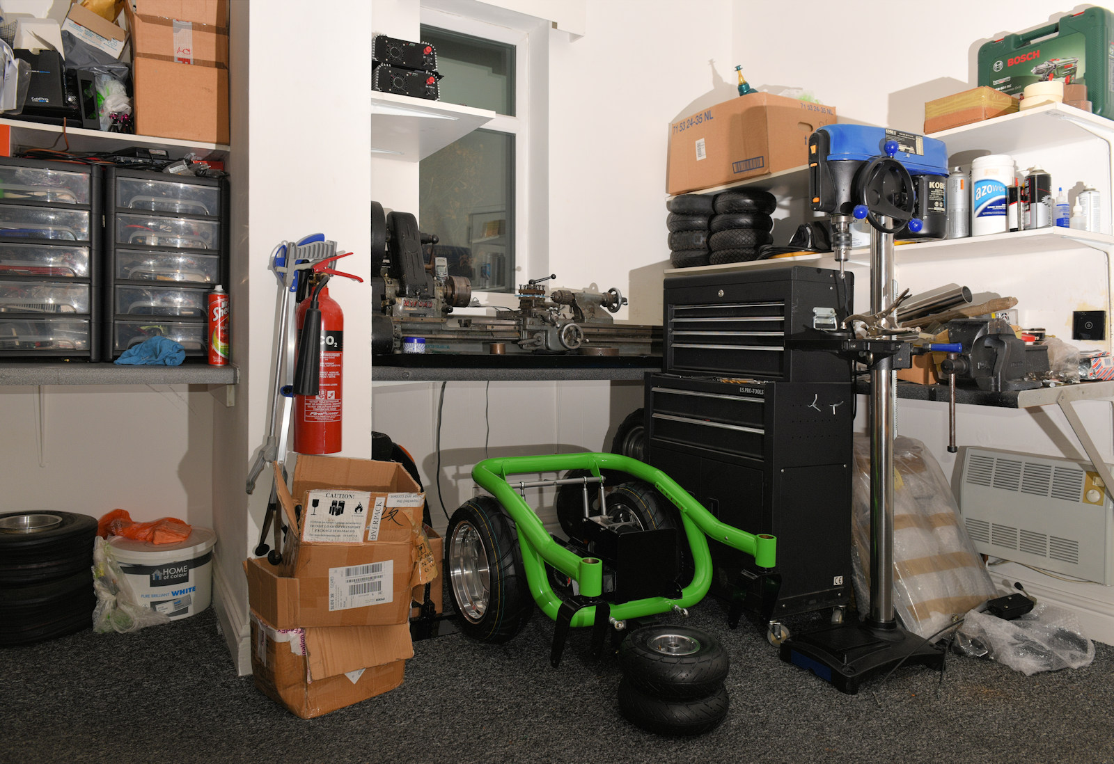

For anyone wondering what the corner of my bedroom where I build chairs looks like, heres a pic!
Note fire extinguisher, and my bench drill now is floor standing. (I bought a stainless steel 60mm pipe...)
And an old lathe, toolbox, vice, drills, saws, metals, tyres (at the top) etc.
There is more along the bench on the left you cant see, for parts, soldering, working on stuff. And mostly I use my bed as a table!
Seriously this is way more than you need. Most stuff can be farmed out either online or local machine shops.
Boxes on left contain 80 lithium cells. White stuff, still packaged on the right, is freshly powder coated parts - waiting to go back together.
This is a minor redesign/tweak to one of my old BM2 chairs. It now has bigger rims, 120Ah lithium battery, and a new colour and a new everything that can wear or that isn't as new. Nothing fancy, I just don't like old/unreliable/tatty looking chairs! This one is a full time workhorse from 97...
download/file.php?id=4162&mode=view
Once you build one of these or something that suits YOU then a "rebuild" every few years is simple. Just a case of blasting and re-powder coating every metal part. New motors, tyres, rims in this case, rose joints, bolts, upholstery, and bolting it all back together. Making any improvements that either allowed you to break down, or to allow it to work better than previously as you go.

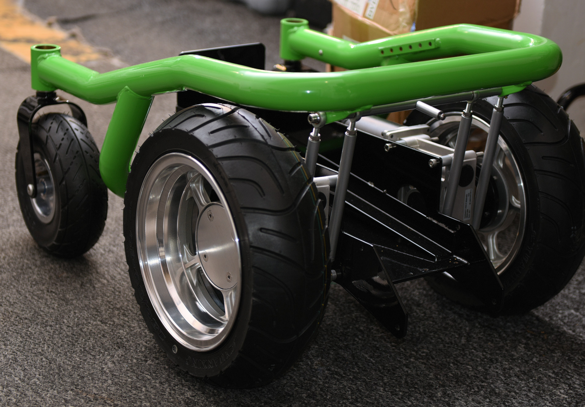

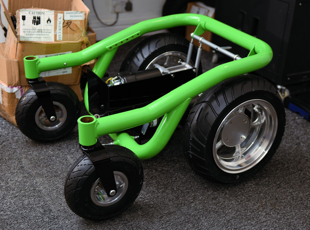

Casters and forks fitted...
Slowly but carefully.
Posts: 70424
Another
Posts: 70424
And another
Posts: 70424
