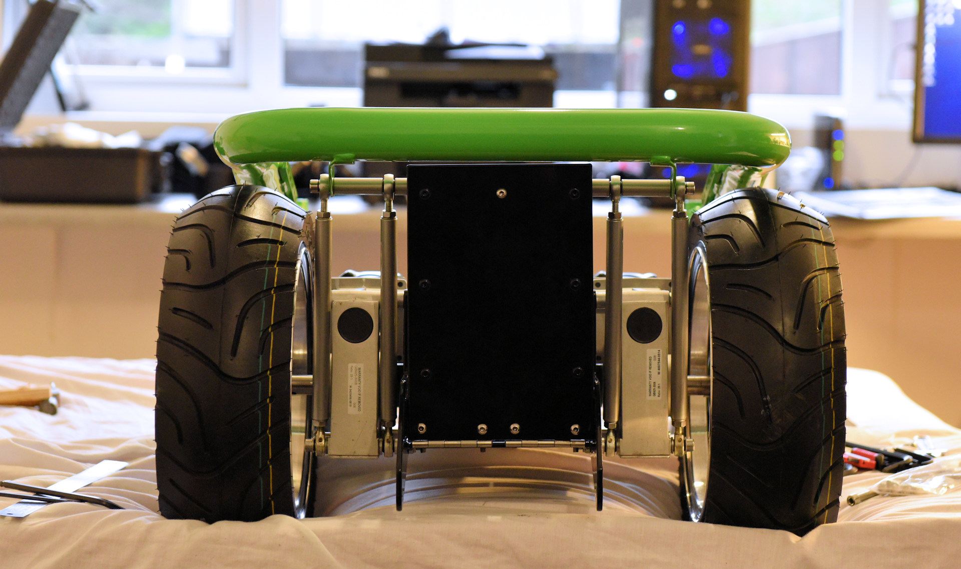

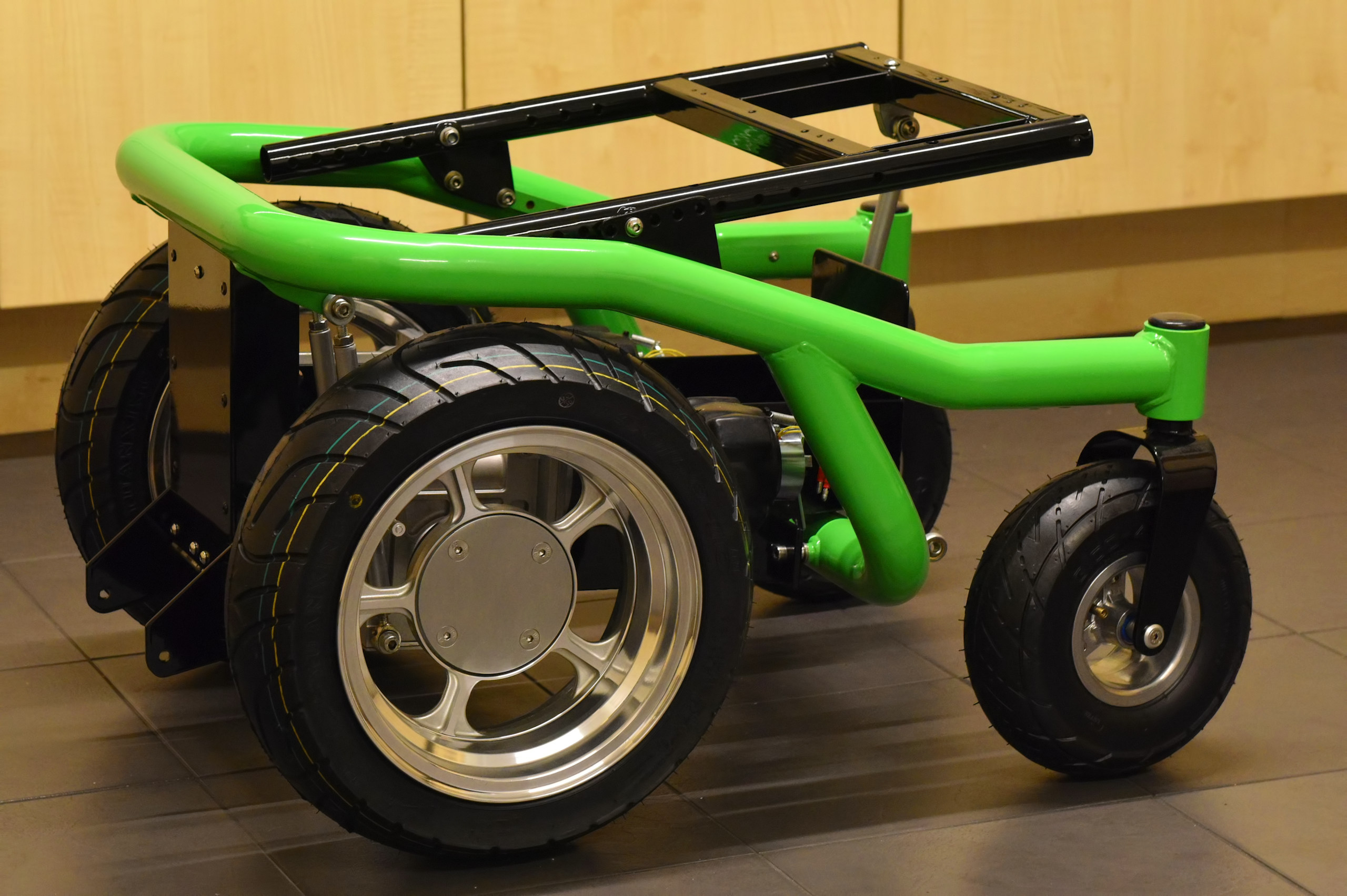

Postby Burgerman » 30 Dec 2015, 15:54
Adjust and align...
Pic 1

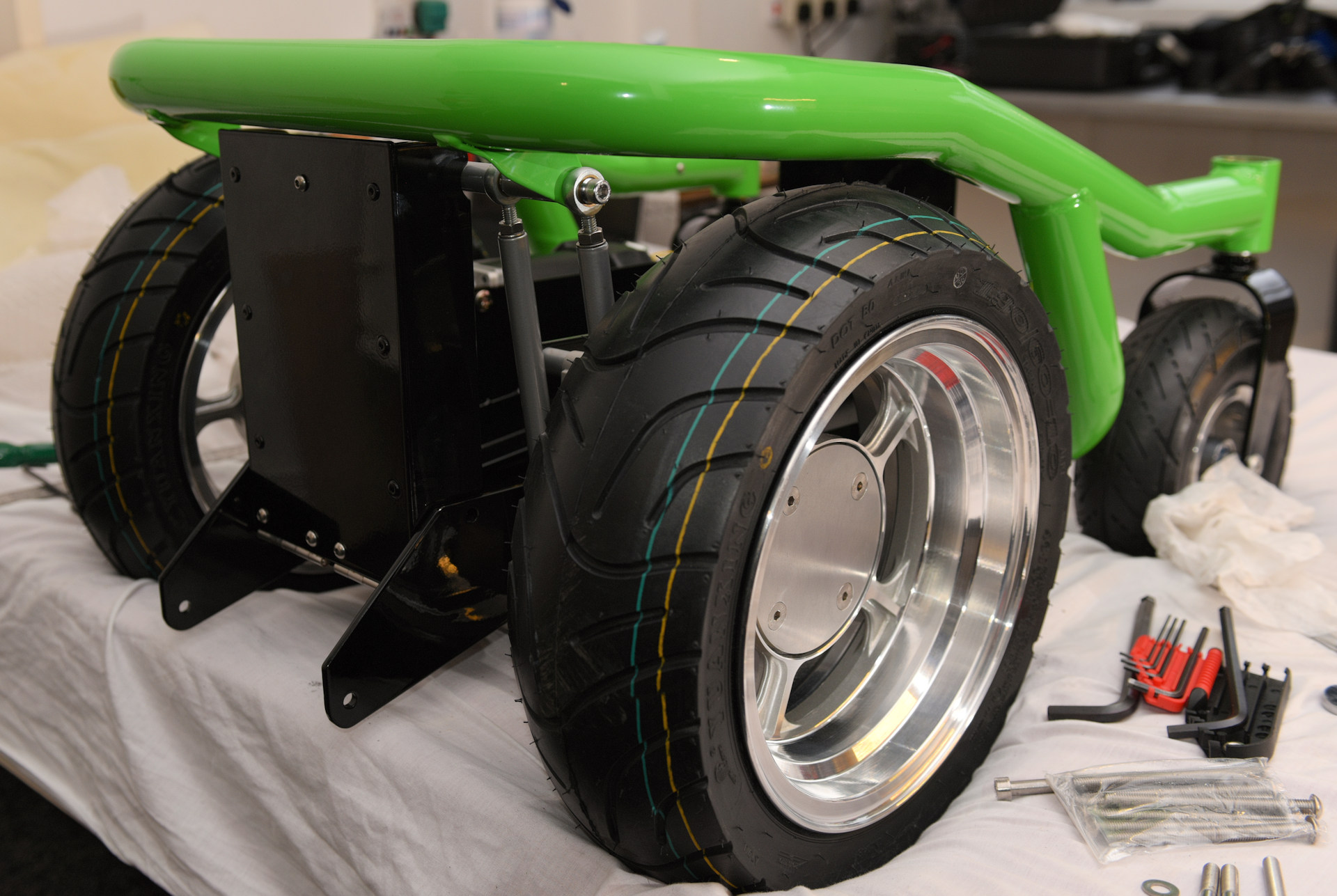

Re: Rebuild BM2 green...

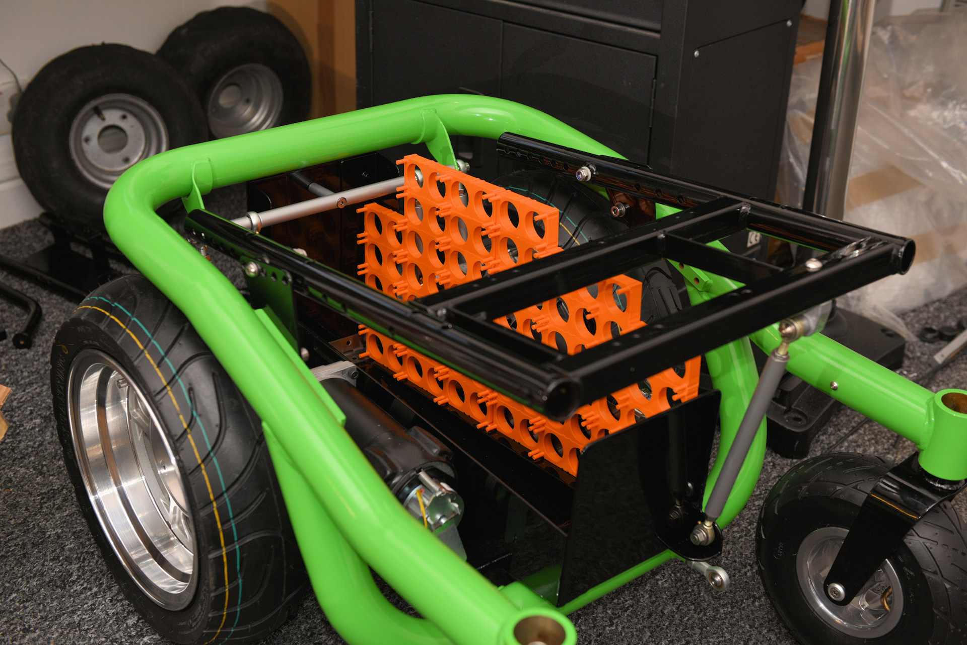

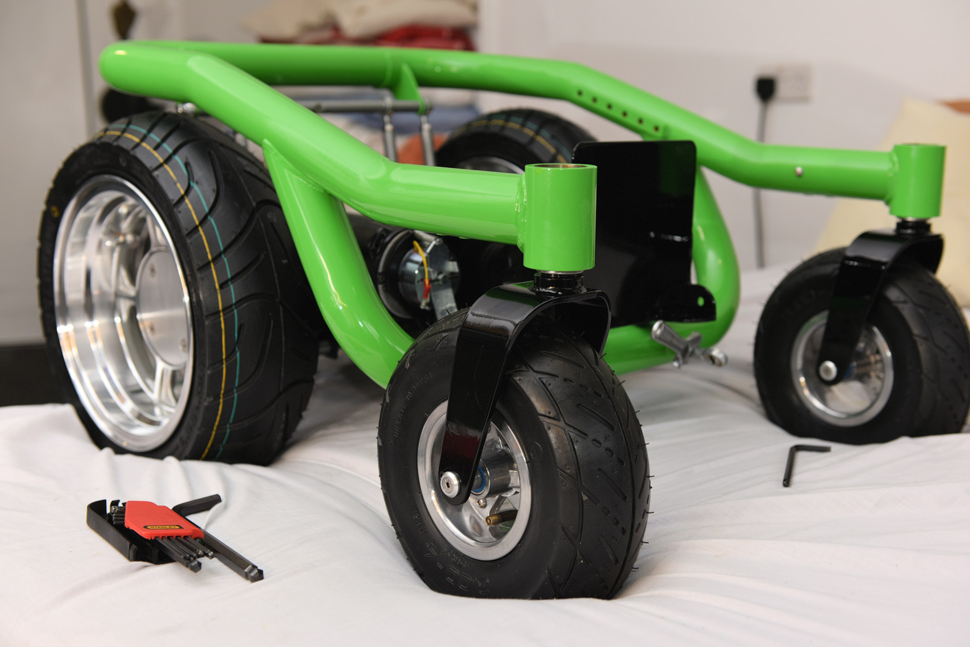

Postby Burgerman » 30 Dec 2015, 15:56
Again... Line up motors, adjusting all roast joints ((c) jenny) (2nd from left, top, too long, etc)
pic 2

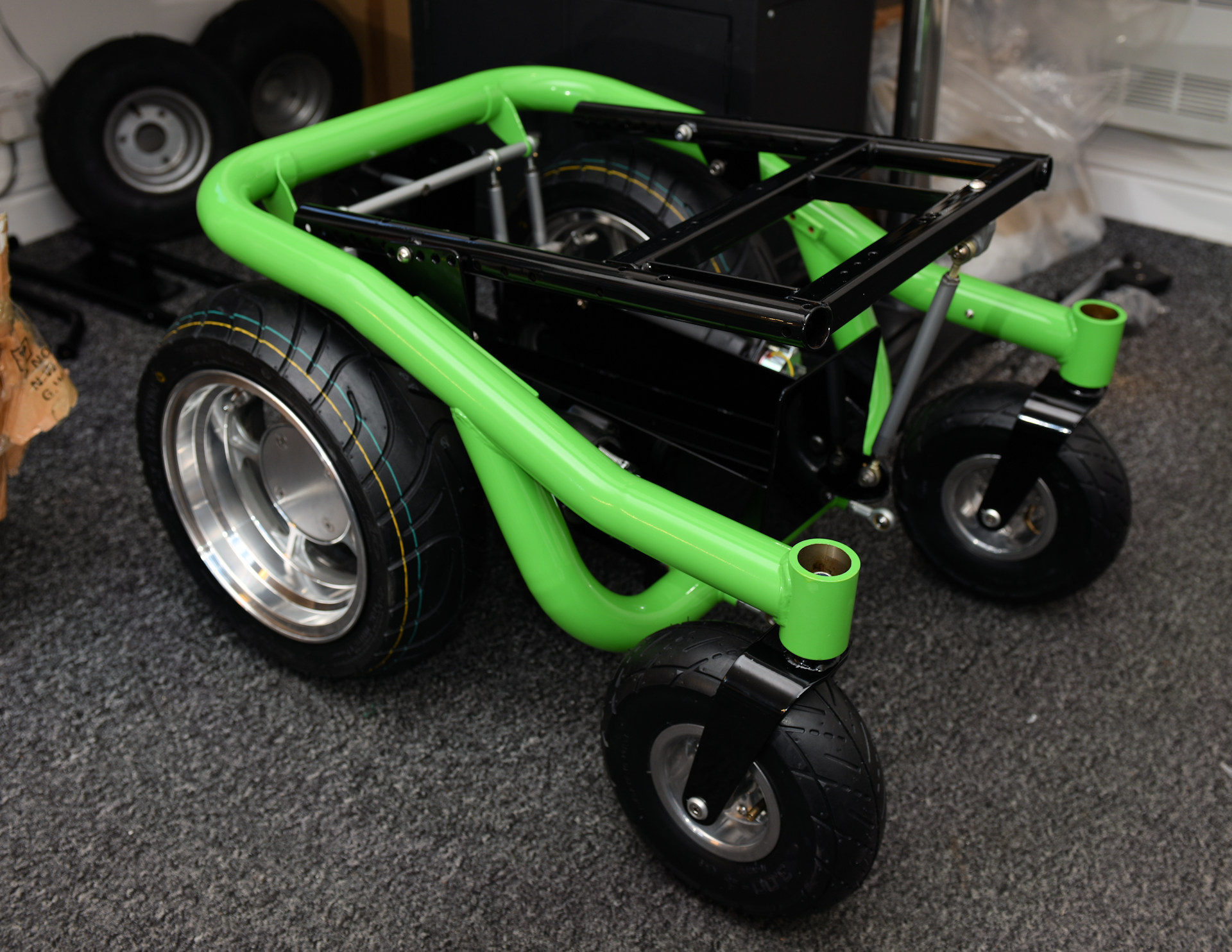

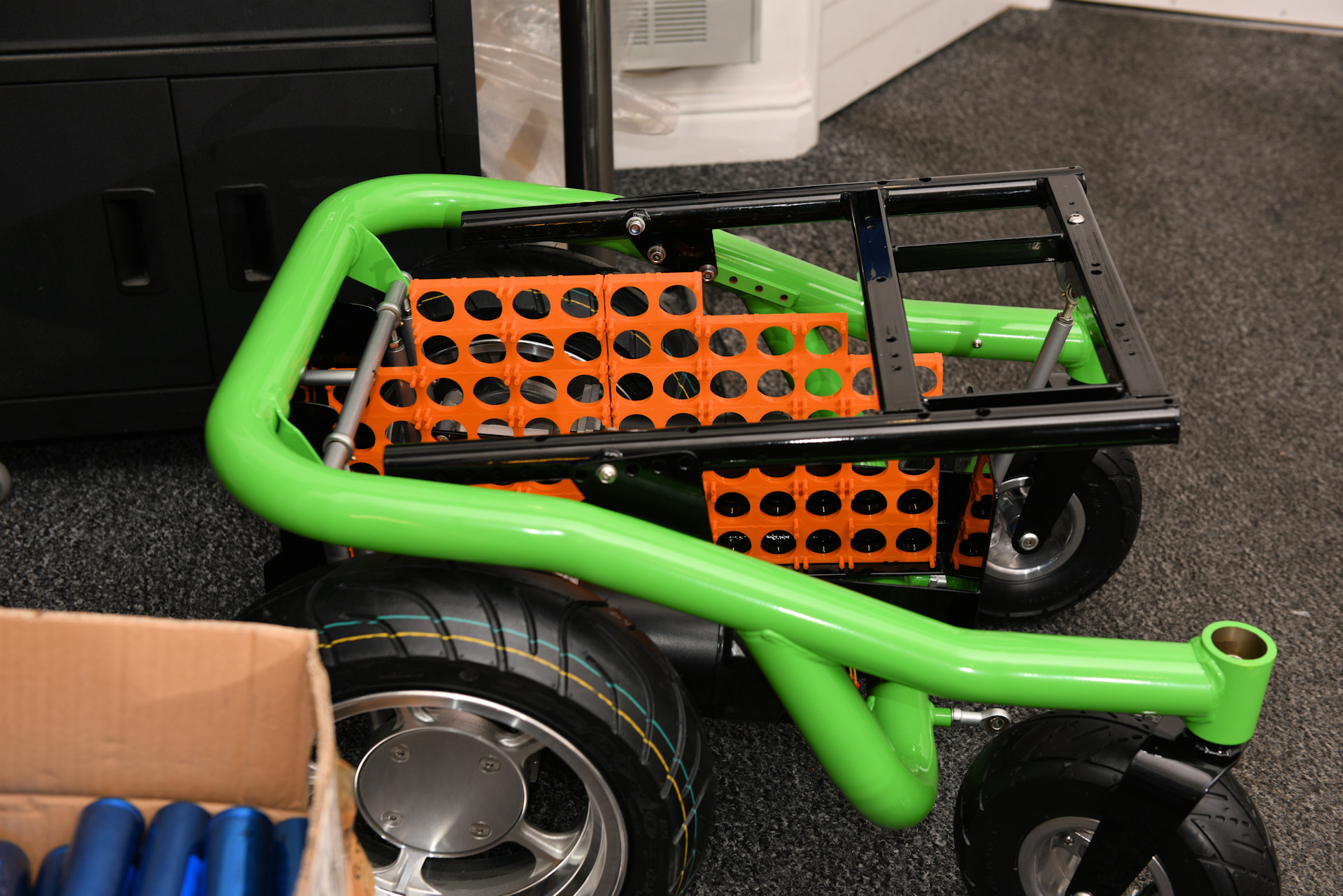

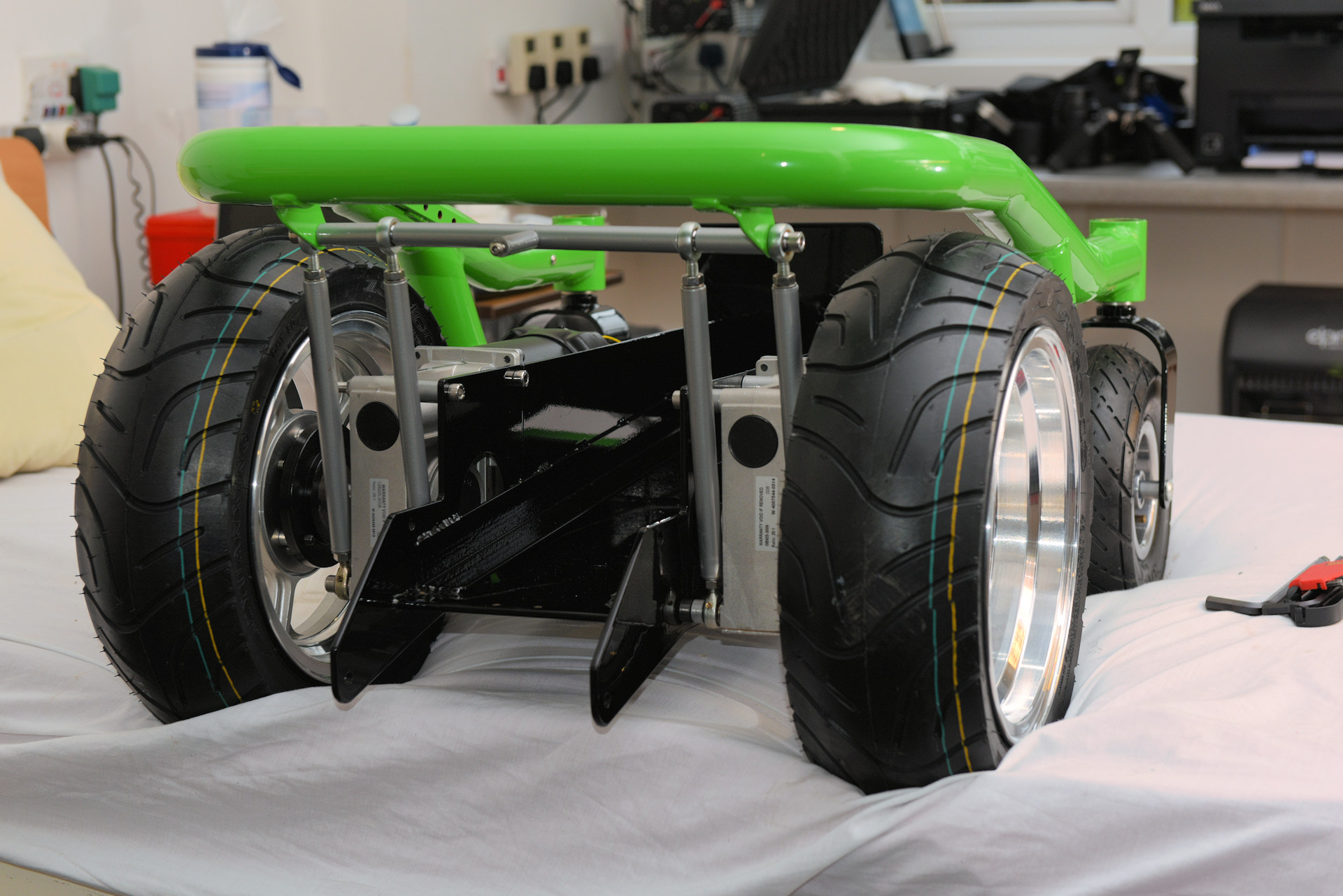

Postby Burgerman » 30 Dec 2015, 16:01
Rear battery door, hinges, etc, and replace top motor mounting bolts with thinner head ones to miss battery terminals by greater margin.
pic 3

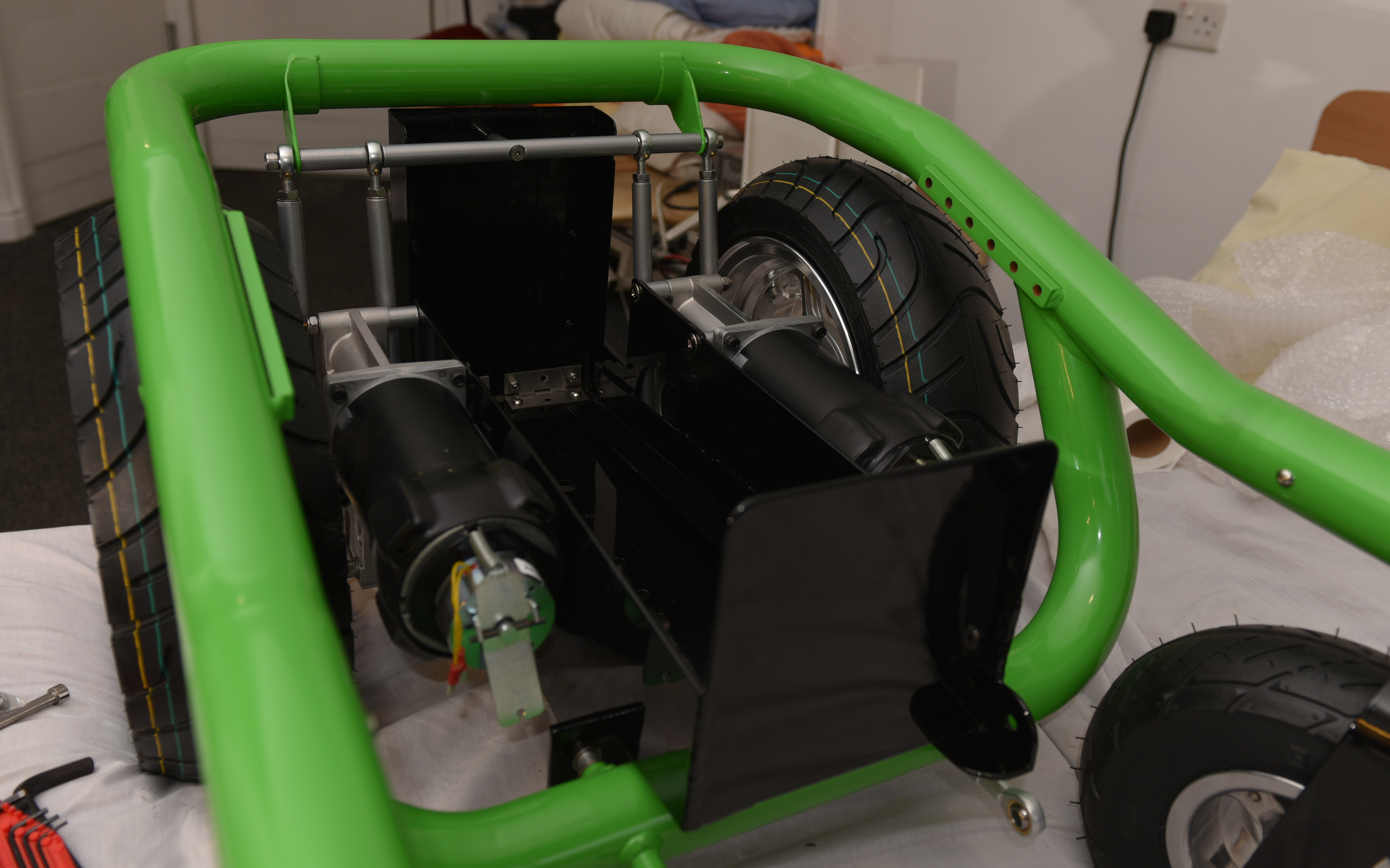

Postby Burgerman » 30 Dec 2015, 16:02
From the rear, flash never fired so colours a bit wrong...

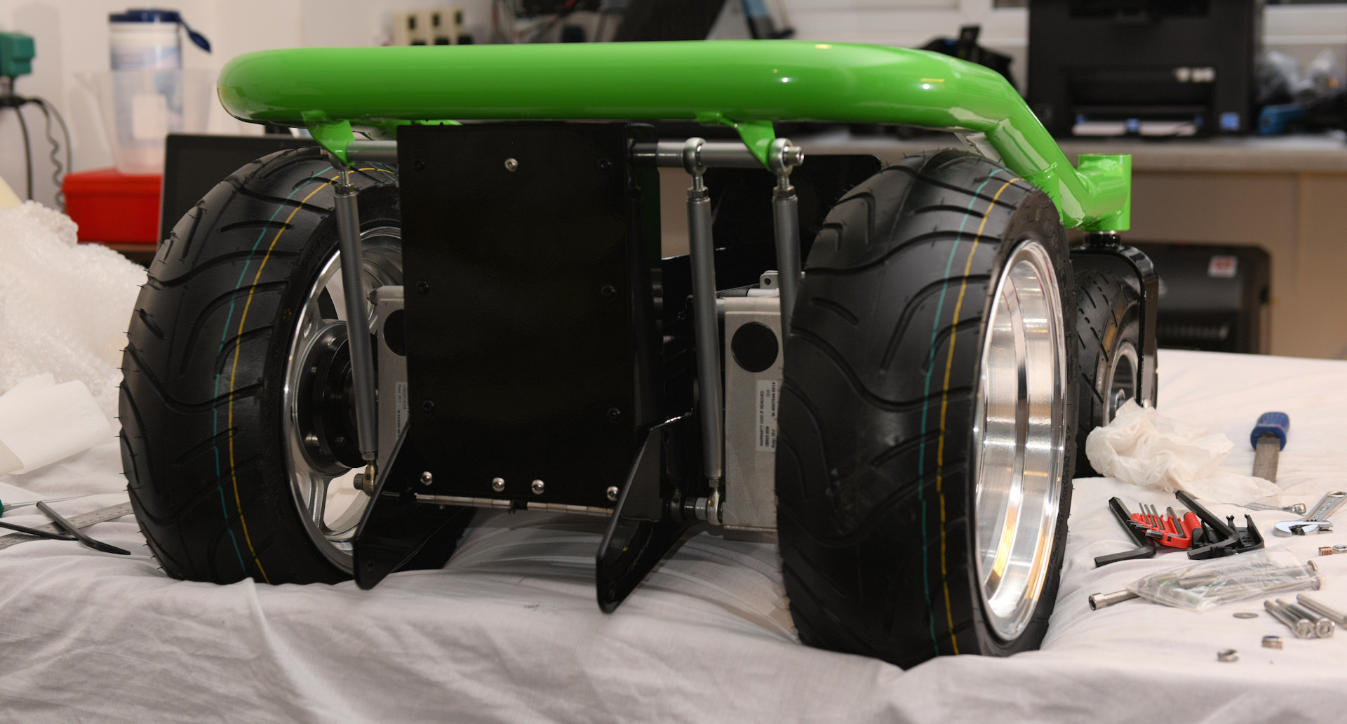

Postby Burgerman » 30 Dec 2015, 16:03
Rear quarter - distorted because I am about 12 inches away...

Postby Burgerman » 31 Dec 2015, 15:06
Seat plate/frame. Too much dump here, shortened, footplate mounts cut off, different mountings, and powder coated.

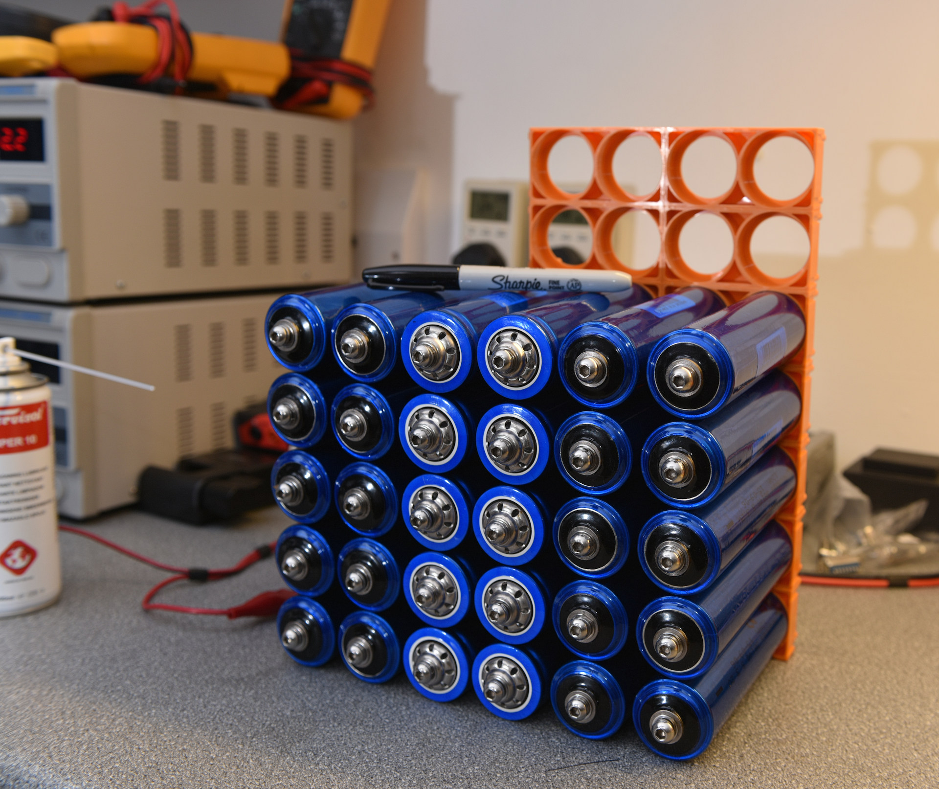

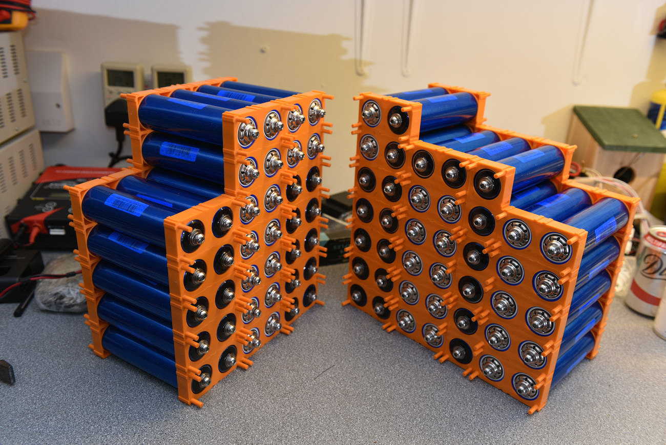

Postby Burgerman » 31 Dec 2015, 16:36
Which I needed on, because it lets me configure the battery in multiples of 8 to take the best advantage of the space available. This is ESSENTIAL to take full advantage of the lithium battery.
Max capacity I can fit (easily) is 120Ah. (80x 12cells). Because one of the great things about these headway cells, over the typical prismatic cells, (or lead) is that it can be configured to use up all of the available space. It need not be rectangular. Or even all in one place.
See below:

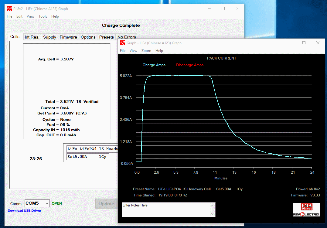

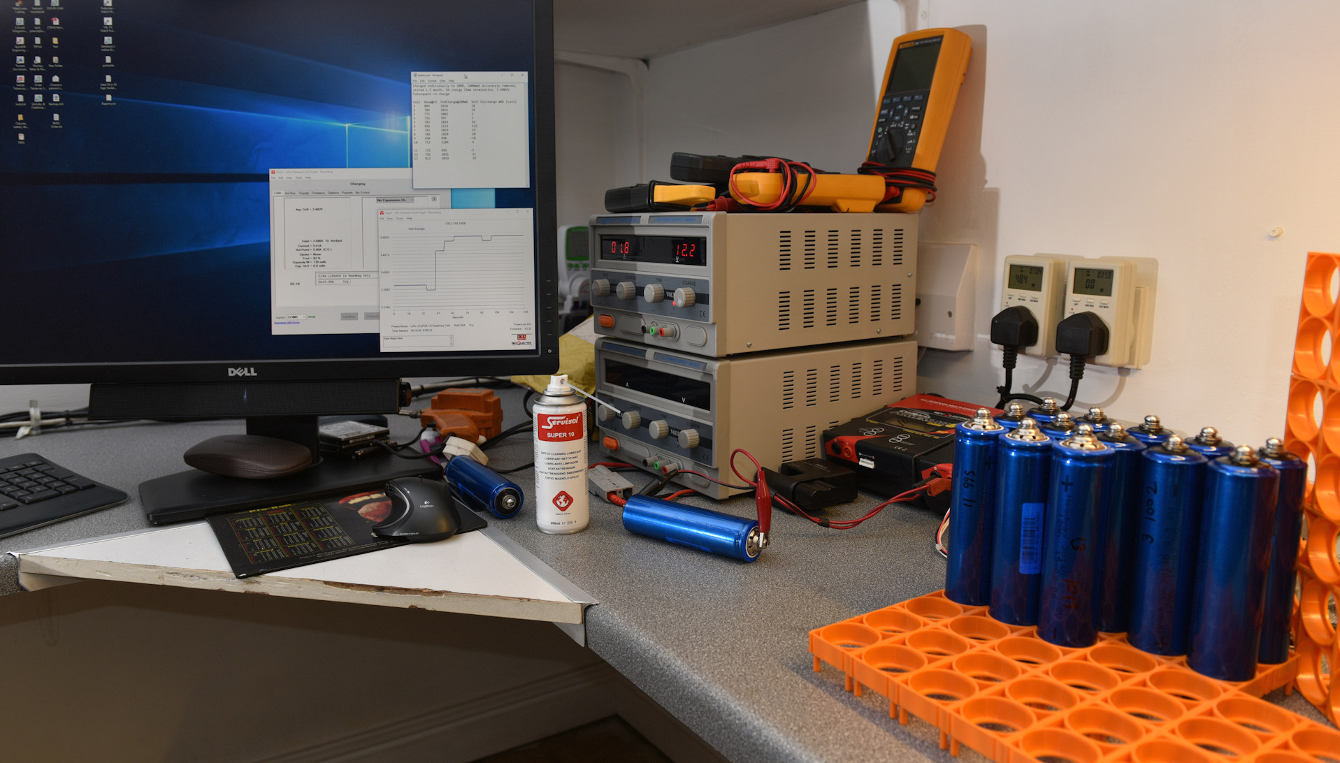

Code: Select all
PL8 charger used.
More done! 30, only 50 to go!

Built, cells carefully selected into 8 identical groups, so that they have equal self discharge rates, capacity, etc.
And under test. Wiring will be tidied up and cable tied. This splits into 2 halves.
80 Cells, 120Ah, 3000 plus watt hours, all cell groups selected after 6 weeks for similar self discharge rates, and for Ah capacity. This is under test.

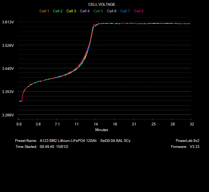

Its quite heavy gold plated. But even when that's worn away I don't see much of a problem. If there is it will show on the graph screen as uneven balance? But its proportional, and so will adjust for resistance changes on the fly... Cells all look pretty well matched here to the 0.001V level! (This Shirley, is why we don't use a BMS!)
BM2 one (2 connectors, as a 6S and a 7S pack at once).
And an 8S 120Ah discharge shows why voltage tells us nothing useful... Temperature varies the voltage far more than discharge level:
First charge so not completely together:
Discharge testing my quadcopter battery, through same connector while testing (only 3 cell, and all 3 well matched, this is LiPo so different voltages:

Just ordered anti tip wheels (80mm black hard urethane inline skate wheels) and spacers, and bearings. And a 120mm M16 8.8grade bolt for the tie down. Those have to be fitted, tested for fit and angle befopre battery can be added as I cant get it up on the bed afterwards. Too heavy!
