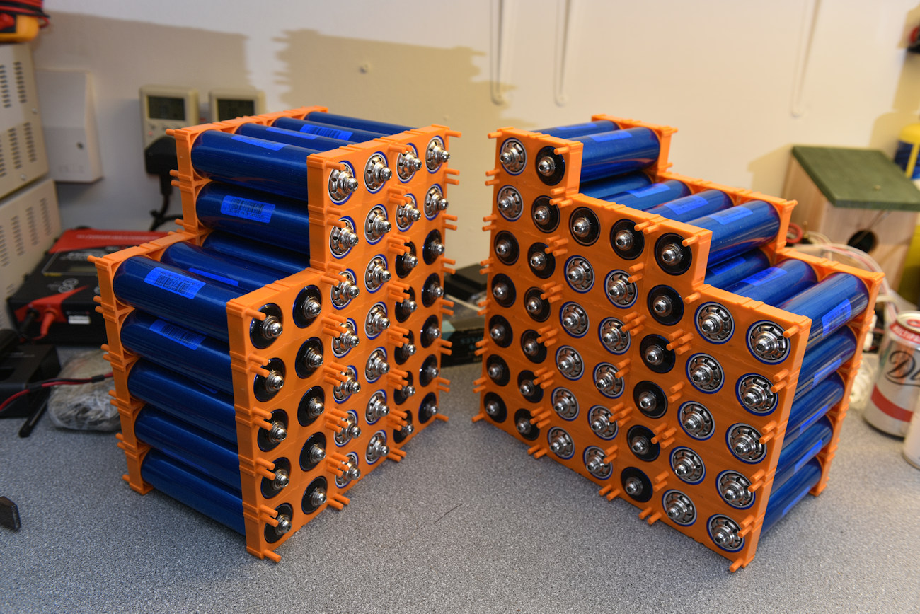

Burgerman wrote:Here's one I made earlier. 80 12Ah cells, split into 2 packs, for easy lifting of uneven size and obscure shape to allow some parts to be 7 cells deep while others are 5...
Nice - your lucky you are able to do all this and know what your doing at the same time :)

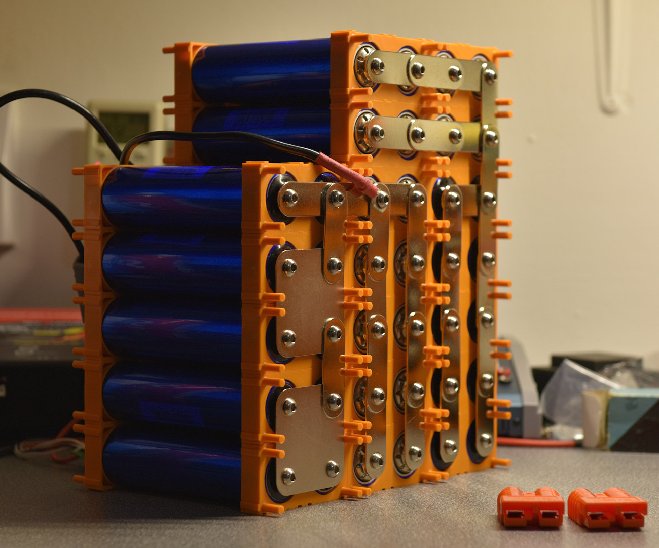

One of my two done. This has about 1/3rd the cells.

Mines built all bar a couple of connecting bars... I never get enough. No idea where they all go.
