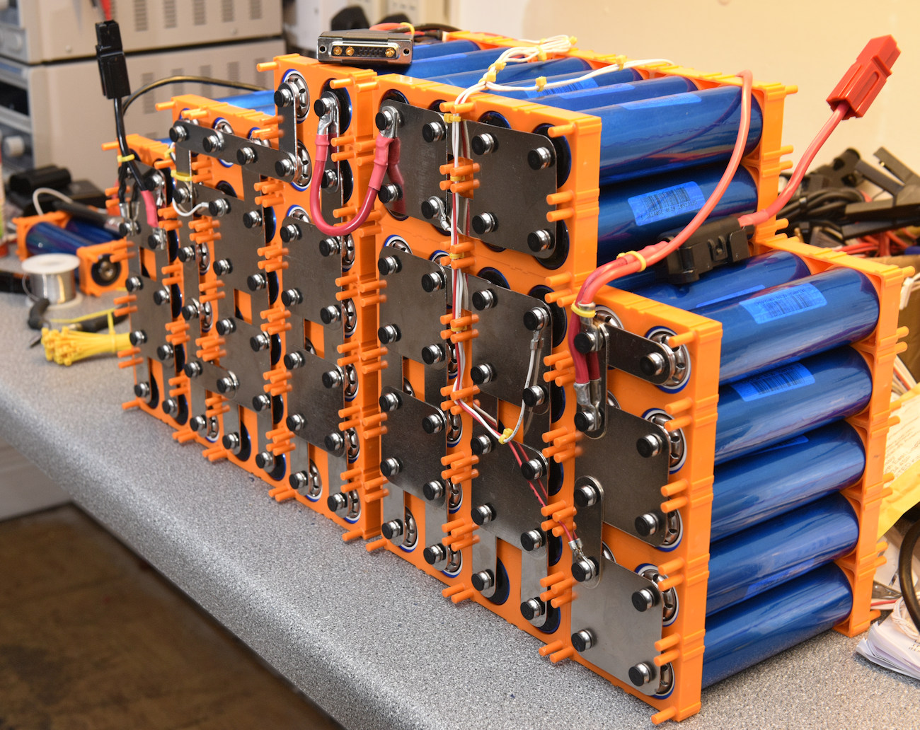

Here is it - i used paper as buss bars -
first pic is the bottom and next is the top - bottom pic has 2 hole buss bars on each end - pos to pos and other end would be neg to neg
three 4 hole buss bars between them
the top gets four 4 hole buss bars and thats it - hopefully this is correct -

expresso wrote:Ok i put it together - i believe this is the way -
First pic is the bottom and next one is the Top
It is incorrect.
You need to do 2 positive, then 2 negative, then 2 positive, the 2 negative, etc. You did 4 positive, 4 negative,etc. Each column must alternate between positive and negative. Should look something like this:
The connectivity of the bus bars you did get correct.
Ok - Got it - will change it later on and take pictures again to make sure - coldest day for the year today and i have to go out for a moment - not looking forward to it -
Postby expresso » 19 Jan 2016, 16:15
I though it was wrong also - but i didnt know for sure -
if i had to do it alone - One roll of 8 - i would add all 8 Pos on top and all 8 are Neg on the bottom - using the 2 hole buss bars - connect them all along the top and bottom - that would be then 26V 8 Cell pack at 12ah -
i get that much - but get thrown off with the up and down etc, - anyway - this is correct now ?
and the buss bars were correct - so all should be fine once i get them tomorrow - i can connect it - safely of course

Postby Scollard » 19 Jan 2016, 17:00
expresso wrote:I though it was wrong also - but i didnt know for sure -
OK. You are now correct.
So I would attach the top bus bars first. First set the 3 square 4-hole bus bars, then do the two 2-hole bus bars on the outside cells. You cannot short circuit the battery at this point. So this is relatively safe. I would recommend not wearing any rings or a watch when you are working. I use a T-handle allen key that I've put heat shrink on leaving only a 1/4" of the key exposed. It is impossible to short circuit the battery with this tool as 1/4" will not bridge between batteries. Send a picture once you have the top complete. The we will talk about the bottom.

Postby expresso » 19 Jan 2016, 18:00
You got it - i have a few keys to use - but they are the normal kind - no T handle - but i be fine - i will cover it best i can and use a cloth over the rest of the areas that i am not working on etc,
i wont have the buss bars till tomorrow - and i may wait for my friend helper on friday if i feel i need it - or i may get it done before - now i wont screw it down too tight - because i still need to put the BMS - and i want to use Locktite 242 blue i have only at the very end when its all connected correctly -
then i will do one screw at a time and locktite it down - so a few times i will be removing the screws till its done -
i like this - wish it wasnt so Cold out - i would go looking for a divider - but have to wait for that now -
i post back when i get the top done only first -
