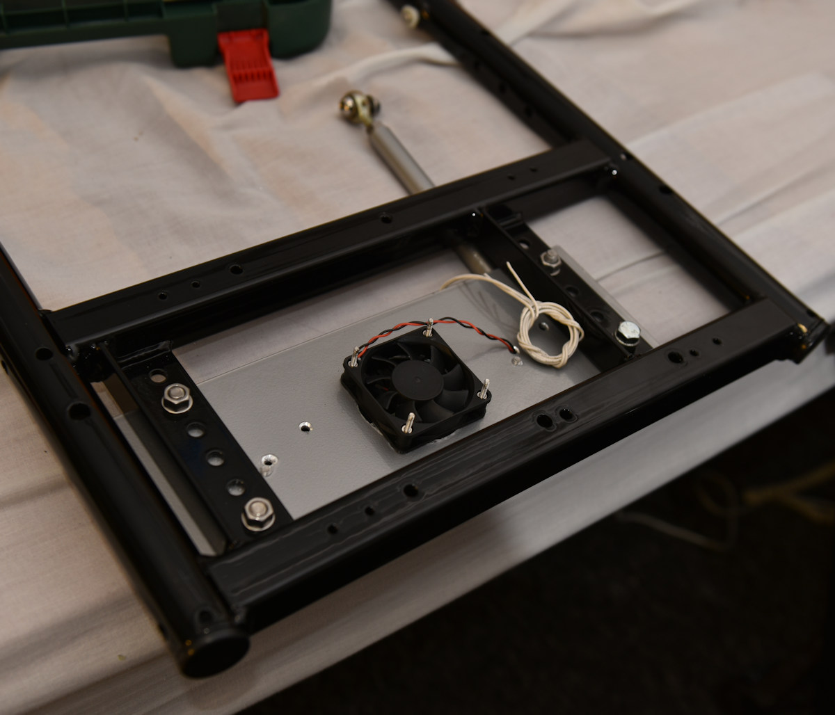

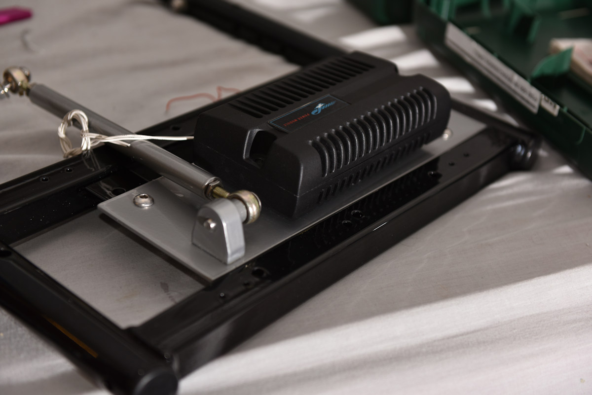

And now the thermostat is inside the case and the fan fitted behind the mounting plate under the seat cover.
So the power module can sit over the hole on 2 8mm spacers so the air can escape underneath in all directions.
And the fan will come on any tie the mosfets reach 45C.

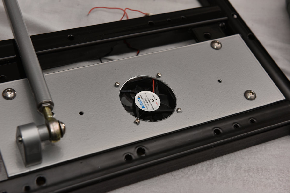

And the top which will not be seen because there is a flat metal seat plate yet to be fitted:

If you program your chair to go. To stop. To turn. When *you* tell it, and you dart about a bit for a few minutes stopping and turning they *all* start shutting down and rolling back the power. And eventually it gets to the point where the chair barely moves.
Mine only does it when I am clearing leaves with a blower for half an hour when darting around and zig zagging. Because I adjusted the temperature in the programming from 55 to 70 centigrade. So it doesn't usually bother me. But now and again in summer it cuts in and pisses me off...
This should help keep it cool. And with the thermostat chip inside the power module, epoxied to an output mosfets, it should be efficient. Its not easy either. Not any wasted space inside that PM! At 45C the fan is on. At 40C it goes off again. So it only wastes power and makes a noise if needed. It is only a small fan too, but its circulation is quite good because of the way its working and the way the PM is spaced off the surface. The cool airflow around it and from behind it is pretty good.

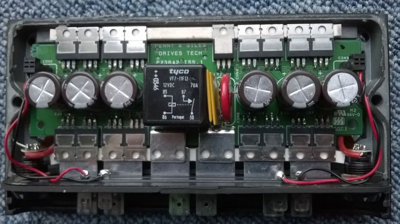

I presume you haven't looked inside your power module yet then?
Image :lol:
Nothing to be scared of. You just get to see how crappy the build quality is, wit only a rubber foam pad making the pressure for all the connections to the power mosfets. Amazing they don't fail more often. And that they are using just 8 power mosfets. Unlike the Roboteq with 32... No wonder they get hot really is it.

Postby Burgerman » 03 Feb 2016, 11:17
Well surprisingly it does appear to work pretty well! I and the rest of us using all of PG Drives systems, inc Rnet should take the thing apart and use a scotch bright cloth or fine glass paper to clean those contact point every year or so though. It will likely prevent failure.

Postby Burgerman » 03 Feb 2016, 17:03
Look at the pictures. Inside. They just press together with a bit of foam! That is supposed to be OK for 100A per motor.
Outside too.

Re: Rebuild BM2 green...
Postby Irving » 03 Feb 2016, 17:49
I don't suppose you know what MOSFETs they are, or have pics of the other side of the board showing them??
Postby Burgerman » 03 Feb 2016, 17:53
The side with the writing is folded on to the board so not visible without bending them up. I did compare an 80 to a 100 years ago and they were the same. So its only a firmware difference.

Postby LROBBINS » 03 Feb 2016, 20:32
Could be a firmware difference, or a different shunt in the current measuring circuit.
Postby Burgerman » 03 Feb 2016, 20:38
Its firmware or the programming tools wouldnt have different limits on the Amp settings? Or maybe both... Theres a feeble 50A one too.

The reason I was asking what MOSFETs they use is to think on whether they could be replaced with a newer type with a lower Rds(on) (on resistance) and then tweak the current limit. I would expect that current limiting uses a sense resistor that could be changed. The firmware will most likely measure voltage across the sense resistor and once over the limit will roll-back to a lower voltage for a period of time. Changing the limit by changing the sense resistor will retain the same normal v rollback ratio without needing a firmware change.

but none show the MOSFET type. :(
There are 8 MOSFETs in the H-bridge, arranged in 4 pairs. At any one time only 2 of the 4 pairs is on, each MOSFET carrying 1/2 the current, so if limited to 100A each would be carrying 50A. A typical MOSFET from as little as 4y ago will have an on resistance of around 20milliohm, so heat losses = I^2 * R = 50 * 50 * .02 = 50W, WORST CASE at stall per MOSFET, which is fine with a decent heatsink. It'll get hot (case temp ~100degC) but wont die.
Replace that with a current top-of-the-range HexFET. On resistance 6.5mOhm, so for the equivalent heat loss it can handle 100A, or putting it another way a 100A controller could, in theory, be upgraded to 150A with a reduced heat loss of 36W per MOSFET and a case temperature of around 60degC (assuming its just a sense resistor that needs to be changed as well).
And the price? £14 inc p&p
That's a lot cheaper than a RoboTeq! In fact the Roboteq's oft quoted 32 MOSFETs (per channel?) is arguably overkill using current technology.

Actually those are pretty good devices, apart from they are no longer manufactured, not dissimilar to the ones I was suggesting. 55v a bit low for my liking on the regen spikes, but if that's what's fitted then just changing the sense resistor would work to 125 or 130A. I'd not take it to 150A
