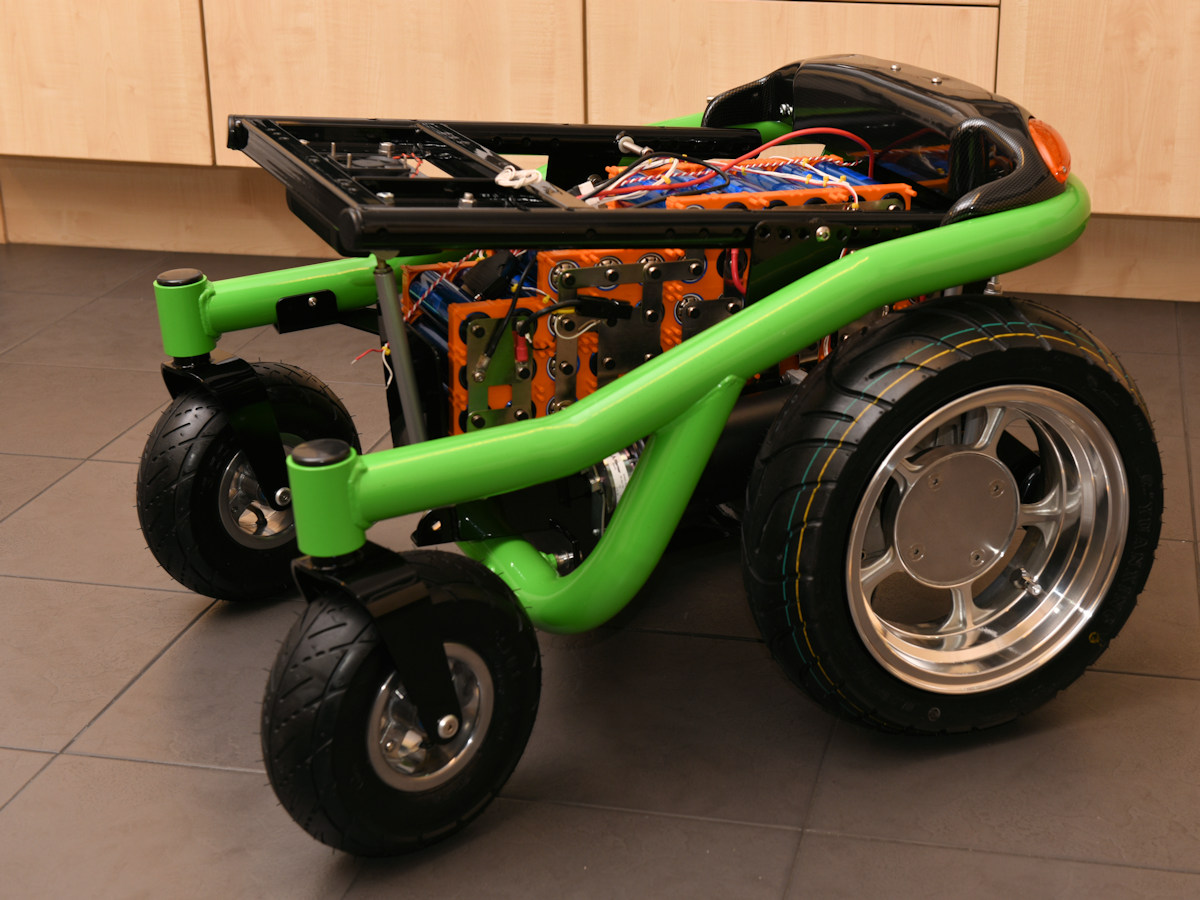

Battery fits... Thats a work of art!
Now sort wiiring, lights, and the fan controlled by the recently installed thermostat, and make a footrest...

Re: Rebuild BM2 green...
Postby rustyjames » 10 Feb 2016, 20:47
Wow, that is a work of art, and coming along nicely.

Postby hank » 10 Feb 2016, 21:47
8-) 8-) Pimp my Ride.
Will look well with that new seat back fitted. :mrgreen:
Postby Burgerman » 10 Feb 2016, 22:03
And go well. As long as the seat back isnt narrower than my body...
This should have an enormous range. Will will hind out in about 10 days.

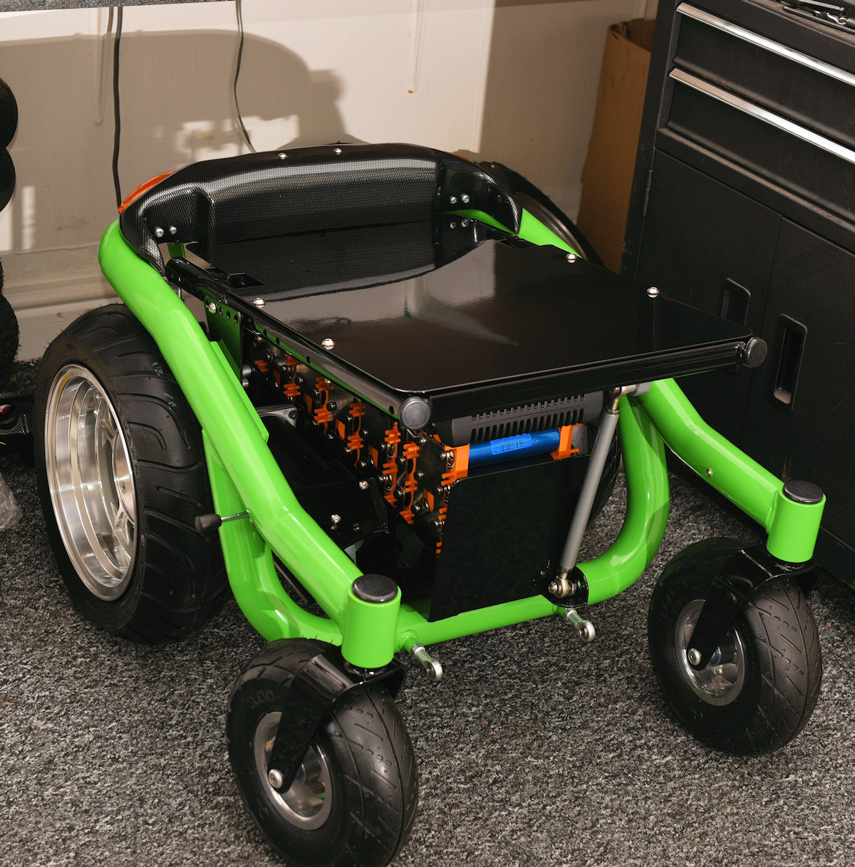

Postby Burgerman » 10 Feb 2016, 23:16
Better pics
Seat isnt bolted on, just loose. Wires all over the place. But you get the idea. Waiting for seat, and need to build a footplate. Then ready to go.
http://zoomability.com/zoom/ this gets 25 miles with just 950 watt hours. Mine isnt as efficient, as its not brushless. But I have 3200 watt hours... So should get 50 to 60 miles on a smooth pavement.

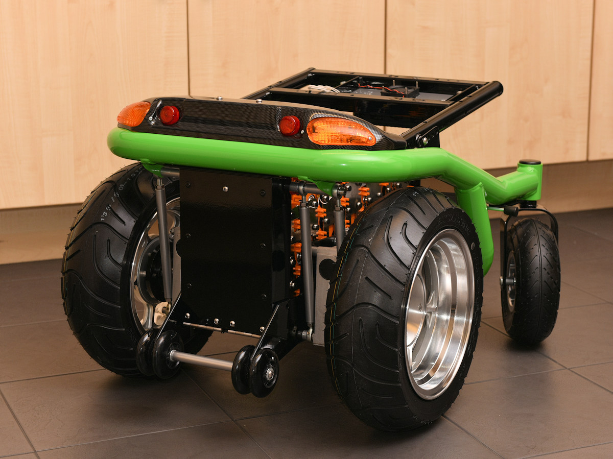

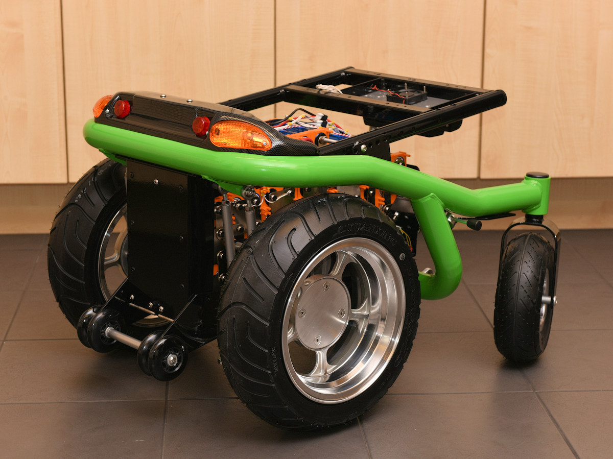

Postby Burgerman » 11 Feb 2016, 14:06
Seat plate on temporarily.
You can see the 100A PG power module here. The one I fitted a fan thermostat switch inside. This will be
fan cooled above 45 degrees C.
iI always get the flat seat plate powder coated too. Leaving it super glossy. Cushion (Jay2) is held in place via VELCRO. This seat plate will have 2x 2 inch wide velcro strips added. But first we need to wait for my car seat back to arrive...
Battery sides will be covered in 1mm black plastic sheet, slid into the base to hide the cells and wiring. You will only see the blue ones at the front.
LED 10 WATT headlamps (4x 25mm Diameter to be added) and they are as good as a car headlight, and really small!
Postby ex-Gooserider » 12 Feb 2016, 02:37
You will be wasting most of the light output of the LED's if you don't use the same LED color as the lenses - I.e red ones w/ red lenses and yellow ones w/ yellow lenses... The lenses are filters and BLOCK any light that isn't their color, so all that gets through is the part of the LED output that matches the lens, and whatever extra from the lens not being a 'perfect' filter....
If you put red LED's behind a yellow lens you will get dim light at best, and might not even be able to see it at worst....
White LED's will be brighter since they have SOME yellow light output, but really you want either Yellow LED's or to change the lenses to red (if possible)
Unless your local laws don't allow it (where do any light rules on blinking lights say "wheelchair" officer?) I'd make the yellow lights into blinkers, ideally alternating - MUCH more noticeable than just adding more steady red, and that is your main objective....
