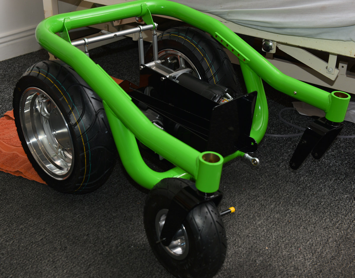

The chair I am rebuilding now, has very low rolling resistance. download/file.php?id=4165&mode=view
Because it has a high ply count (6) so is quite a stiff tubeless construction, and because its a radial, and because its a 2 inch larger rolling diameter, and also because its a rounded profile. So only puts its "width" on the deck when on the soft turf/dirt track/snow or whatever. These are fat, and have lower rolling resistance than the stock crappy powerchair 300 x 8 cross ply grey tyres. Add to that, the lack of weight over the casters, lowering turning and rolling losses at the front, the 4x greater battery storage, and the 50lb weight loss from the battery (over a 100lb from the complete chair) and I expect to get MORE than 4x the range of a stock 24 mile lead chair... Will it be as comfortable? I don't think so. But I built this one to look cool!
