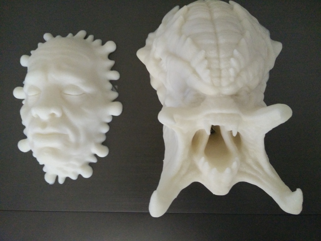

Postby terry2 » 26 Mar 2016, 08:13
That's a nice starter printer. Will you be using Repetier with Repetier host?
I'm saving for the best one and it's British :D https://bigbox-3d.com/
I've mode mine to take a E3D V6 and a new extruder so I can print Flexi filament.

Fine detail is good. But the thing stopping me is this. Software... I learned some autocad once. What a complete bitch that is. Dont want to go there! What is easy, intuitive, and will work with this printer?

The print posted was done on a XYZ Duo 2. I wouldn't buy one again.

I use a lot of Flexi filament and Nylon. I'm going to use some changing colour filament on my chair next year.
I will use glow in the dark filament, which is yellow in the day time. :)
