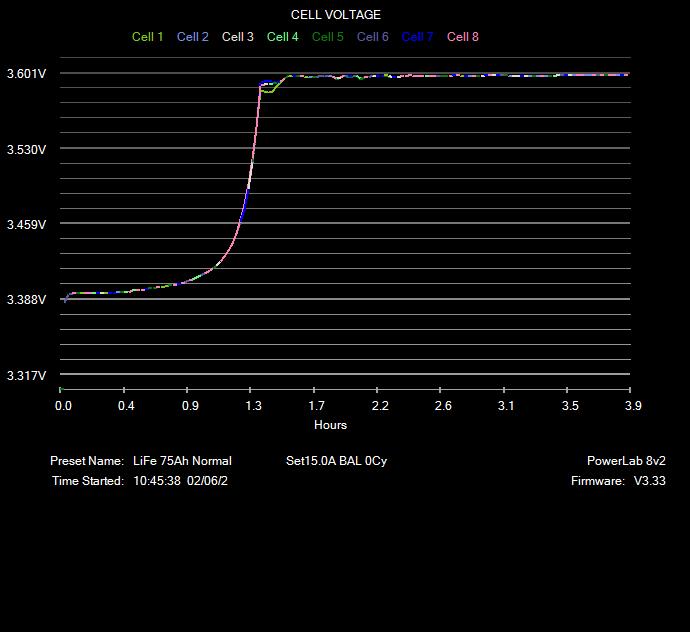

i didnt look at the presets yet - but what changes were made to it - what difference from the previous ones -
expresso wrote:nice tight one you got there - haha -
i have to see what BM set for me - will post my results later tonight - i have balance to start at 3.5V i believe - Term. at 200mA

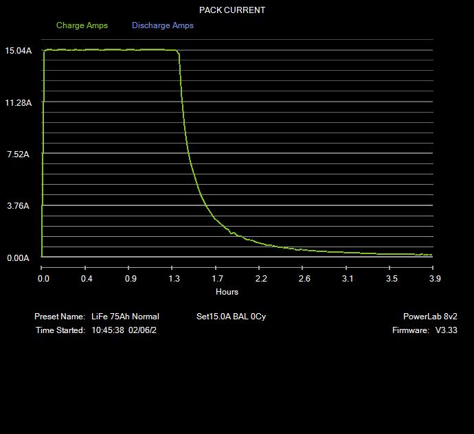

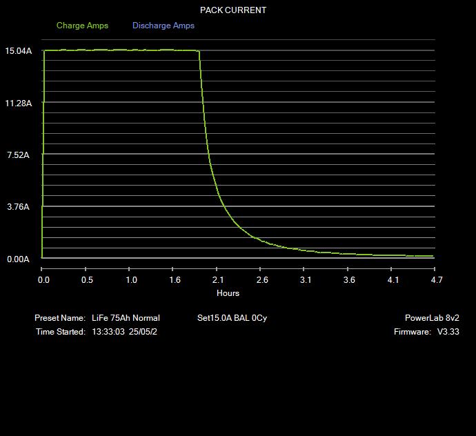

Burgerman wrote:52Ah returned, About 48Ah used. 20.6 miles covered.
So 41 miles range, if you used 96Ah leaving a safe 9Ah in reserve.
Or 2.33Ah used per mile. 105Ah pack div by 2.33 = 45.06 miles total till you stop with a dead battery.
With the addon, thats 36Ah div 2.33 = 15.4 + 45.06 = 60.4 miles total range.
