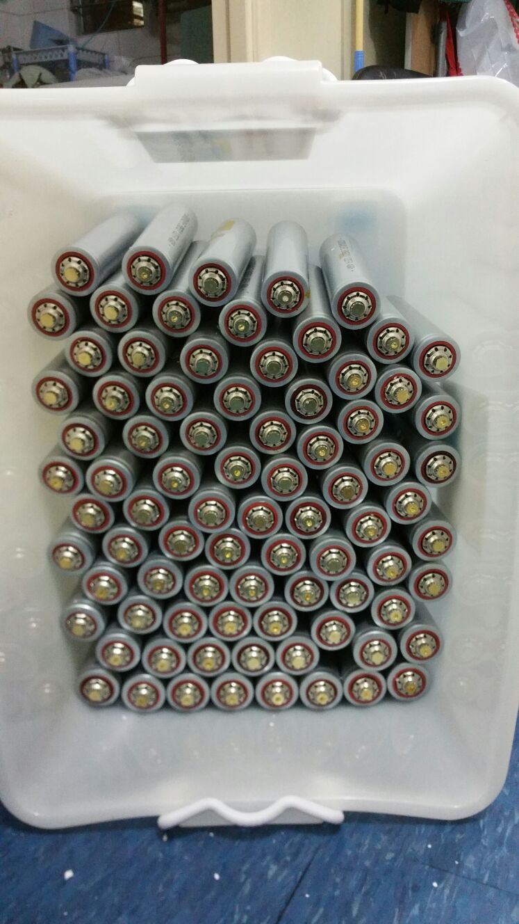

Postby shirley_hkg » 03 Jul 2016, 10:48
Posts: 4657
Postby Burgerman » 03 Jul 2016, 13:49
Those are headway cells. Came out of the same factory.
Posts: 71101
Postby shirley_hkg » 04 Jul 2016, 02:31
How can you tell ? ;) ;)
Start assembly it into 24V block, so I can run it for a few cycles , and to see if it is good .

Postby Burgerman » 04 Jul 2016, 03:11
How can you tell?? Because other than the plastic wrapper they look identical.
Why wouldn't they be good? Are they old or mistreated??
Posts: 71101
