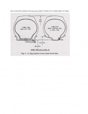

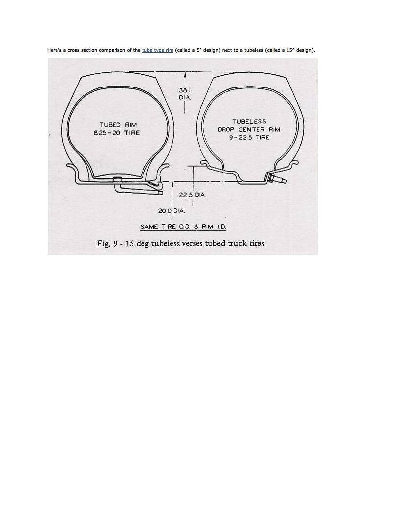

Burgerman wrote:Those are not tubeless rims. You can knock a tyre off... Admittedly its hard. Unless at very low pressures.
Yep, went back & checked whether the tire assemblies were tubeless:
Hi Joseph,
The tyres are tubeless.
Weight of the items would be 10.71kg.
Regards,
Lyndsay
http://www.towingandtrailers.com
Tel: 01909 473749
So I gather that from your experience these rims must be "weedy" tubeless tire rims without a proper bead retention ring, sort of like that older image of a tube tire versus tubeless tire which I posted on another thread:
The rim in the image has the requisite 15 degree slope, but it seems a lack a retention ring.
BM, just out of curiosity, have you ever come across somebody welding a thin piece of rod onto a wheel rim to serve as an 'add on' retention ring?
Googling the notion I ran across a guy who seems to done that on a much bigger vehicle with a 1/8" rod:
