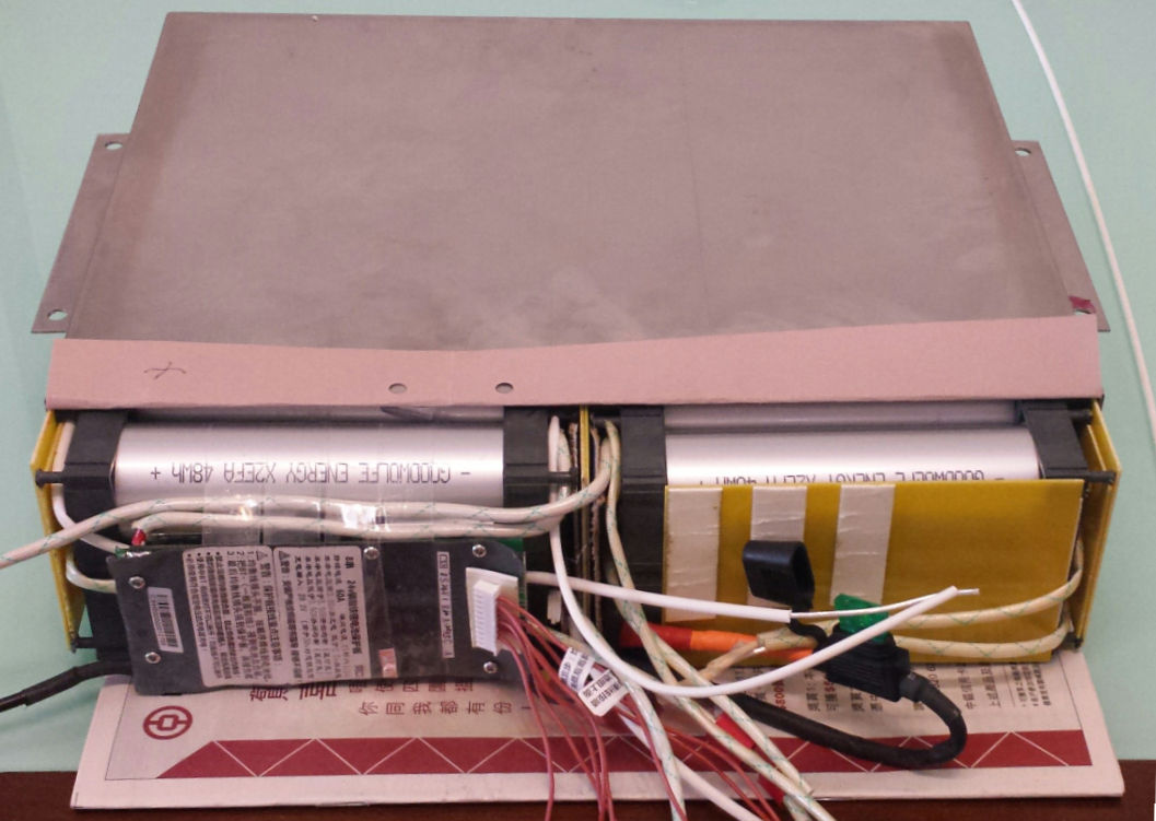

Into S S box . :D

shirley_hkg wrote:Into S S box . :D
nice box - now you will bolt it to your chair back ? - i have to try and find a plastic container to just sit the ADD ON in and then sit the whole container in a back pack - strap it on the chair - hope to improve on the next one i make - and will shoot for a 45ah ADD ON - instead of 12ah cells i used before - will do 15ah cells - 3 Rows :D thats more or less what you get from a set of MK 24s Gel - that should give me a good 30 mile range i think ?
