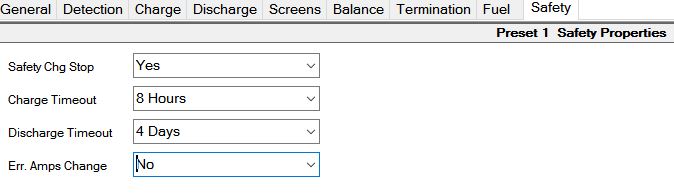

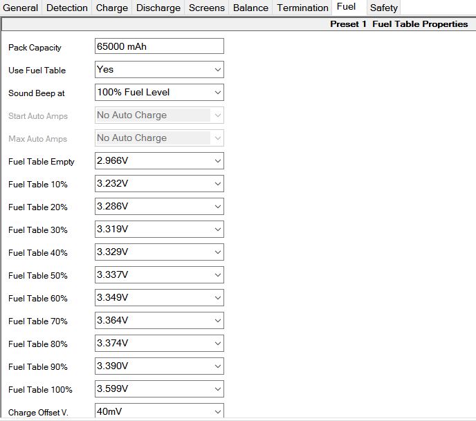

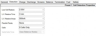

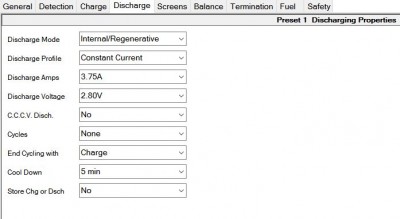

Postby frogsuk » 15 Dec 2016, 20:38
Can anyone please check these PL8v2 settings the following battery.
Code: Select all
   Nominal voltage: 3.2V
Nominal Capacity : 65Ah
Battery type : LiFePo4
Charge current: 30.0A (maximum 55A  )
Internal resistance: ≤2mΩ
Maximum charging voltage: (3.65 + -0.05V)
Rated Discharge current: 150A
Continuous discharge current: 250A (5C)
Maximum Pluse discharge current: 450A (8C)
Minimum discharge voltage: 2.2V
would these settings be ok?

Postby Burgerman » 15 Dec 2016, 22:11
Safety charge stop: NO (if its on my preset then this is disabled behind the scenes anyway or extended to 350mV) Or it will stop charging on a cell imbalance over x mV.
Termination should happen at the point where the charge Amps falls to 1/300th of capacity. You have it set to terminate when voltage is reached. That wont work. You need to set it to MANUAL, and then set 220mA to 250mA termination current. CV timeout should be 8 hours. Or it will never get chance to end charge properly or balance an unbalanced pack if things are out of whack.
Charge current is best around 18A but will WORK at 30. Your cells will like 15 to 20 more!
Use Fuel table, should be set to NO.
Charge timeout should be set to max which is 16 hours. Or again it wont balance a less than perfect pack,
Posts: 70443
