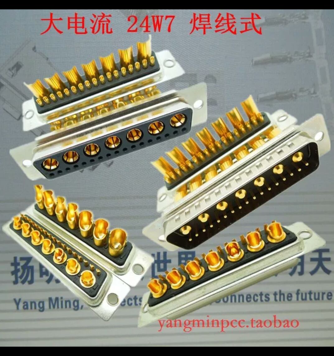

:D Candidate of the charge lead .
6 large pins for the 2 charge current leads .
Each balance lead will take 2 pins .
Muli-pin to ensure enough surface contact . ;)

Those are interesting.
Posts: 70476
Postby expresso » 21 Dec 2016, 16:24
I like those - i would get the 40A model anyway - even if you dont charge at 40A -
you can put the power cables closer in the middle - making it easier to close it with the covers -
i dont understand what you mean - Put the balance wires on two Pins ?
there are enough pins to use one wire for each one - am i missing something ?
are those the same size DB25 ? do you have a link to those where i can buy some also - and the covers if you find some -
thanks - Shirley
Postby Burgerman » 21 Dec 2016, 16:54
Each balance wire, 2 pins... Half the resistance, better reliability.
Likewise, 2x 30A means 60A capable using 2 pins, or better reliability.
Posts: 70476

Burgerman wrote:Each balance wire, 2 pins... Half the resistance, better reliability.
Ok - i still dont get it - haha - one balance wire - you will split it and connect it to two pins ?
how can you split one of those small balance wires ?
i cant picture it - you know i am a little slow right - :lol:
Postby Burgerman » 21 Dec 2016, 18:53
You don't need to. Just add some extra solder between the two pins. Or strip a bit of extra cable to reach the next pin...
Posts: 70476
Postby steves1977uk » 21 Dec 2016, 19:02

in real world use - would that really make a huge difference ? sounds like more work - and i dont get it - so you add more solder connecting two pins - i guess it could make it easier to solder the small wire on a larger surface of solder - you dont have to be so perfect -
then the balance wire is attached and its connected to two pins from the solder - ok and - thats it - thats going to do what ? you have to make sure to do the same to both ends male and female connector -
but its still just one wire its going thru - ?
if anyone does it - can you post a picture of the connector open to see how it would be done -
Postby expresso » 22 Dec 2016, 00:09
Burgerman wrote:You don't need to. Just add some extra solder between the two pins. Or strip a bit of extra cable to reach the next pin...
i see - spread the wire in two - long enough to reach both pins - but in the end its the same one wire its going thru -
i dont see how that can improve anything - but i am sure its something if you and shirley are talking about it - etc, - i just dont see it -
22awg wire - split in two - is still the same 22 awg wire in the end - and thats the balance wires - very little is going thru them anyway
now the power wires - maybe - if you can use 10 awg instead of 12awg - and if that fits to close the connector after - i can see connecting a larger 10awg to two larger pins
all i can say is the way i did it - following yours - works fine - its tight to make it fit - but i did it - and can do it again if i need it -
i like those connectors - seems like more room to work and i can put the power wires in the middle so dont have to bend them to make the cover fit etc,
i like to buy them to see them in person - but cant understand the link - how to order etc, - its not english -

Choices of combo connectors , and shell you can pick .
http://yangminpcc.m.taobao.com/?spm=a1z ... 2.0.0#list
Posts: 4568

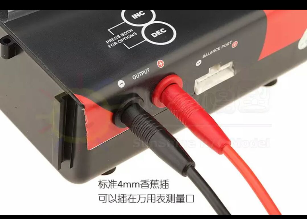

:( Received the PL8 , and find its balance port is small . Smaller than the connectors we usually have on the battery side .
Why not conform ! It's pointless . :cry:
Posts: 4568
Postby shirley_hkg » 23 Dec 2016, 03:29
And reversed pin order too !
Posts: 4568
