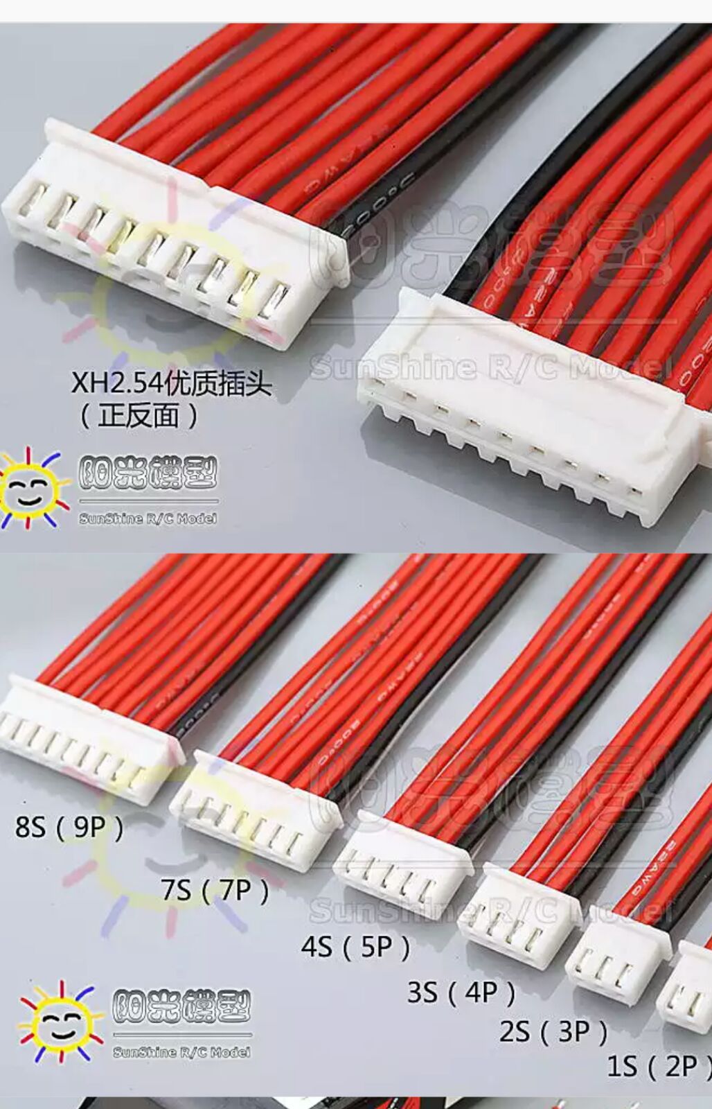

:( Received the PL8 , and find its balance port is small . Smaller than the connectors we usually have on the battery side .
Why not conform ! It's pointless . :cry:
Postby shirley_hkg » 23 Dec 2016, 03:29
And reversed pin order too !
