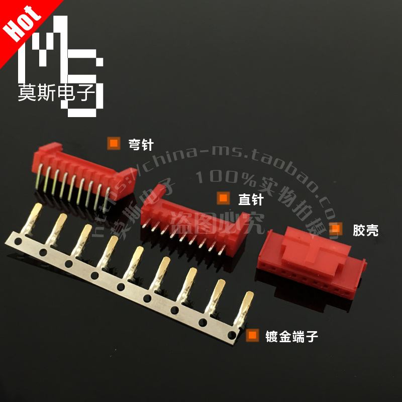

Looking for the balance connector . Just want to be sure of the right one . :P
BM , would you please post a close up shot of it ?
These are gold-plated tips .

shirley_hkg wrote: :( Received the PL8 , and find its balance port is small . Smaller than the connectors we usually have on the battery side .
Why not conform ! It's pointless . :cry:
Didn't you order a couple of spare 36" extension leads when you placed the order? The PL8 uses the JST-PA type of plug for the balancing port. I believe there's an adaptor board that you can buy to be able to use JST-XH plug.

Postby shirley_hkg » 24 Dec 2016, 03:10

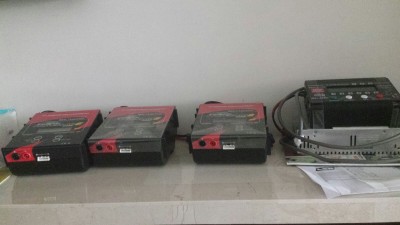

Ours are refurbised models and came in naked .
Would anyone please post a close up shot of this JST-PA 2.0 connector ?
8-)
Postby Burgerman » 24 Dec 2016, 09:23
Cellpro (JST PA) PowerLab 36" Extension Cable http://www.store.revolectrix.com/Produc ... sion-Cable
I usually order a few of these. Cut off the other end to suit charge connector etc.
8-)

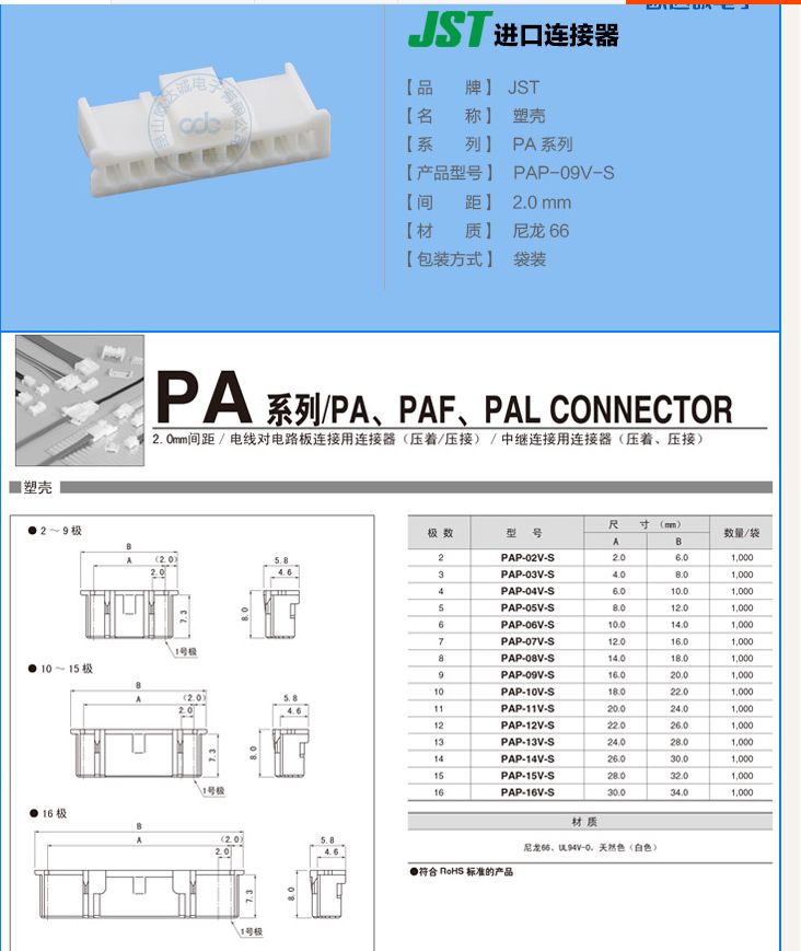

Postby shirley_hkg » 26 Dec 2016, 04:19
Burgerman wrote:It would never end.
Shirley http://uk.rs-online.com/web/p/pcb-conne ... s/4766833/ correct part
Found it . Thanks John . :)

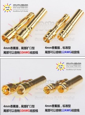

Postby shirley_hkg » 26 Dec 2016, 04:29
Also found these 4mm banana plugs , with enlarged end , that can accommodate thicked charge wire up to 10awg . :D :D :lol:
Postby Burgerman » 26 Dec 2016, 10:45
Buy the ones that are protected that cellpro recommend. Those are good quality, and more importantly are the only ones that barely get warm at 40A output I ever found. And being stackable helps! I have the ones you are looking at with smaller wire end, they get hot at 20A. Its the gold plated part that doesn't end up tight enough or long enough. If you try more Amps, the charger will probably melt...
Cellpro style ones are very similar (or the same?) as the link below, they have a longer mating surface than the rest for less resistance/heat. .
These are rated 32A at high voltages, and some similar makes are rated 36A but both are good for 40A at the voltages we use. I buy them in bags of 20 in red, or black, on ebay.
http://www.ebay.co.uk/itm/4mm-Banana-Sh ... 1c5886402c
And
http://www.ebay.co.uk/itm/Red-Black-12A ... -Go0MEbudg

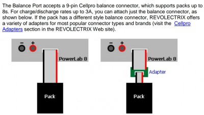

Postby shirley_hkg » 28 Dec 2016, 02:44
Burgerman wrote:I still have 3 here. In the hobby world things keep moving on though. People always want more/better/faster. One of the things that makes the PL8 fast is the 1A balance power. And the fact that it begins balancing lipo packs from any voltage. So they end fast, and you are back in the air. Even on LiFe packs, it helps to balance faster, and esp on big packs like we use. So 1A instead of 300mA and start sooner. But not lower than 3.4V.
If charge through the balance leads only , PL8 can deliver 3A max .
Can we interprete in a way that it can balance in 3A in this mode ?
That will be very helpful wih initial balance when building packs .
Postby Burgerman » 28 Dec 2016, 03:42
No charge 3, (if wiring set to FMA mode) balance still 1A. But its still fast as it can be set to begin balance at 3.3, 3.4, 3.5, or just at CV. And proportional, as well as the old digital on/off way used by most chargers.
Stock presets will trigger an error - safety charge - if cell imbalance exceeds 250mV. But if you use one of my presets, that will be 350mV (or disabled) so will never bother you.
