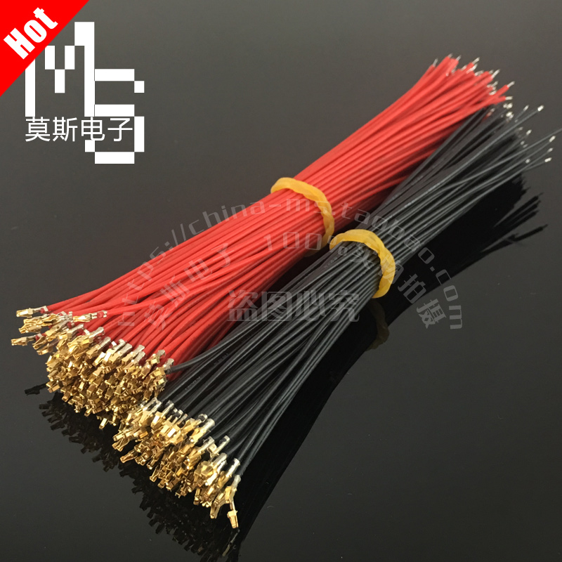

Looking for the balance connector . Just want to be sure of the right one . :P
BM , would you please post a close up shot of it ?
These are gold-plated tips .
8-)

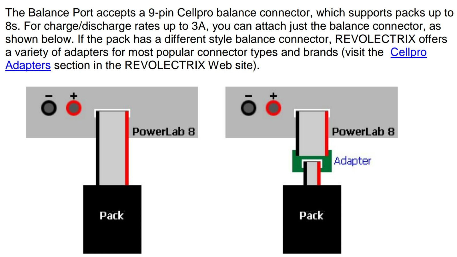

shirley_hkg wrote: :( Received the PL8 , and find its balance port is small . Smaller than the connectors we usually have on the battery side .
Why not conform ! It's pointless . :cry:
Didn't you order a couple of spare 36" extension leads when you placed the order? The PL8 uses the JST-PA type of plug for the balancing port. I believe there's an adaptor board that you can buy to be able to use JST-XH plug.

Also they lock. But another reason is that you can choose 2 wiring schemes. It can charge at 3A and balance down the balance wires. FMA wiring. I use this all the time on hobby stuff. Prevents accidentally plugging in the wrong wiring scheme. But it is a pain.

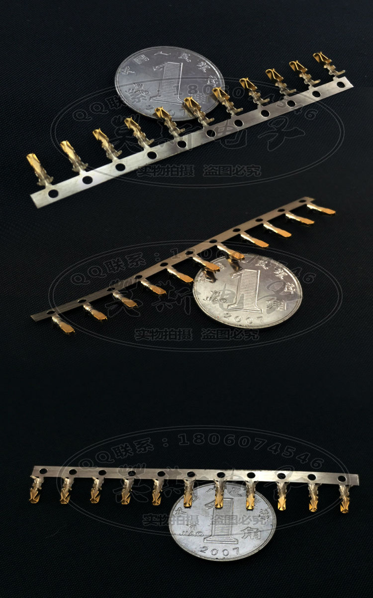

Postby shirley_hkg » 24 Dec 2016, 03:10
Ours are refurbised models and came in naked .
Would anyone please post a close up shot of this JST-PA 2.0 connector ?
8-)
Postby Burgerman » 24 Dec 2016, 09:23
Cellpro (JST PA) PowerLab 36" Extension Cable http://www.store.revolectrix.com/Produc ... sion-Cable
I usually order a few of these. Cut off the other end to suit charge connector etc.

Postby shirley_hkg » 26 Dec 2016, 04:19
Burgerman wrote:It would never end.
Shirley http://uk.rs-online.com/web/p/pcb-conne ... s/4766833/ correct part
Found it . Thanks John . :)

If charge through the balance leads only , PL8 can deliver 3A max .
Can we interprete in a way that it can balance in 3A in this mode ?
That will be very helpful wih initial balance when building packs .
Postby Burgerman » 28 Dec 2016, 03:42
No charge 3, (if wiring set to FMA mode) balance still 1A. But its still fast as it can be set to begin balance at 3.3, 3.4, 3.5, or just at CV. And proportional, as well as the old digital on/off way used by most chargers.
Stock presets will trigger an error - safety charge - if cell imbalance exceeds 250mV. But if you use one of my presets, that will be 350mV (or disabled) so will never bother you.
