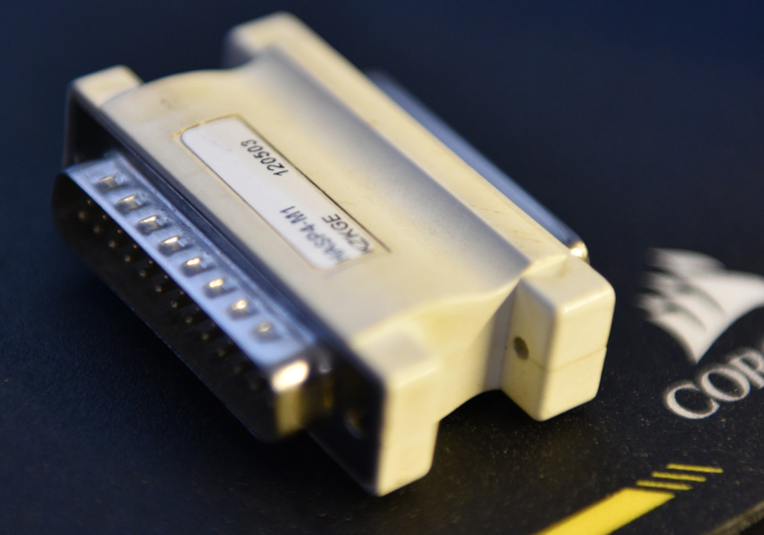

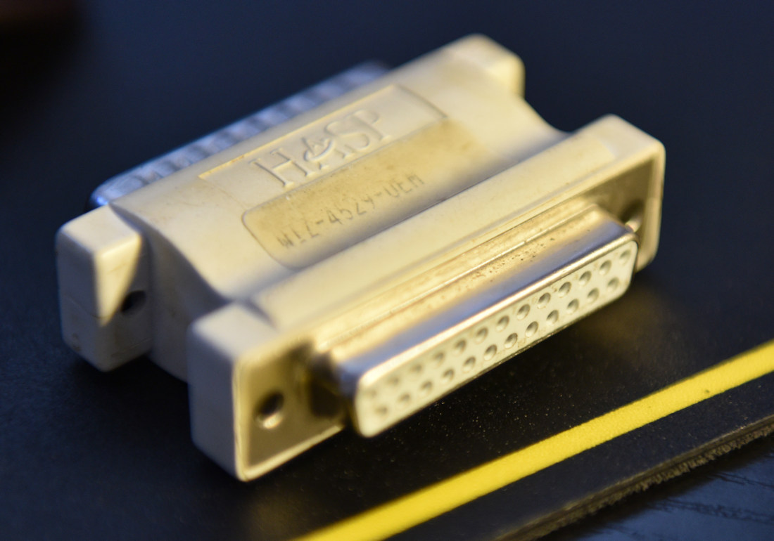

Just found an old parallel port dongle for Dynamic. Will this still work with the latest stuff today?
I realise I will need some way of connecting it to a machine with no parallel port... Is there one? Is it this easy? What about connecting to the chair (DX2 for eg).

Could you please post a pic .
Postby Burgerman » 21 Dec 2016, 16:33
Posts: 71102
Postby Burgerman » 21 Dec 2016, 16:34
Needs a clean!
Found in a box of old stuff. But from what I remember its an old OEM dongle.

Even an old dongle will still work. You also will need the appropriate programming cable to either mate to the separate programming port on some controllers, or with an adapter, to the charger port on some others. It can be RS232 or, with another adapter, USB. Probably the easiest way to go is to find an old laptop with RS232 and Centronics ports. Used just for Dynamic software, even old, and crappy, Windows OS will be fine.

This will give you the output, USB to parallel https://www.jaycar.com.au/usb-to-parall ... e/p/XC4847

Oh...its just the key, you dont even need that any more ;)

The STANDARD Dynamic Wizard program uses HASP encryption and looks for a Dongle .... if one isn't present it will not allow communication to take place and thus you cannot then program the controller/pod.
