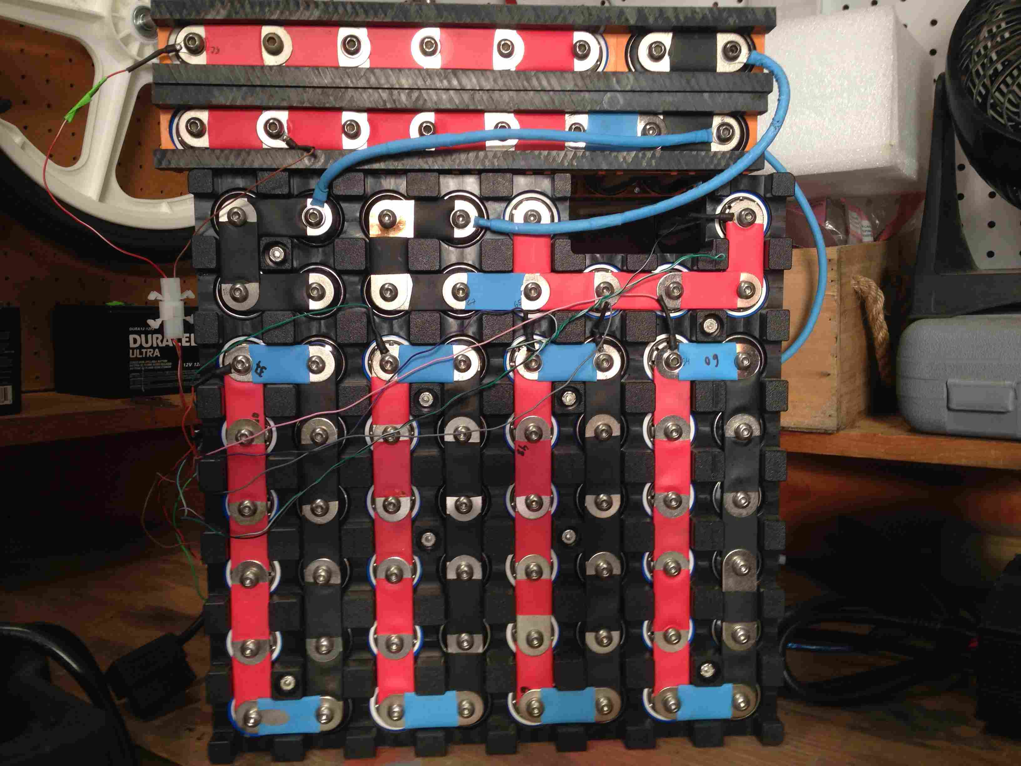

Got someone to take pictures for me
If you look at the top row where there are 6 negative cells. Going from right to left, the voltages are .8v, 1.4v, 2v, 3.4v, 3.4v, 3.4v
The charger is a Roboteq and I didnot disassemble the pack before trying to charge a single cell

Postby Burgerman » 31 Dec 2016, 23:03
I cant follow that. Theres balance wires all over the place. Looks like some wont get balanced?
Worse. You have protective large sized heat shrink crushed under bolt heads, and between bus bars on many many places. Those will almost all be bad connections. I would be surprised if a 1/4 of those cells or more are not actually disconnected from the pck. You will have endless issues and balance problems. Theres no way that pack was ever charged or balanced correctly. You need to get rid of all of that trapped heat shrink before you begin. And clean all contacts, and go over every connection about 4 or 5 times o0n reassembly as its easy to find ones you missed. Or you will have much worse problems. And balance wires seem very long, too thin, and fragile. Every cell needs to be removed, tested for capacity, and reassembled with much more care.
IF they were electrically connected they will all read exactly the same. Anything else isn't possible. You have all that plastic heat shrink in the way on the bus bars, so most of the cells are disconnected! They only LOOK connected... These .8v, 1.4v, 2v are therefore not... You cannot build a pack this way. And you cannot build a chair this way. Much better understanding and accuracy of build is essential.
This sort of thing causes huge problems with one loose bolt! Its why you cannot 'get one built' and need to take charge and DIY.
That must be disassembled, and any cell less than 3.3v tested properly. Cleaned up properly, reassembled with care. And non of that heat shrink unless you are extremely careful to get non of it between bus bars, on top of cells, under screw heads etc. And loctited as you go.

Postby flagman1776 » 01 Jan 2017, 01:38
I immediately began wondering about faulty connections... which I believe is Burgerman's first concern. After you tested each parrallel cell group, I'd start at each end to check series. If you find a break in the series from opposite ends... that'll be your bad connection.

Postby Burgerman » 01 Jan 2017, 02:16
THOSE for a start, are supposedly connected in parallel! Or rather they are not... Because that isn't actually possible. The first three at least are DISCONNECTED from the rest electrically. Looking at the pack, I expect the rest is about as good. You cannot work like that. These things must be assembled right and with care! I suspect there are many such bad connections and cells disconnected, or disconnected from balance etc simply by looking at the pictures.
The whole pack must now be disassembled, each cell tested individually fully charged, tested for capacity while completely disconnected from all else, reassembled properly and any failed or substantially different Ah reading cells replaced. And all of that heat shrink removed totally before reassembly.
I suspect you are going to need to find someone that understands electrics and electronics well, and that has a much higher standard of build capability/quality to help you finish this chair. Or it will never be finished or reliable, and will just keep costing you money. And may end up either a fire hazard or a danger in use to you at best. (I am thinking about the roboteq wiring issues you were having here too). You have no choice but to do these things correctly. This is a complex job, everything has to be 101% right to stand any chance of success.
For eg, You *must* see cell balance as accurate and close as this both during and at full charge to know all those connections and cells are correct. http://www.wheelchairdriver.com/BM3-con ... arging.gif

Postby steves1977uk » 01 Jan 2017, 15:21
That pack looks like it was built by someone who doesn't understand how to build a lithium pack, half of those cells are probably knackered :(
Re: Battery Pack Issue
Postby steves1977uk » 01 Jan 2017, 15:35
Also now counted 15 balance wire connections? For a 13S pack there should be 14 balance wires.

Postby flagman1776 » 01 Jan 2017, 19:09
I had to save & enlarge the photos to examine closely.
I'm seeing (8) bottom stacks of 6P as well as the 2 top horrizontal rows of 6P. There appears to be a U shaped 1 P group of 6 between the top rows & the bottom stacks... (picture 1 to Left) but to the right there appear to be (2) P groups of 4, cable connected to 2 more P cells on the end of the top rows. It's very confusing. I don't know how the cabling connections will affect those P groupings.
The red shrink must be pos, the black neg, the blue + to - jumpers.
Again, I'm agreeing with Burgerman that the nice looking heat shrink may be interfereing with the proper tensioning of the bolts, thus poor connections. I would cut away enough heat shrink that there was NONE between the metal to metal parts.
Other thing to consider is if the stepping of connector bars is interferiing with best contact. EVERY cell in a Parrel group should read the same. If you had a bad cell, it would drain them all, equally. If they are not, then there's connection problems.
I would try to remove the excess shrink tubing with a razor blade. It is insulating... None between metal parts! A lot of connections to check but who ever does it just has to start & be systematic.
The pack does not need to be physically disassembled necessarily... there's time for that if defective cells are identified... With the connectors removed, individual cells can be charged.

Postby Burgerman » 01 Jan 2017, 20:14
Heres what you need to do. In this order.
1. Remove every bolt, every bus bar, and all the wires.
2. Voltage test every cell individually. Discard any that are 2V or less as a matter of course.
3. Charge up all of the rest fully, holding each of them at 3.600V for at least 1 hour.
4. Discharge EACH at 10A down to 2.500V and write the Ah capacity removed on each cell as determined by the charger.
5. Recharge all (as 3 above.)
6. Discard any cell that is more than 3 to 5% less Ah capacity than the best cell.
7. Add new cells as required. And fully charge each one individually. (as 3 above.)
8. Dont refit any bars, wires or anything for a month.
9. Recharge every cell individually, after a month to test for a faulty cell with high self discharge. This will be very quick, a few mA only. If any are much more discharged than the rest, discard and replace. Write down the mAh figure on each.
10. REFIT all the bus bars without that heat shrink in the way... Clean the end of every cell, and the bars with fine wet/dry or that green scotch-bright cloth. Use loctite on every bolt. Be sure each is tight! And check all several times over as its easy to miss one and it causes havoc.
11. CHECK loom, use shorter cables, no crimp alone, solder properly. And then re-fit.
12. Charge fully as a pack, and post graph so we can see its correct.
Nothing else will work.
